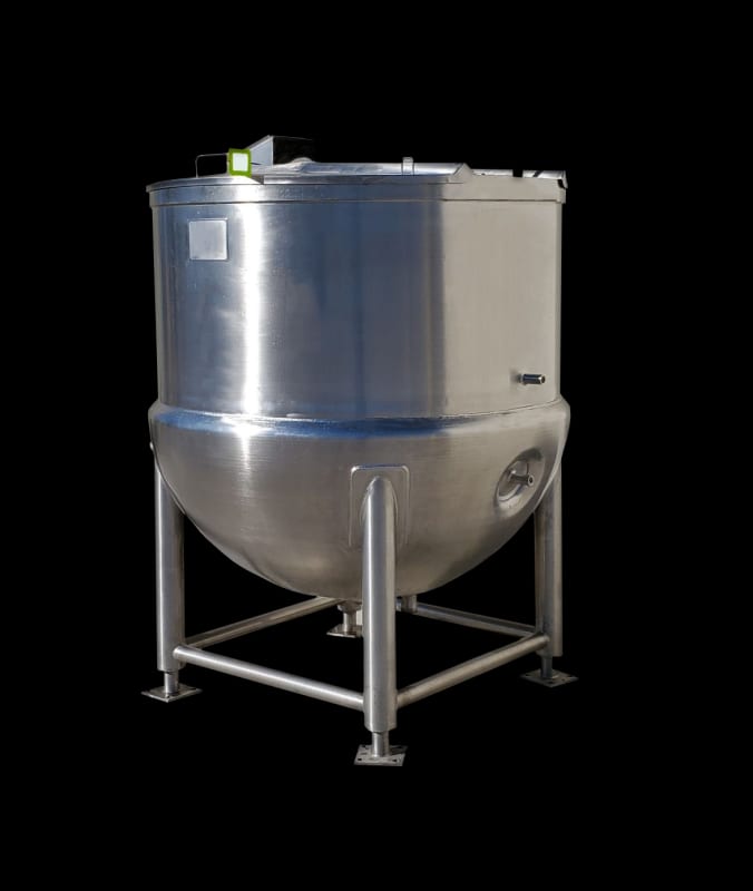

Hello everyone, I am working on a Kettle tank with inside Steam coils. Is there any specific code for the design of the kettle tank or API 620 will work? Also, I need guidance for the tank inside steam coils design.
Please submit drawings or sketches ... Your use of the vague term "kettle tank" can mean many things to many people.

dear: here! A picture for your reference.
The picture you have posted implies INDUSTRIAL STEAM PRESSURE COOKER and if so, the relevant standard is PV code applicable in your region. Do not forget to provide PSV to limit the internal pressure .
EDIT: Make sure to provide steam horn , whistle with handle.

Thank You for your input. I think I might be able to expedite the design using PV codes. Also, PSVs will be used for pressure limiting in the Kettle Tank.
