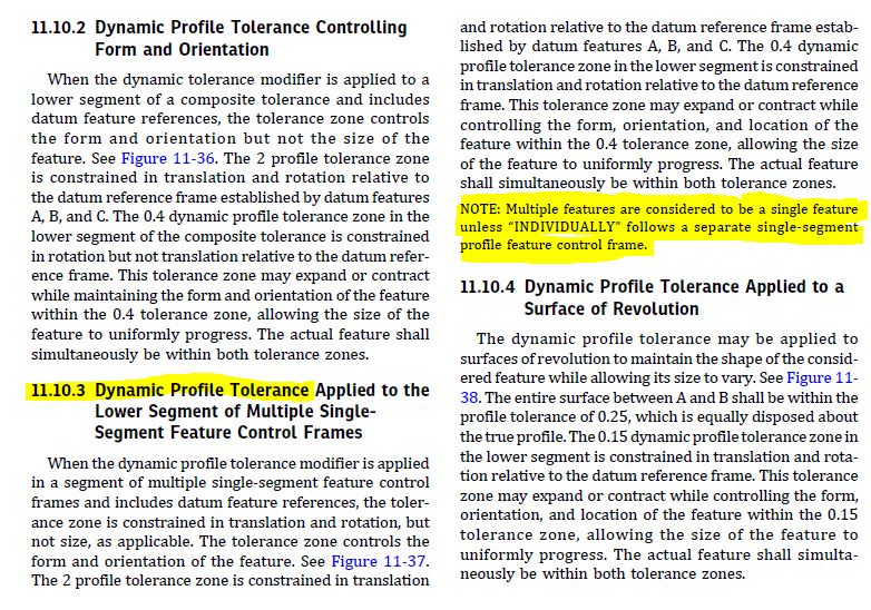

I was about to post a link to this older thread as I remembered someone discussing a "slack" tolerance on here some time ago, however I realized that it was you who also posed that question. Scanning through that thread JP's reply jumped out to me especially since theres been much talk about the dynamic profile modifier lately, as it has now been implemented in Y14.5-2018.
I was about to say that it wasn't clear dynamic profile would provide the control you desire, however I noticed this little note at the end of the dynamic profile tolerance section for MSS (11.10.3) stating "NOTE: Multiple features are considered to be a single feature unless 'INDIVIDUALLY' follows a separate single-segment profile feature control frame." At first blush, I would interpret this to mean that the intent is that the tolerance zones progress together UOS by "INDIVIDUALLY". Unfortunately, I think breaking this requirement with "INDIVIDUALLY" brings up some other issues, which is another can of worms.
This essentially is what you are asking for I think, with the added constraint of form that a profile tolerance will provide vs. directly toleranced size. You might also have some inspection considerations as well, as has been mentioned in some recent threads (ie: likely requires CMM to inspect, the CMM software must be able to handle it, etc..).
Anyone have any thoughts on that note in Y14.5-2018 para 11.10.3? I'm interested in other viewpoints.

drawoh,
I'm well acquainted with the dynamic profile modifier in Y14.5-2018 hence why I pointed it out and referenced the new standard. I know it wasn't in 2009, it is a new introduction for 2018.
See below for the section of Y14.5-2018 para 11.10.3 titled "Dynamic Profile Tolerance Applied to the Lower Segment of Multiple Single-Segment Feature Control Frames". I initially thought it wasn't clear it would do what OP asked, but then I read this note and it seems to suggest dynamic profile tolerance zones for multiple features tied together with some sort of pattern creation mechanism would indeed progress (expand/contract) simultaneously.
chez311,
The OP wants to control variation of hole size. He does not care (much) what the size is, but they must all be the same. Dynamic profile controls the size accurately to the numbers I specify. That is not what the OP asked for.

It looks like I can maintain an accurate but sloppily located complex feature. I can choose whether or not to control rotation by leaving out datums.
Dynamic profile releases the constraint of size of a standard profile tolerance by allowing the tolerance zone to progress uniformly (expand/contract), but maintains the form tolerance requirements. The note I pointed out above seems to suggest that multiple features tied together with a pattern mechanism (ie: "nX" or "n COAXIAL HOLES") and a dynamic profile tolerance would also progress (expand/contract) simultaneously as if they were part of a single yet discontinuous feature. This would seem to satisfy OP's requirements. At least thats how I read it.
chez311,
Wouldn't this also control spacing between the features?
pmarc,
Do you mean location between the true profiles of the features in the pattern? If so then yes. Or do you mean something else?
pmarc,
Do you see that as an issue or contradictory to the note? Also do you read the note in the same way that I do?
Yes, I read the note in the same way that you do. But because the dynamic profile tolerance without datums and with no INDIVIDUALLY added will also control spacing within the pattern, then I don't think this is the solution OP is looking for.

Good point - and if INDIVIDUALLY is added, the way I read it the simultaneous progression would be broken as well so thats not what OP wants either.
I guess it could be used with the understanding that the location of the holes would be held tightly to within the form requirement dictated by the dynamic profile tolerance. And that size/form variations of one hole in the pattern would affect the position of that hole and others - for example if you had a 0.1 dynamic profile tolerance and you had one hole that came out to 25.1 and another to 24.9 they would BOTH be required to have perfect location.
Seems like it could be an overly tight requirement. In light of that and other reasons, I would probably recommend going with a note if one desired the behavior described by OP.
Yes, a note or a hybrid solution (dynamic profile FCF with a supplementary note worded such that the spacing requirement is cancelled) could probably work provided the intent is to control variation between MMB and LMB of the holes in the pattern. But if, for example, the design intent is to control variation of hole sizes understood as UAME sizes, then the dynamic profile approach may not work at all.

Interesting thread. Overall, I would say that the OP's requirement for "consistency of hole size" would best be specified in the form of a note. I had initially thought that Dynamic Profile might work, but there are too many unresolved issues in Y14.5's definitions for tolerances applied to multi-feature sets. This makes it very difficult to keep the "equal progression" aspect of multiple dynamic profile zones while turning off the default "mutual orientation and location" aspect.
chez311,
Don't get me started on the note in 11.10.3 ;^). The note just kind of comes out of nowhere, and imposes a special rule for one particular case (dynamic profile in a single-segment FCF). This is the type of thing that causes major headaches in Y14.5.1 when we try to write concise rules and mathematical definitions for Y14.5 characteristics. The note also creates direct conflicts with other Y14.5 content (the fact that the All Around symbol creates a pattern and not a single feature, and that the Continuous Feature <CF> tool is available for treating multiple surfaces as a single feature). I wish that the note had not been included.
