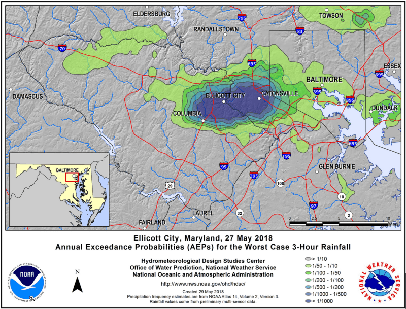

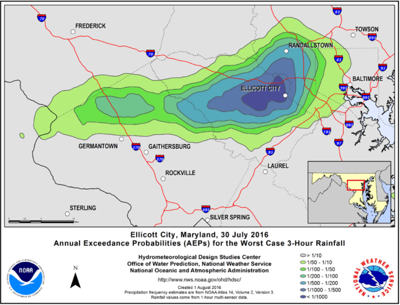

interesting tidbit for those who question the “1-percent AEP flood” criteria
[URL unfurl="true" said:
https://pubs.usgs.gov/gip/106/pdf/100-year-flood-handout-042610.pdf[/URL]]The 1-percent AEP flood has a 1-percent chance of occurring in any given year; however, during the span of a 30-year mortgage, a home in the 1-percent AEP (100-year) floodplain has a 26-percent chance of being flooded at least once during those 30 years! The value of 26 percent is based on probability theory that accounts for each of the 30 years having a 1-percent chance of flooding.
