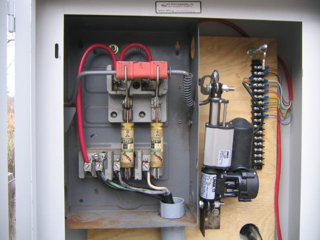

I kept a picture of this shut-off mechanism because of its sheer ingenuity and hard-nosed pragmatism. You may find it a useful inspiration:
Hey MikeL. 24V though a buddy would sure like some for his 48V service.
Spar!! That is... um.. well! Damn. Pragmatism - defined.
Amazing they found a linear actuator that big that short!
NC would require power to keep it open... <shudder>
