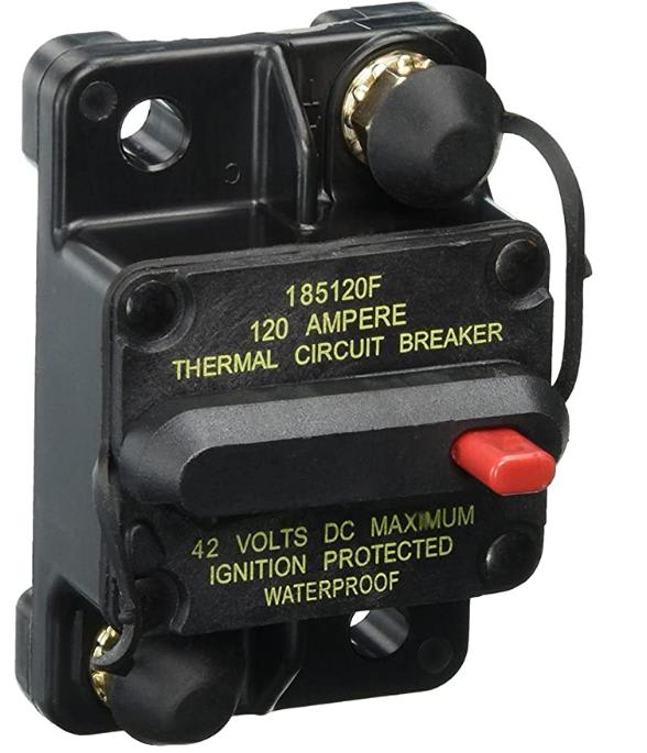

I've started to design something but have come up against a problem I'm hoping one of you mechanical designers can help me with.
The plan was to use this breaker:

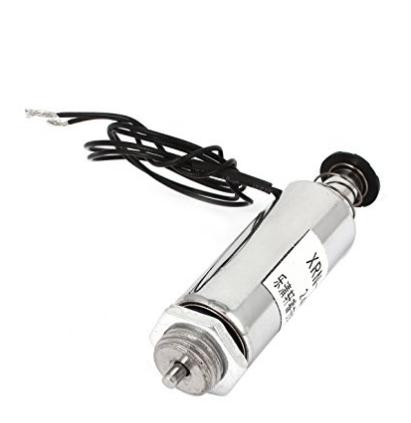

And, for an automated disconnect, poke the disconnect red button with this solenoid.
Turned out the red button takes a lot more force than I recalled. So much that the solenoid seems about 10% short of what it takes.
Bright idea! It's stroke is twice what the red-button distance needs to trip. I'll just swap that excess stroke for greater force using a lever. I'm so smart. DOH! @#%^!@* a lever reverses the direction of motion! Dang it. That would require the solenoid to be oriented down into the circuit breaker and would be too long to even fit...
Me need more force.

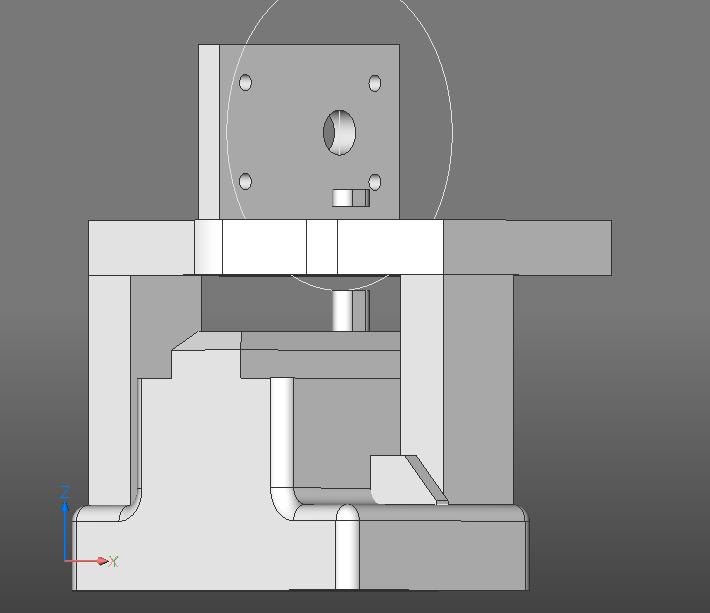

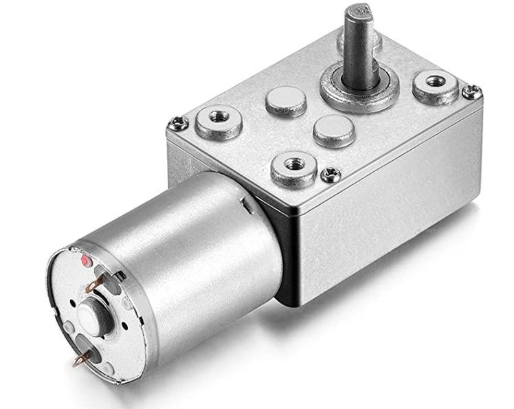

I decided to go with a tiny gear drive motor. Taking a 10,000rpm motor and reducing it to 45rpm, that'll buy you some torque.
So I designed a bolt-on table to go over the breaker holding the gear motor. I'd use a disk with a high spot (cam) on it to rotate around sliding over the red button to push it. Once the lobe comes back up it would hit a micro switch that's in series with the motor killing the motor. To activate, the PLC would shunt the micro switch for long enough to get the lobe off the switch and the cycle would proceed to completion,(same as windshield wipers). If a human walks up they can hit a manual shunt switch that will also start the cycle.
The gear drive goes on the upper wall with the disk/lobe dropping down thru the table top to ride across the red button.
(ignore the button piece above the table it's just a 3D construction aid)
PROBLEM. The geometry is sucking for this method as the disk/lobe will be so large as to cut the table in half destroying the table bridging and all related strength and stiffness. Also, I'm dubious that the sliding disk across the hard-to-push button may not play well.
Today after thinking about it I believe it makes more sense to use a little disk/lobe that all resides above the table-top and bears down on a shaft "push-rod" that carries the vertical force down to poke the red button without any lateral translation at the red button's surface.
It should be spring returned and so sit up until the lobe comes by and presses it down then following the lobe back up.
Is there any OTShelf components like that and if so what are they called?

Seems to me the problem is more readily (and inexpensively, and safely) resolved by using an electronic interrupter, i.e., a relay... going through all of this mechanical whatever seems like going around your elbow to get to your rear.
Dan - Owner
re your first thought - a lever doesn't have to reverse direction: pivot near the end, breaker near the pivot, solenoid further out (both breaker and solenoid on same side of pivot).
Have you check to see if the red button is an interrupter or a reset?
It may be both, but.....
Is it snap action or slow acting?
If it is slow acting, you may end up building a task specific arc machine, the specific task being destroying contacts.
How about mounting the solenoid horizontally and having it pull an inclined plane across the actuating rod?
Or mount the solenoid horizontally and drive a bell crank.

Bill; Yes. I've used these Bussman breakers a couple of dozen times. The red button interrupts and when it does a sluggish lever drops out directly above the "42 Volts". You shove the lever back up into that ridge-body to reset the breaker. When you push the button it contemptuously oozes down and at about 1/2 the stroke distance the lever starts to drop. It stops anywhere you stop pushing the button, giving the amazingly bad impression that the contacts would be separated by only some tiny arc-supporting distance until the lever is fully deployed.
As measured from button top to the flat top of ridge.
0.283" free
0.159" lever starts to drop
0.090" lever fully dropped
To answer I'd call it all-ahead-slow acting.
When you reset it it feels like you'd expect it to when tripping. The lever rises until it's just about fully back up then CLICK! It snaps into place. Amazes me that it sluggishly drops without any feeling of release. Entirely un-breaker like.
I would perceive that either the cam or solenoid methods would be just as fast a human finger because your finger greatly deforms as you press the recalcitrant button.

One warning: levers exchange force with distance. Double the force by doubling the distance.
And solenoids apply maximum force only at the beginning of the stroke. As they extend, the force diminishes (somewhat linearly) until the rod is fully out. The coil can't exert a force on it any more. There's usually a stop before full extension, so that the rod can be pulled back in again.
So your solenoid will need to travel 2x as far to actuate the lever. The force it exerts may be 1/2 as much at that distance. Approximately.

That solenoid as seen above (the one in my possession) is actually what's called a "pull solenoid" though that doesn't make much sense to me. At any rate it pulls the slug into the core so it has maximum force when finally centered with the C-clip end against the body. That happens to extend the pushing tip to its maximum. If I energize it I can then push the red button with the end and get the red button pushed about 80% before the solenoid core pops out the back unseating the slug. So I think that will work for this force-distance wise.

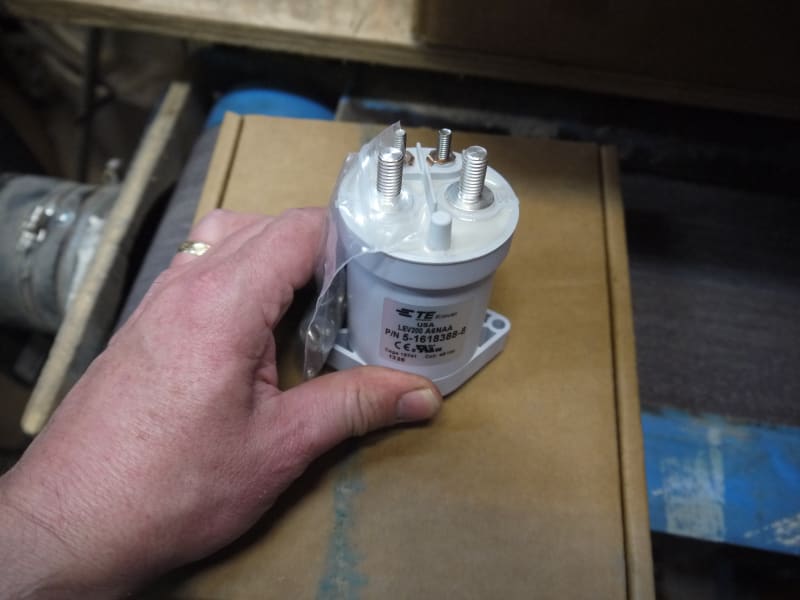

My EV project came with a 48 V coil contactor with a coil economizer arrangement, i.e. it draws less current to hold it in than to pull it in in the first place. The Curtis inverter takes care of driving this coil for me. It also handles pre-charging of the inverter's input capacitors.

Put the cam on a planetary gearbox output and you'll press it without issue.

Hiya Molten! Nice contactor you got there.
I've found that while you'd think vehicle equipment running the same amps as stationary house equipment they could be shared but it doesn't actually work very well.
An example is your contactor. Even with an economizer that relay is a problem. On a vehicle that roars thru 45kWhrs zipping to work and back the economizer relay's consumption is nothing compared to another degree depression of the go-pedal or driving 68MPH for a hundred yards instead or 67MPH. The relay is only engaged the 35 minutes you're driving.
Now comparing that to a stationary solar powered facility that relay is going to be ON 24/7/365 the endless economized power draw becomes ridiculous, demanding extra solar panels and deeper daily discharge cycles.
It's annoying when you find things like your relay then start doing the math and...dang.
