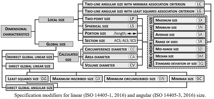

Per the 2017 versiob of ISO 14405-1, its legal to use both modifiers(LP and GX) on the same feature, pls look at the bottom of Table 3 below, and it means Envelope requirement.

Thank you for the table from the ISO standard.
I see that LP and GX is legal to be used on the same feature so that solve the OP question……… probably.
My follow-up question has been if could be used on an external surface (shaft, pin, tab) since GX stands for maximum inscribed association criteria.
Would that be acceptable? Or GX it’s a dedicated modifier for internal features only?
(maybe the same question could be asked if GN “minimum circumscribed association criteria” could be used for the holes or it’s a dedicated modifier for external features only)
I cannot find a definitive answer to my own question(s).
Yes, you are right greenimi, GX is for an internal feature while GN is for an external feature, pls see the snapshot below.
