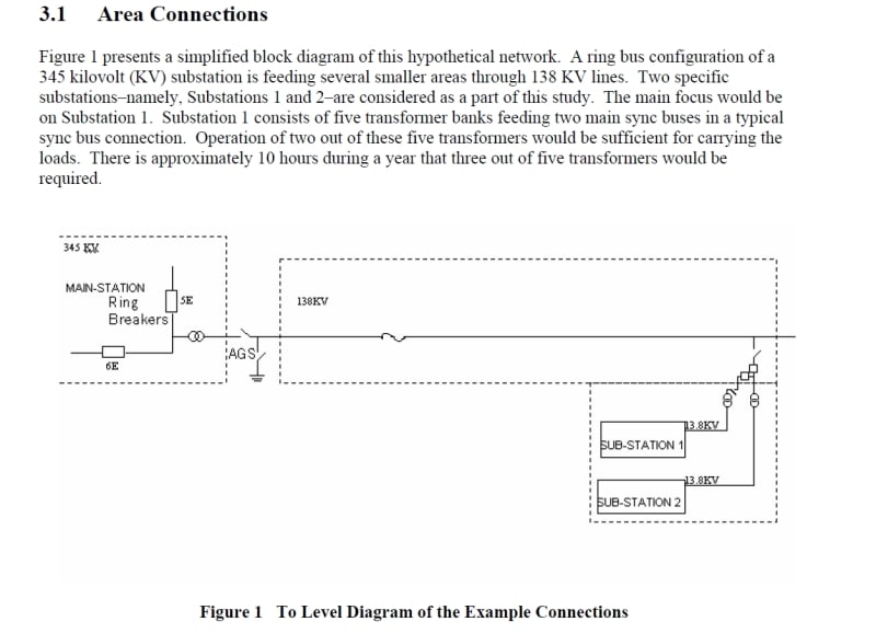

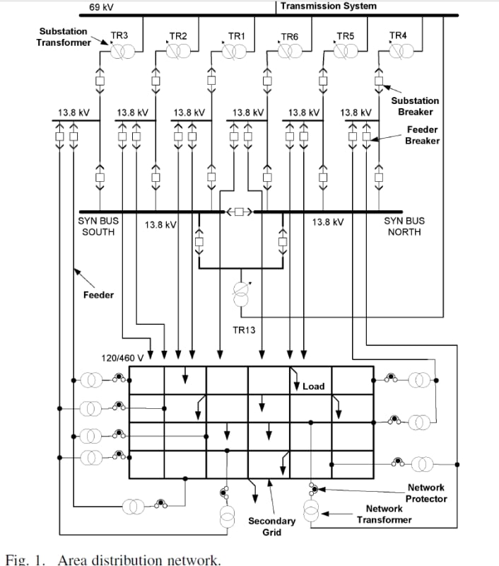

As an example of the typical redundancy in a Con Edison area substation and network, here is how a typical 13.8kv supply substation is configured which should also hold true for 65th st.
I am near 100% certain the substation in figure 1 is East 63rd st (half of it anyway).

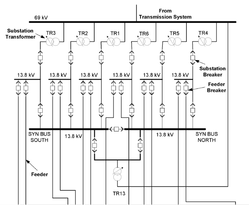

I'd be surprised if there wasn't directional over current on the 13.8kv transformer breaker and synchronous bus breaker as a last resort backup to failed feeder relaying. I mean there really should be. The loss of a transformer and bus section at 63rd would not result in any lost load as all Manhattan networks can handle the loss of two feeders at peak load. It has to be the same for the 65th station. Even if a lost bus section at 65th st removes more then two feeders a network should still be able to survive that considering it was not a high peak demand period before the blackout.

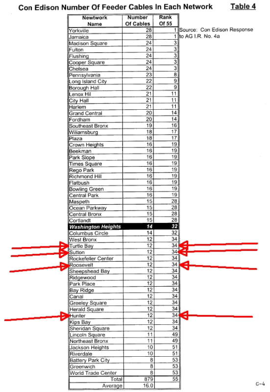

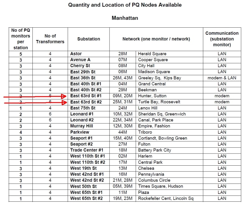

The networks fed by East 63rd st (ignore the first two columns on the left, and make note that they do not refer to the number of transformers at the substation or in the network but rather the number of transformers with PQ monitors)
Hunter, Sutton, Turtle Bay and Roosevelt each have 12 feeders.
7 69kv feeders from Queens Bridge come into East 63rd st. Each 69kv feeder supplies two transformers or 14 in total. 7 supply 13.8kv feeder switchgear in part 1 of East 63rd st while the other 7 supply 13.8kv feeder switchgear in part two of East 63rd st.

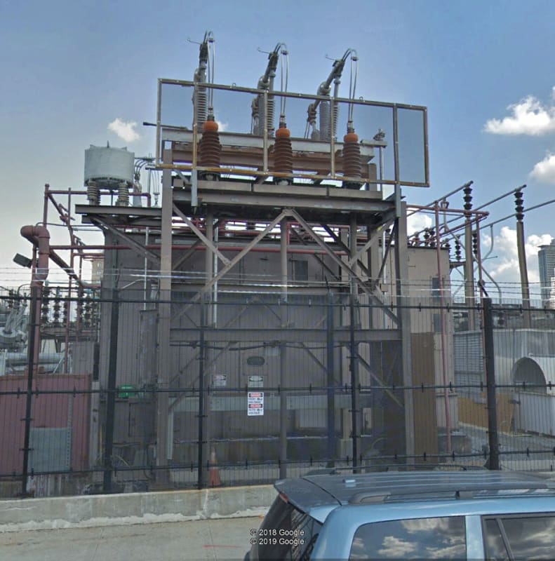

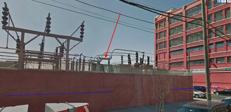

One "part" is shown here:
Each 13.8kv main bus section has at least 4 feeder breakers, two feed one network and two feed another network.
A bus fault or feeder breaker failure results only in the clearing of 4 feeders, or two in each network.
The loss of a 69kv transmission supply feeder results in two transformers de-energizing- or one in each part of the substation.
This again is not problem as the transformer breaker senses the reverse power and opens.
In fact you could loose two 69kv feeds- 4 transformers (two in each part of the station) and not have outages.

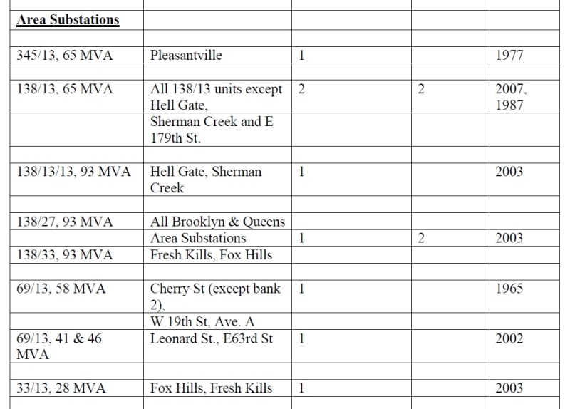

46 MVA x 5 = 230 MVA, or 460 MVA for the whole station.
All in all the design is very redundant and over built.

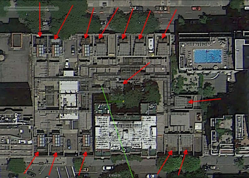

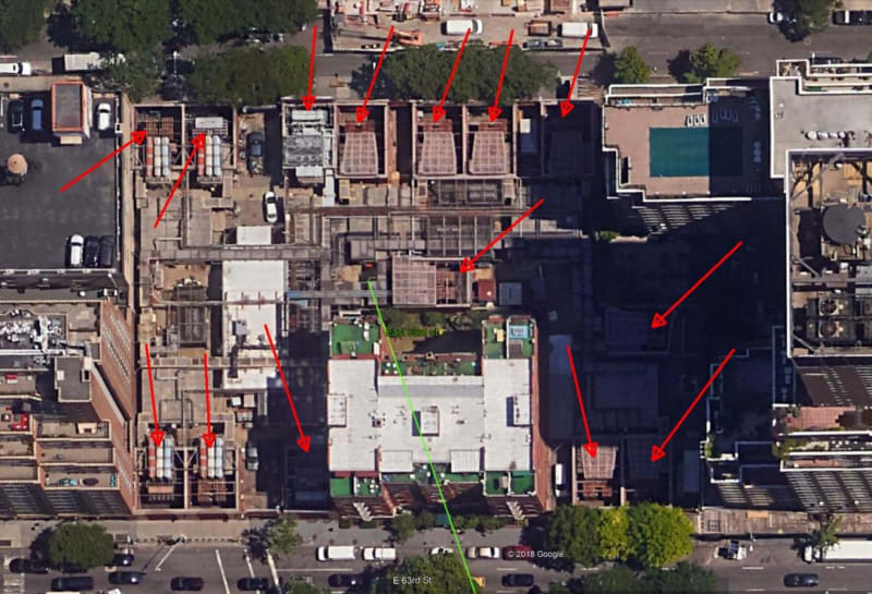

Reason I am using 63rd as an example is because its not far off from most other substations in Manhattan like such as those involved in the blackout.

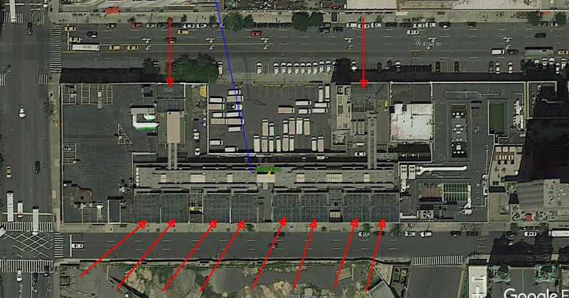

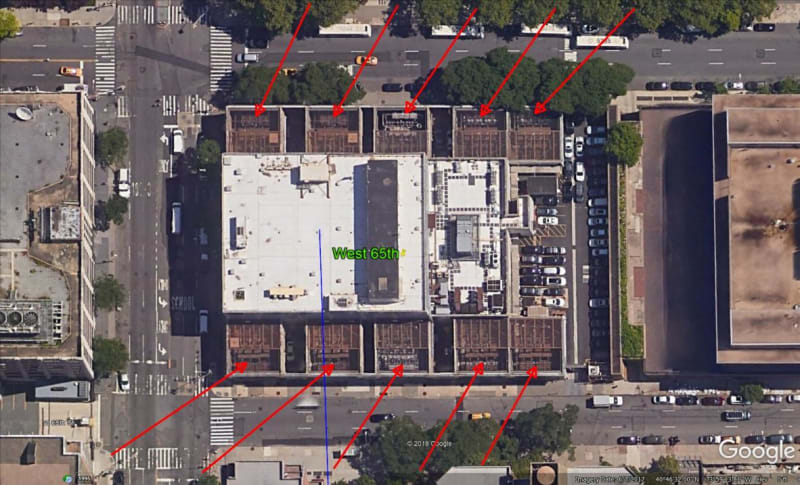

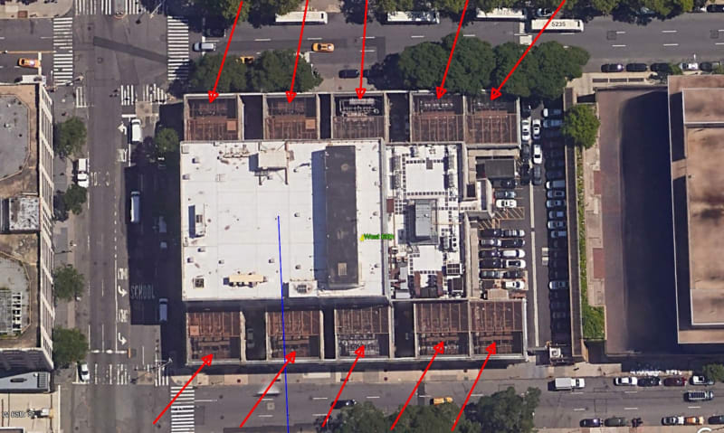

To give you an idea, here are the transformers at 63rd st. The colored "tubes" contain the 69kv feeds to the trafo primary.
14 arrows in total.
Another shot, the tree growing in the middle covers one of them up.
The other grates cover capacitor banks and similar equipment.

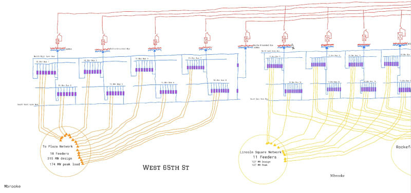

West 65th st involved in the blackout.
10 transformers, two 65MVA transformers per 138kv cable, 5 per section run in parallel.
Same operating principal.
While piecing together the incident, I can confirm that from a hardware perspective the system is indeed designed as a second level contingency system.
Each area station has 5 or 10 65MVA transformers with no more then two sharing a 138kv supply feed.

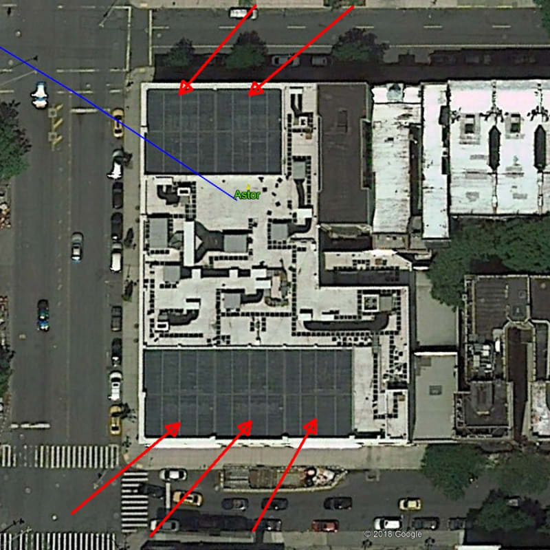

Astor:

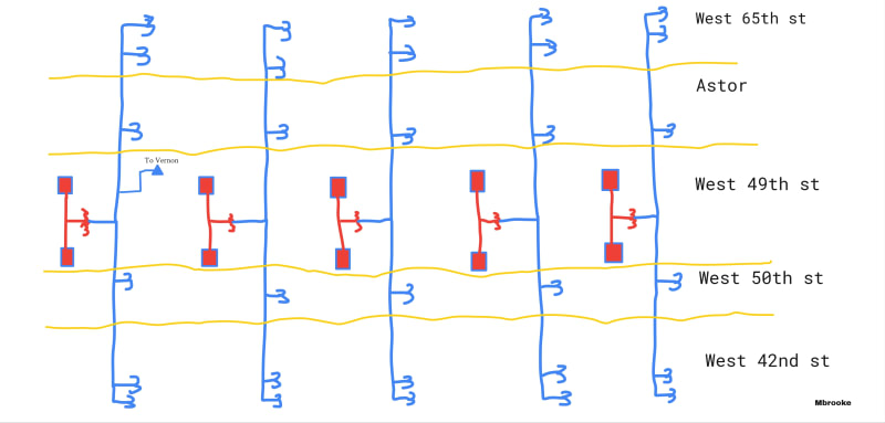

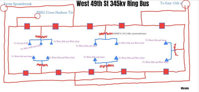

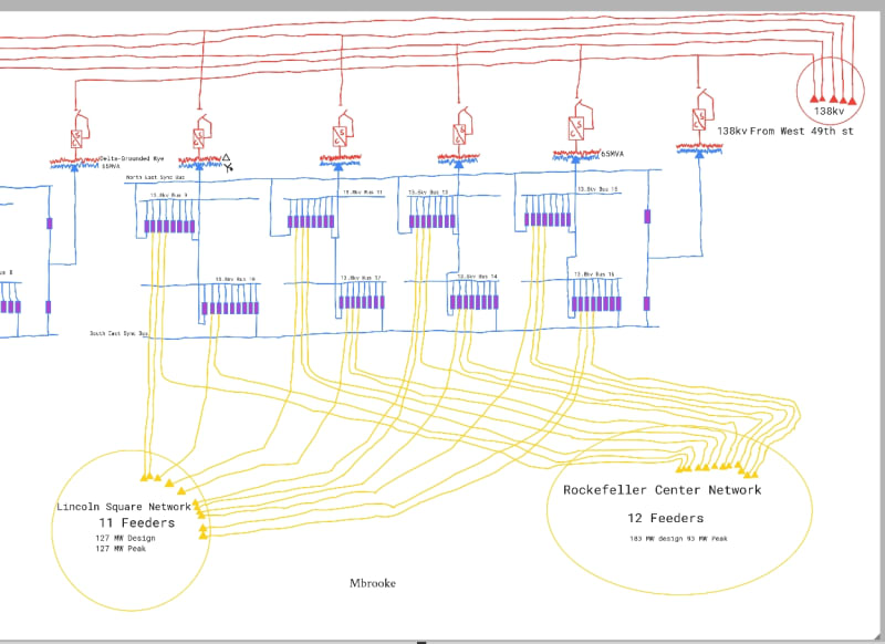

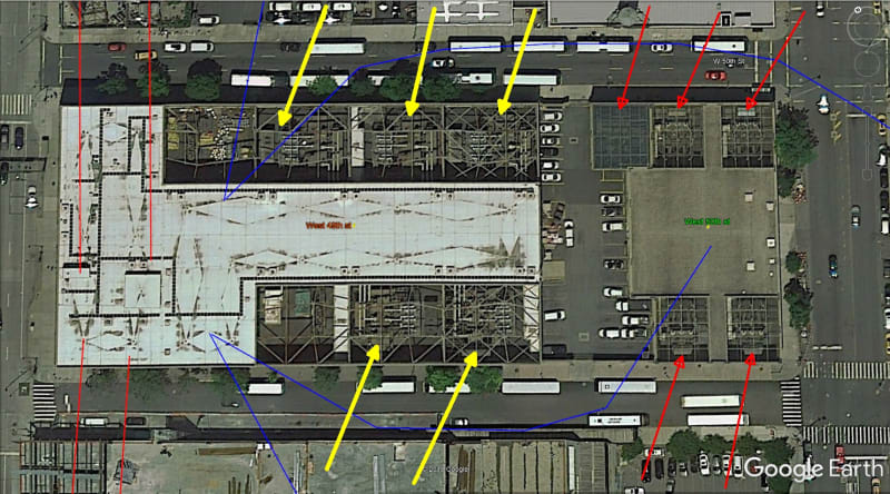

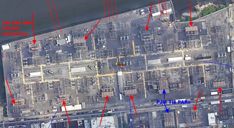

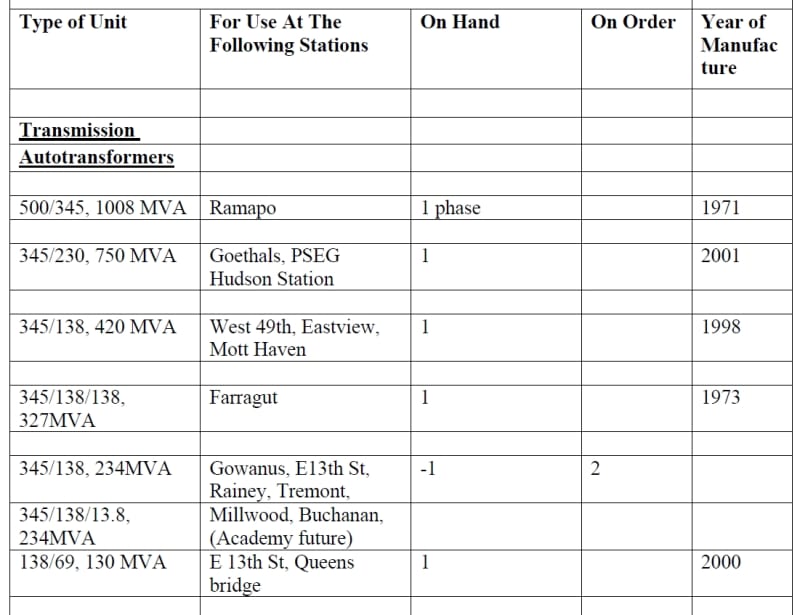

West 49th and West 50th st. Yellow arrows show 420MVA 345kv to 138kv auto transformers also based on a second level factor. Red arrows show 65MVA 138kv to 13.8kv units.
Stations supplied by West 49th autos:
345kv-138kv auto transformer ratings:
138kv-13.8kv transformer ratings:
If any 138-13.8kv transformer needs to be de-energized for an uncleared secondary fault only one 138kv cable is tripped. In the case of Astor it will result in a circuit switcher trip, as for the other 3 stations I am not sure but I'd say a cable trip due to their age (hence no circuit switcher).
A 138kv cable clearing will simply result in one auto transformer and 6 out of 30 138kv-13.8kv transformers being cleared. The remaining 4 autos, 138kv cables and 24 area substation transformers would remain energized and due to their 13.8kv secondaries being in parallel absolutely no network load would be lost.
The assumption above is made that the auto transformers feed the 138kv cables directly with at most a disconnect between them.
Even if the 5 auto transformers feed an elaborate 138kv ring bus at 49th st- the fault clearing topology would still remain the same and thus the outcome. Only the breakers around (for) the 138kv cable requiring de-energizing would open.

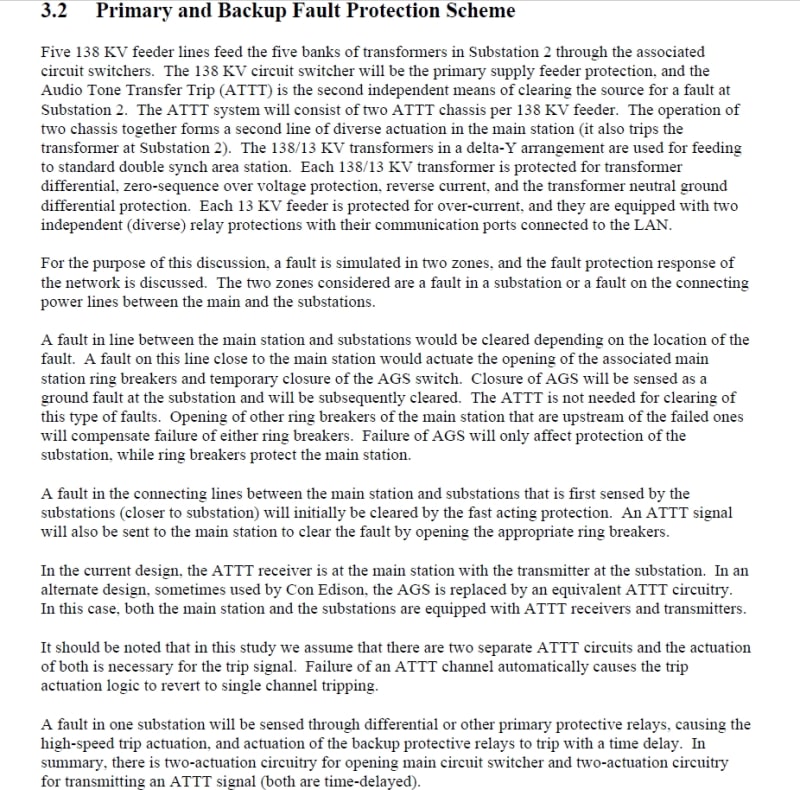

Two papers that may shed more light on the event- or at least a bit on the protection system/philosophy itself.
Interestingly they do not note the 138kv-13.8kv transformers as having over current protection.
And to be clear regrading the "wave" in the 138kv cable I highly doubt thats actually a fuse.

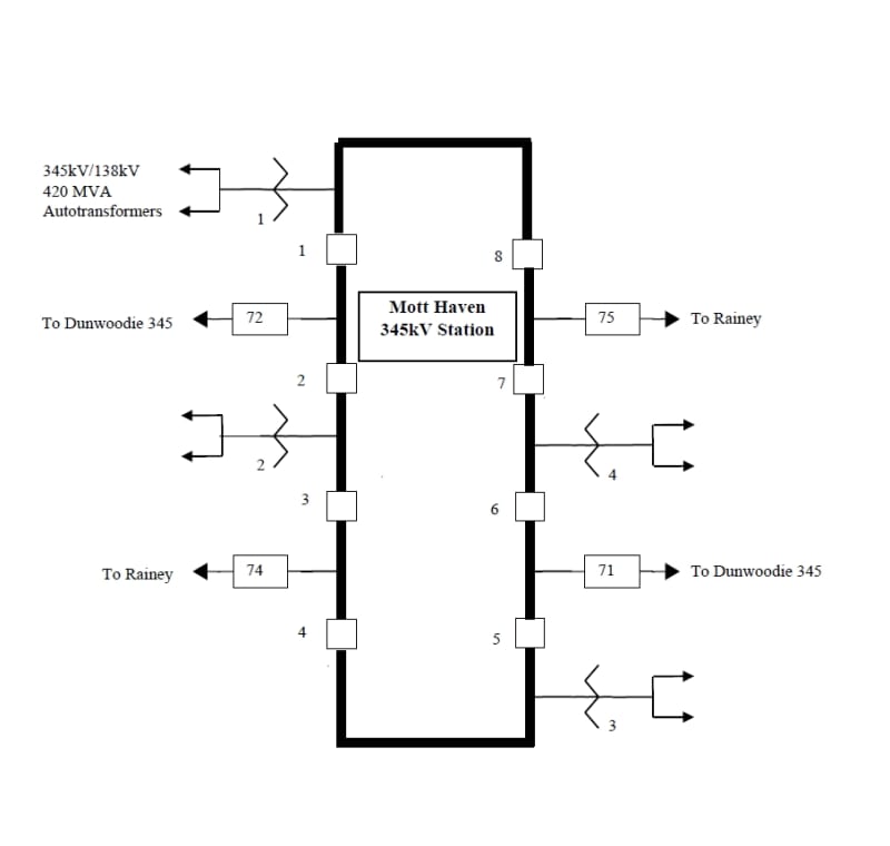

Ie, clearing of all cables in a major 345kv path:
Clearing of two 345kv cables:

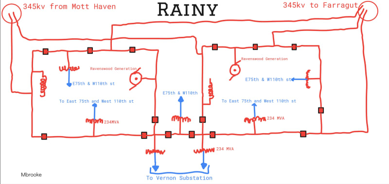

Wanted to make a single line of Farragut to better illustrate it but did not have time. A total area substation trip removes 5 345kv circuits on one side of the station.
Rainy:
Queens Bridge:
Flow paths that can be effected.

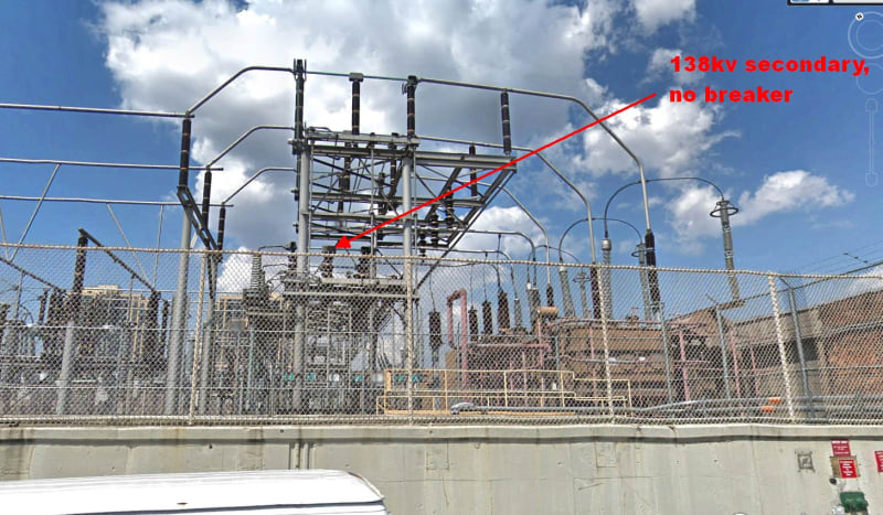

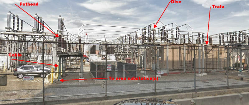

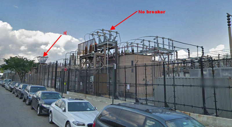

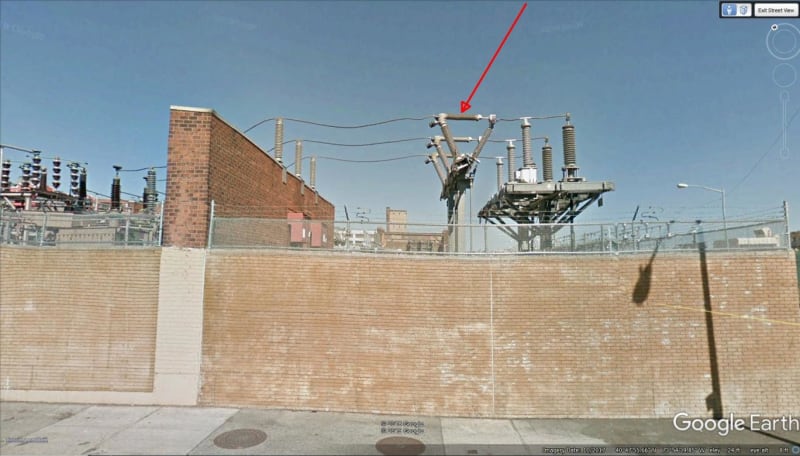

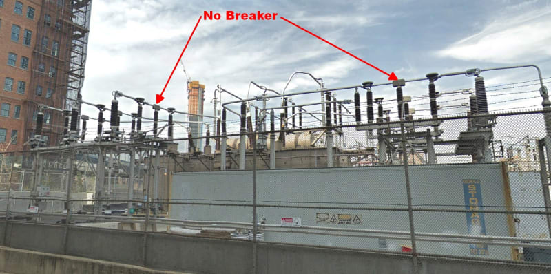

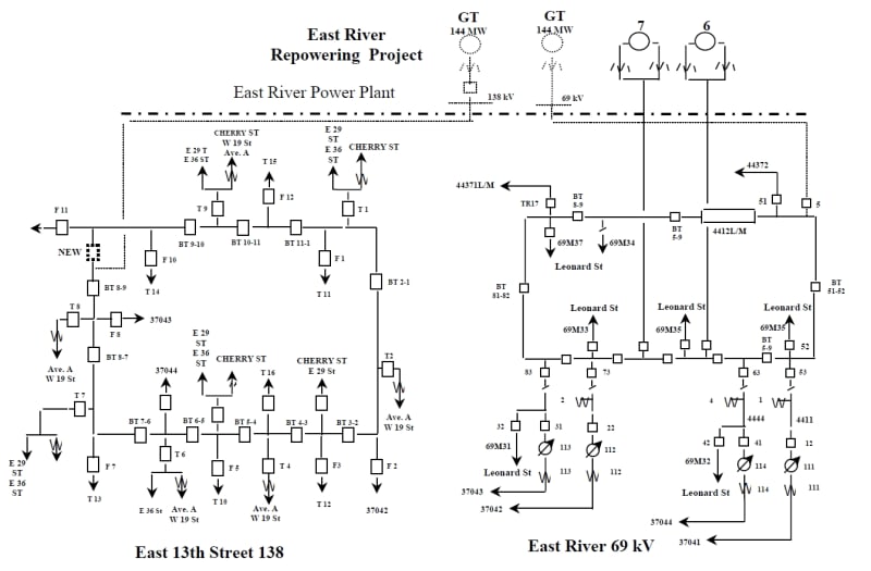

I looked and I see disconnects, the breakers are on the ground. I saw on your one lines from the August 2 post a maintenance scheme. The 6 transformers on the edge feed the load until the one in the middle needs to carry load to perform maintenance on one of the perimeter transformers.
From what I've figured there are no breakers on the ground- the disconnects feed potheads transitioning to underground cables.
East 13th st is one of the few that has breakers on its outgoing area substation feeders, with Astoria West and Vernon for its generators.

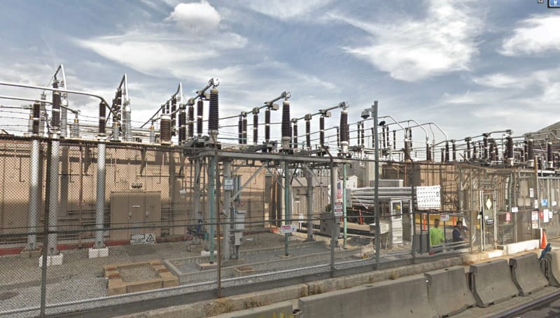

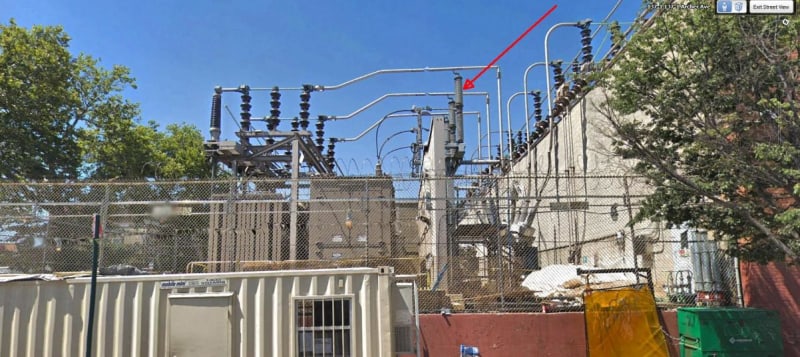

A few more pics of Farragut and Queens Bridge showing the cables heading into the earth:
East 13th st is not a concern for a total transmission outage making an impact beyond directly resulting load loss:

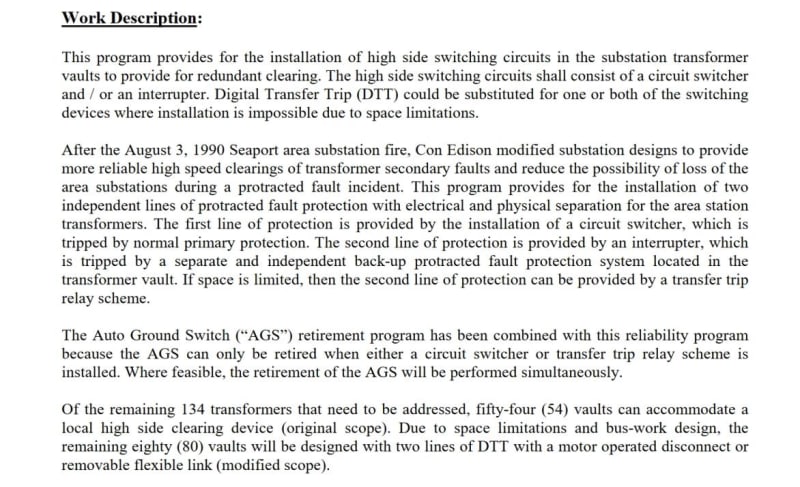

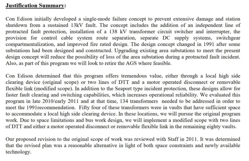

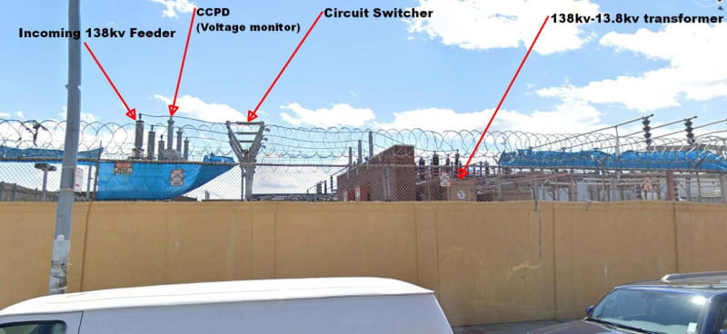

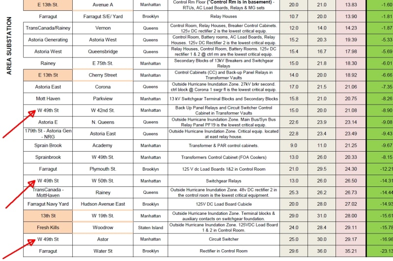

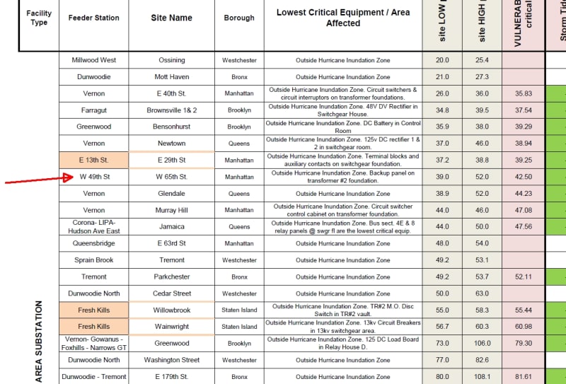

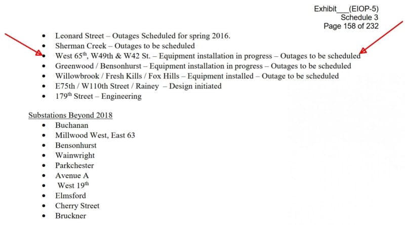

Con Edison had qualms about loosing an entire area substation. At first I was unsure whether or not 65th st had circuit switchers, but after reading through commission filings they should have been in place at the time of the incident.
Looking at Google maps taken in 2017 "substations beyond 2018" already had/have circuit switchers installed:
The event which started the program:

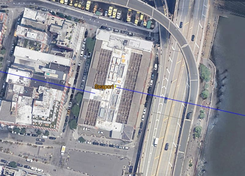

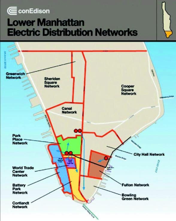

The result of Seaport clearing all 5 138kv feeders also de-energized the Trade Center substation and I would imagine took out 5 345kv feeders at Farragut which would certainly alarm Con Ed / NY-ISO on a hot summers day.
At the time Seaport fed the Fulton network, but Trade Center going down also removed the Park Place network, Battery Park network, World Trade Center network and the Cortlandt network. So outage was substantial.
