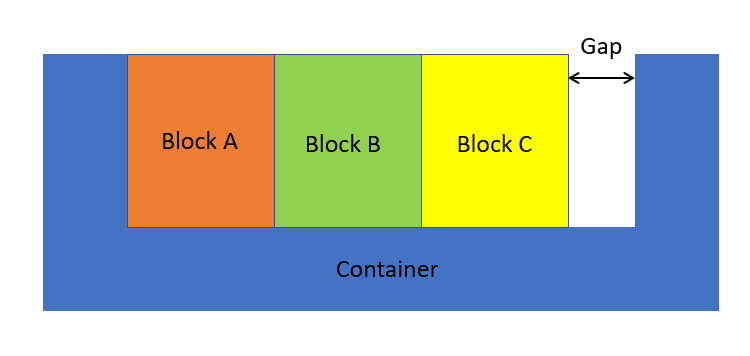

Hi guys,
Let's say we have the assembly of three blocks placed in a container such that the worse case dimensions of the block and the inner width of the container results in zero gap. Therefore, in non-worse case situations, there will be a non-zero gap on the right side.
Question is: What methods can we use to reduce this gap further?
Any assumption on type of fit, block and container material etc is allowed.
For example, two methods are 1) Use RSS so that nominal gap can be reduce. 2) Built in interference but cool the blocks so it shrinks and heat up the container so it expands so that the blocks can fit.
I can't think of any other methods - a press fit? But not sure how that would work.
RSS barely works if the distributions of the widths are all Gaussian and still provides a Gaussian distribution anyway, not a firm cutoff.
Peel-able or stacking shims are a popular choice. Start with a stack for the worst case gap.

But some of the possible solutions:
Moving sidewall that is adjusted after placing the blocks in.
Compliant sidewall.
Compliant fourth block.
Fourth block manufactured after the gap is measured.
Tapered fourth block.
Stacked shims.
I think the most basic answer would be to tighten up your tolerances.
If the container length is 3 -0/+.1, and each block is 1 -.1/+0, then the largest gap is 0.4.
If you tighten all those up by half, the container becomes 3 -0/+.05 and each block being 1 -.05/+0. This results in a maximum gap of 0.2.

Depending on the scale, opposing wedges or threaded posts may serve to prevent movement.
If you're going to achieve fit by press or thermal means, do not underestimate the amount of stress.
The OP question is too open ended.
Fit versus function.
Is zero gap the goal, or precisely as stated, simply some amount of gap reduction ?
As mentioned by others, The effects of thermal expansion in service could be mighty significant, so are among the details that really need to be included in the initial problem definition.
How about making the opening in the housing real big, to include one of these?
Or just adding some tapped holes to one end of the main housing for a few setscrews to clamp the parts securely, or even to just maintain .005" "gap" ?
