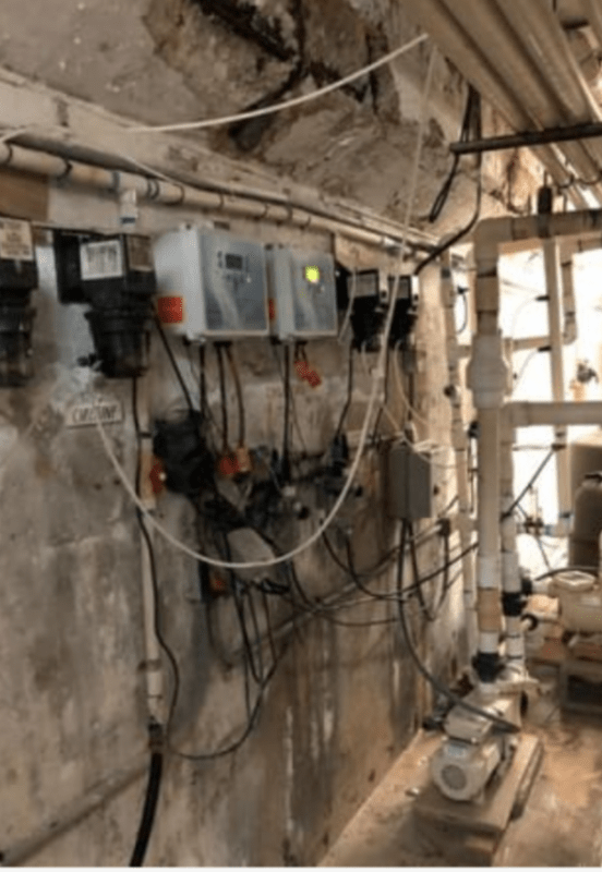

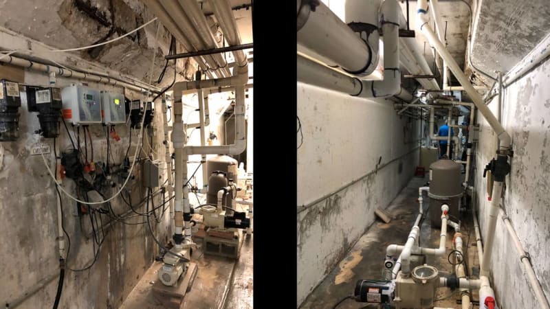

Pool equipment room picture 36 hrs before collapse. Contractor doing the pool equipment quote “There was standing water all over the parking garage”
“He thought it was waterproofing issues,” the contractor said of the staff member. “I thought to myself, that’s not normal.” He said Jose told him they pumped the pool equipment room so frequently that the building had to replace pump motors every two years.
The deepest puddle of standing water, according to the contractor, was located around parking spot 78 — an area that building plans show is located directly under the pool deck[...]"
No, but the pool would be sitting on the ground so it wouldn't be putting any weight on the columns, and the deck around the pool wouldn't put to much load on the supports below. Also, that looks like a salt water system that's clearly been leaking. So even when the tide wasn't inundating the garage, the support columns were probably under a steady salt assault from the leaking pool fixtures.

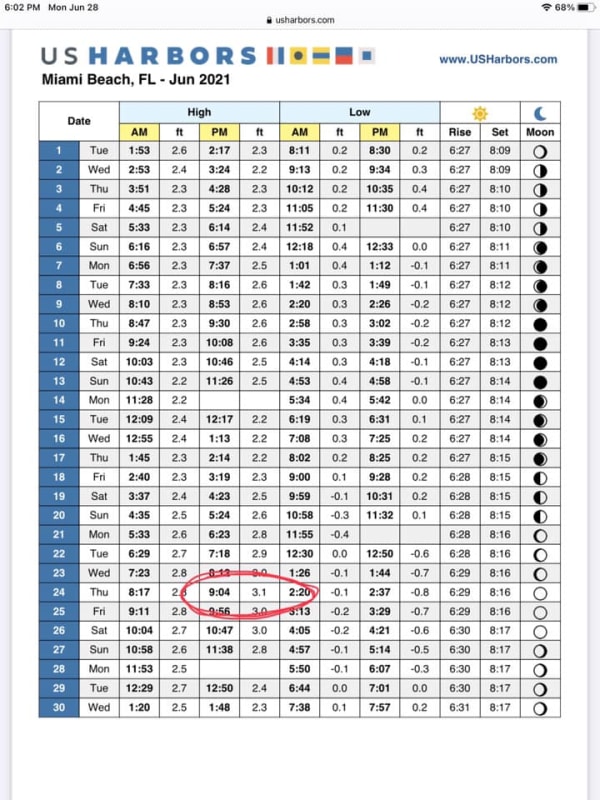

The drawings show parking level at approximately elevation +2'
The high tide on the night of the collapse was at elevation +3.1" at 9:04 pm. Higher than usual
(note: times do not exactly concur)

EDIT: just noticed low tide was an hour after collapse
Maybe the cyclical nature of the tides and hydrostatic pressure
