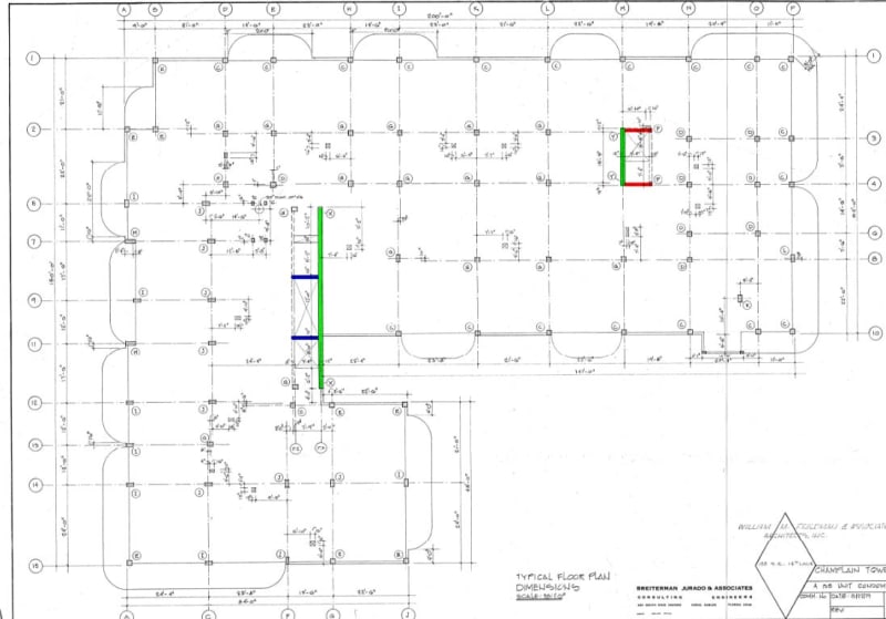

Responding to Ingenuity's post, please correct me if I'm wrong, but it seems column I-10 was originally designed as an interior column. At some point the decision was made to not construct this extension, making column I-10 an exterior column. Depending on how late in the game this decision was made, makes me wonder if it was ever analyzed for the increased live load distribution? Or was it simply a matter of "it's carrying less trib, therefore OK" ....then add in the planters installed on the corroded plaza-level slab. Is it possible the column was overloaded?
I'd like to see a single comment with the drawings of the garage, lobby, and the first full residential floor before the footprint was revised and after. I tried scrolling up and down to compare, but I'm too tired to do that tonight. Was this one column that was supposed to be within the building envelope exposed to the elements at ground level? Can you see this column in photos?

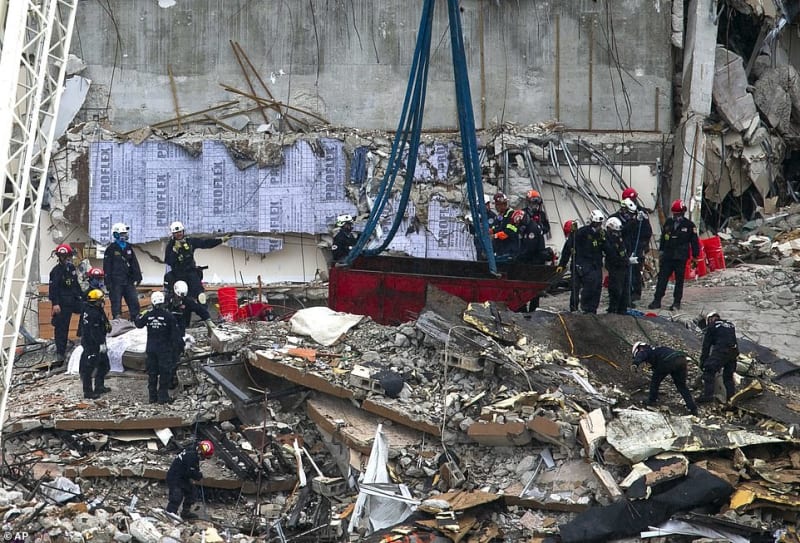

Any comments about the Proflex membrane material depicted in this photograph? Below the failed level the ProFlex is on, the edge of another failed level can be seen.
A quick search suggests they do all sorts of products for different purposes, so difficult to say for certain. That is a fallen floor slab which has remained attached to the elevator shaft shear wall, hinged down on its rebar. It would have been the floor of a bedroom. It may be something quite innocuous like an underlay for flooring material.

I'm curious about the lack of shear walls (isolated and composite) and the impact it may or may not have had on the collapse. If they had closed off the secondary stair with the red walls, would that have prevented the total collapse between Grid H - P, assuming the diaphragm were cut off from the blue shear walls if the initial collapse occurred around Grid H.
Running a few quick numbers on the East-West direction:
Building is 46m wide and 36m above ground = 1656m^2. Say 2.5 kPa basic ULS wind pressure (hurricane)
Base Shear = 1656 x 2.5 x 1.3 = 5400 kN
Base Moment = 2.5 x 1.3 x 46 x 36^2 x 0.5 = 96 900 kNm
So they have two 2.5m long by 250mm (27.5 MPa) shear walls in the EW direction with not much gravity load due to openings either side.
Tens/Comp stress at the ends of shear walls would be running at around 185 MPa
(ie over 6 times the concrete grade) (not taking into account at effective flange action with the long transverse wall)...
Column on Grid I/8 is 305mm x 610mm (incorrectly noted as Type G but actually Type L) with 41.4 MPa concrete grade. Length is around 4.2m at the lobby with a slenderness ratio Le/r of say 1.0*4200 / 0.3*305 = 46 (>25 so deemed slender)
Say design ULS loading of 10 kPa (200mm slab, 1 kPa SDL, 2 kPa LL) with roughly 50m^2 trib area over 12 floors is around 6000 kN.
ULS stress is then running at around 32.2 MPa (78% of f'c).
At that sort of slenderness I'd be expecting a max ULS stress of roughly 30% of f'c.
I might be way off with my imperial to metric conversions...
