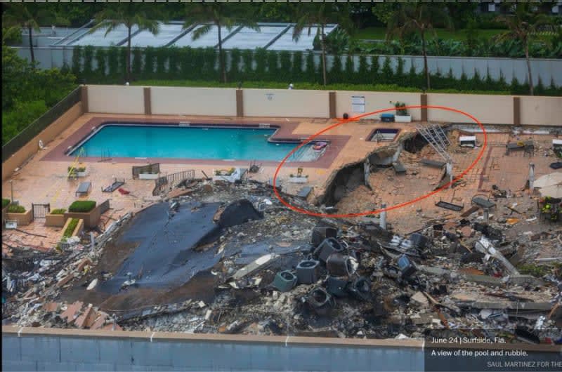

I heard that the collapse started with the pool deck. Some woman, in the condo, was on the phone with her husband (not in the condo) and stated that a sink hole opened up below the pool as it had sank down. The call was then cut off.

Assuming the pool deck did collapse first, as seems apparent due to eye witness reports, the collapse force would have been not only vertical, but it would have had a horizontal component. Enough to pull a 12 storey building over, one with not much shear wall capacity? Perhaps. Brings up the age old question of structural separation. Should the pool deck have been a separate structure? Probably.
Hokie66
I asked that above. If it failed, and collapsed leaving the lowest column un-braced, then I can see that. Progressive collapse. There were some reports of cracks opening up hours before the collapse.
I see a lawsuit saying the additional roof weight for the roof work caused it. I would assume the building (or that column line) was not at 100% live load and DL. again, not sure on the deterioration at that location. But the lawyers know.
I suspect stongly that it and the lack of maintenance was at this point... I'm still waiting for other info, though.
The pool didn't collapse, so this discussion about the pool is not relevant to the building collapse.

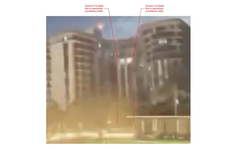

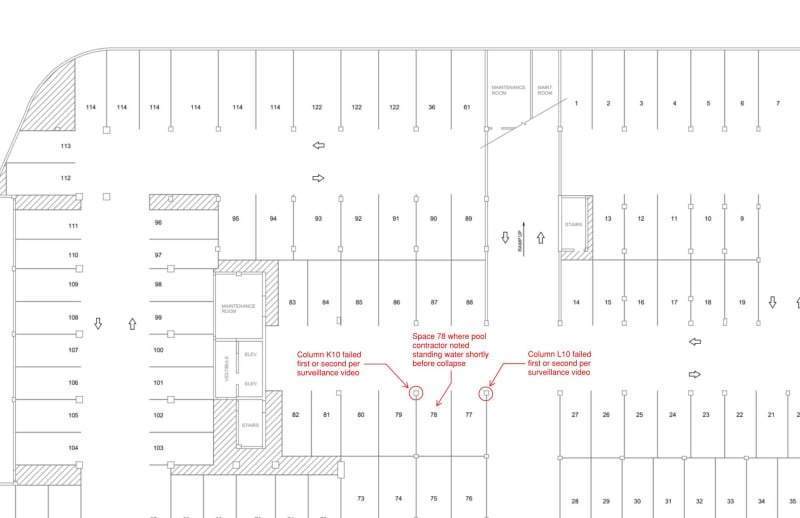

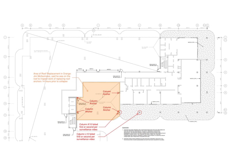

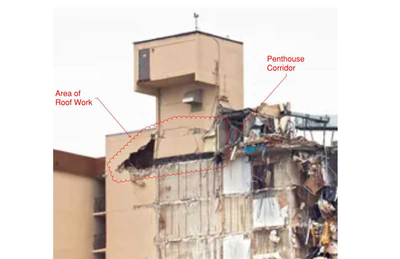

The roof work needs to be reviewed more thoroughly, it was occurring directly over where the collapse started. A few questions:
- Did the roof workers use any heavy equipment requiring shoring?
- Was the standing water near Space #78 there because the roof workers had taken the roof waterproofing off to replace it and water infiltrated the building (adding weight)?
- Did they use a tarp that may have collected water increasing the weight at the roof level and subsequent column loading?
- Were they drilling into the columns to install roof anchors, could this vibration have caused a failure at a lower level in an already compromised column?
- Did the bootleg penthouse addition contribute by overloading the columns?
-W

Garage Plan:
Roof/Penthouse Plan:
View of Roof After Collapse:

Don't forget the already compromised columns. The I,K,L,M columns in row 9.1/10 were sitting in standing water where they met the basement slab, and under planters with a drainage problem at patio level. You might have both column and slab damage / degradation at both ends of those basement columns. Patio slab fails in the middle of the outdoors, pulls on the top, kicks the bottom; or pulls on the top and hangs on until that fails. It only has to pull and kick those columns a little bit off vertical, to setup the next step of the progressive collapse. It doesn't have to instantly pull those columns out, and the progression may have paused for a short while there. Just a little damage to 3 or 4 adjacent columns that already had some significant rebar corrosion and spalling.
The video from inside apartment 711 has the building severely compromised for something like 15 seconds before it falls, the woman in 611 saw walls cracking with sufficient time to escape, and Gabe saw the patio slab drop from apartment 111 with enough delay to escape.
warrenslo - the collapsed pool deck:
I disagree, and it's down to language use. People are saying "pool" and "pool slab" when they mean the patio / plaza slab between the pool and the building. They mentally consider the "pool" to include the upper slab surrounding it. To them, the slab collapsing is (part of) the pool collapsing. Remember that their description is colored by adrenalin, panic, and trauma; also they are laypeople who don't describe things accurately.
