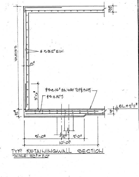

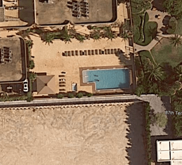

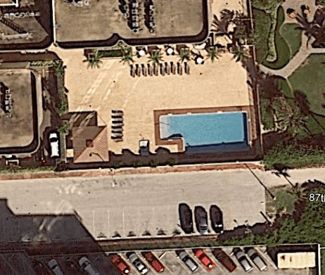

The original 87th terrace was a car park / access to the beach
Then they cleared the previous building in about 2015 and then it looks to me like they sheet piled the perimeter, much closer to the existing wall / boundary.
Did this affect the possibly weak join between the slab and the wall?
So if the slab to wall joint failed then you have a slab with several metres of cantilever with point loads on those columns.
Can someone better than me find the details of the slab to wall joint?

Here's a section detail of the perimeter basement retaining wall. The ground floor plan calls up #5@12.

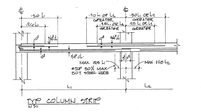

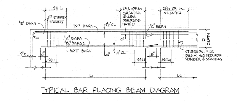

I just went through some of the documentation, and one thing that immediately stood out was the highly technical details relative to what a construction worker would be expected to understand.
Refer to the 2 details below as an example. I was taught to notate the drawings clearly enough that a layperson would understand.
However these would be something you'd typically find in Concrete Standards. It's the engineers job to 'translate' it without risk of misunderstandings.
I'd say it's plausible that this was a contributing factor to the collapse.

In my experience, the details you show are pretty common and are intended more for the detailer who is producing the rebar shop drawings.

These seem typical to me. Typically shop or placing drawings would break it down further for installation.

The drawings seem to show the swimming pool ending at either Column Lines M or N, depending on which version of drawing you look at. It's unclear how the pool steps and the jacuzzi are accounted for. Could either of those have affected the continuity or development of the two-way reinforcing in that area enough to make a difference? I know that in non-typical areas of a two-way slab steel placement can require quite a bit of judgement. And the slab failure does seem to hit right at the corner of the jacuzzi.
