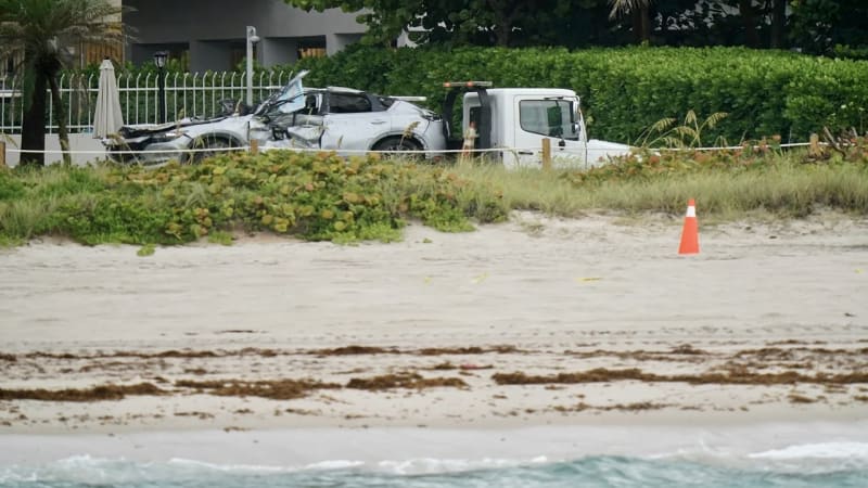

Spartan5 said:
Concurrent with the removal of debris, they towed at least two damaged vehicles away from the site. FWIW. Can’t say for certain they came from inside the garage.
I understand they are towing the damaged vehicles on the street to the north of the site in preparation for demolishing the remaining structure.
