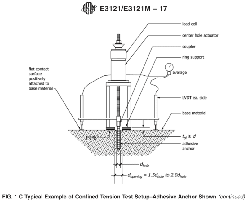

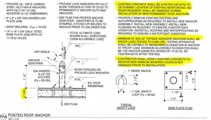

Typically the load test is performed by testing, by tying two anchors together, then jacking them with a load meter until yes, 25 percent of the load is met. The 5000 lbs is an ultimate load, they are test loaded until 1250 lbs.
What is the point of load testing to 25% of the load you are rating it for? What does that prove? In my opinion all that test proves is that the anchorage is rated for exactly 1250 lbs with a safety factor of 1.0000. You can't just waive your hand and say that since it didn't fail at 1250 lbs, it must be good for 5000 lbs. What am I missing?

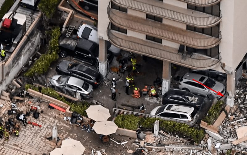

I find it intriguing if not improbable that a random TikTok video would reveal such dastardly evidence from the shadows, however buildings don't just fall down by themselves and a vehicle collision with a column has always been considered as a potential precipitating event. This vehicle would now be under considerable rubble given that the tower fell slightly to the south. It's not likely that an Einstein determined which column would take down the building but accidents do happen and disgruntled folk do exist. The story of the couple that moved into a motel and left their vehicle behind has me scratching my head.
This a distinction between ultimate load and service load in the concrete and steel codes. I didnt make the rules, but the thought process for fall arrest systems are that they are only used once: When someone has an uncontrolled fall off of the building and their harness system catches them. The 'real' falling load is about 1250 lbs, but to account for different falling conditions, faulty construction, heavier set workers, possible factors unforeseen a 4x factor is applied and that is the design basis of the engineer. In sum, They are designed for 5000 lbs ultimate load and a 1250 lb service load. Basically the load factor is designed. Its similar nomenclature to how people have been talking about how the live load rating of the structure is 40 psf, or 100 psf (depending on the location) but those are service loads. When you apply the load factor, depending on the load combination, the actual design load can be 64 psf or 160 psf, respectively. Ultimate, vs service.
I would assume an accident. People drive drunk. Elderly drivers get confused and hit the wrong pedal. People get their foot stuck. In the middle of the night in the dark especially, none of those things alone would be surprising. Someone took out the stone planter and fountain at the entrance of my neighborhood this spring when they understeered the turn from the intersection. So yeah, accidents do happen.

With respect to a collision in the garage bringing down the building. With each passing day in which we do not have a public statement addressing this issue the likelihood goes down. Right now, 8 days after the event, I'd say it's near zero. The first thing police are going to do is interview everyone in the area and pull all CCTV footage, much of which we've never seen, to determine if a crime was committed. And if there was any hint of individual(s) intentionally or unintentionally bringing down this building they would immediately hold a press conference to announce this news.

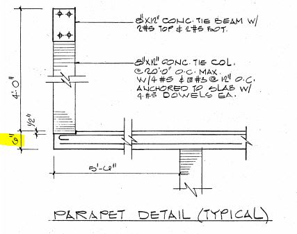

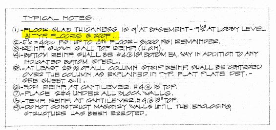

1. The "anchor" (fastener) detail for the "roof anchors" (fall protection) is mislabeled, it specifies carbon steel with a Hilti model number for stainless steel. Stainless steel is to be used in corrosive environments.
2. Roof structural drawings note 8" floor & roof slabs but cantilever detail at parapet show cantilever as only 6" slab (most likely to reduce weight.) Therefore, if the roof anchors were installed on the cantilever the slab would be 2" thinner.

I think the correct interpretation of the specification is that 25% (that is 1 out of every 4) of the Hilti adhesive anchor bolts will be load tested to 5000 pounds. It talks about measuring the elongation in the anchor bolt during the test, which is something I don't think you could do if you were pulling on the post.
The anchor post itself isn't tested, but it's designed to withstand a 5000 pound pull in any direction assuming the individual bolts are installed correctly. The working load is only 1250 pounds, though.

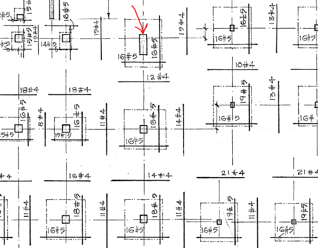

It looks like column I/12.1 was not built to be 24"x60" below 1st floor to carry the offset beam.

This is the typical adhesive anchor field tension test setup for individual anchors:

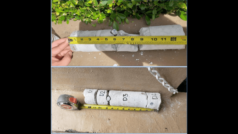

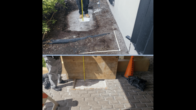

October 2020 9-page Morabito report obtained by the Miami Herald, concrete testing “yielded some curious results”. But no mention of what it was or numbers etc. “exploratory demolition” in five locations. "Experts said they were struck by what wasn’t said."
