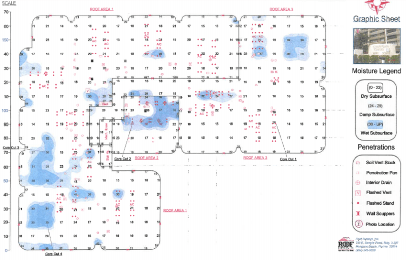

I don't have any opinions on what the trigger was, but after reading through all of these threads a few bits of info haven't been mentioned yet.

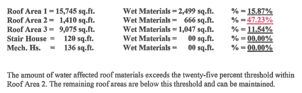

In one of the permits dated 5/17/2021 they did some roof core testing and found a lot of "water affected roof materials."
You can see them graph this out on the map as well in the permit. Kind of makes you wonder if this is the "curious" thing he found.. although, it doesn't seem that curious to me. It is the one thing he actually documents about the concrete that seems like it'd fit though.
These are both from this permit - It just seems odd that all they did was re-tar the roof before sticking a roof anchor right into the most effected spot on that map, only a month later. They mention ponding on the roof, and it looks like it's probably draining into the building right where that column is. Also, in a 3/3/1994 electrical inspection on the building they have a note that says "MIDDLE ROOF FACING SOUTH AND HIGHEST LEVEL OF ROOF NOT FINISHED" but there's no real info on when it was finished or what wasn't finished exactly.

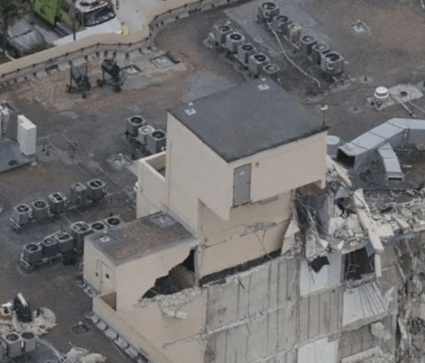

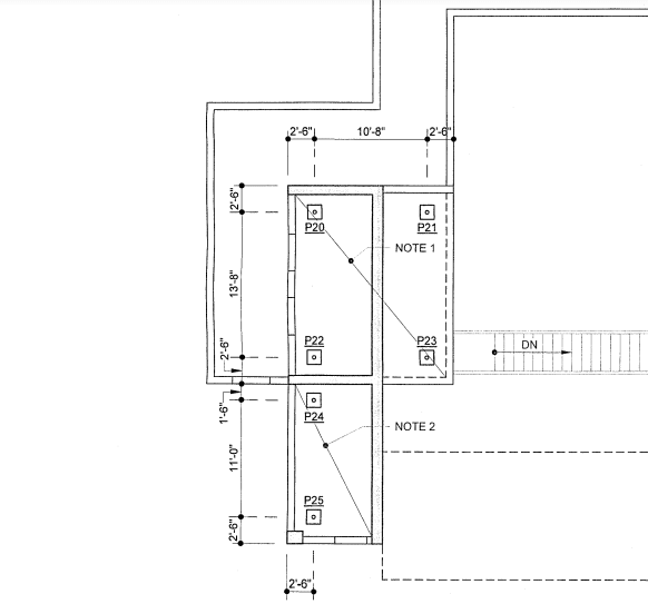

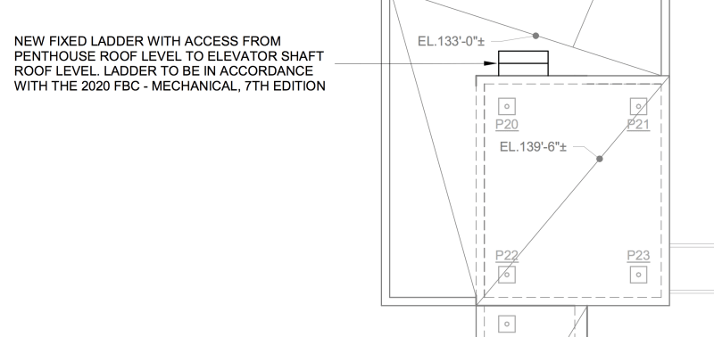

At least two of the roof anchors were never installed, P21 and P23. Makes you wonder if they stopped for a reason, since they were already up there and mounted two of them in that spot.
You can see them missing on the right side of the highest spot of the building. I actually had to check the google satellite view too, but there were no pieces of that section of roof that fell.. so they must have not installed them.

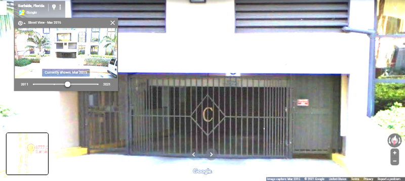

Also, I also dug up an old photo of the garage on google street view and lightened it, and I think it's pretty clear that we would be able to see the column in the tiktok video if it was still standing.. and it confirms that it's exactly where those rectangular pieces are in that video. It's hard to see in this pic, but there's definitely a light spot where it is on the plans. If a car did hit this column too, we wouldn't be able to see it's license plates on the other side of the standing column. Perhaps it's obvious that it's missing, but I was a bit curious if the old plans even matched the basement column layout.
jbourne - could anchors 21 and 23 have been cancelled, due to that portion of the building being cantilevered in a sense? It seems like they completed the roof tar without the anchors, suggesting they had decided against doing them.
Alternatively, the plan appears to show a north-south wall in the middle of the machine room roof. Is it possible that the contractor read the plan, and assumed 21 and 23 were not located on the uppermost roof?
Also, note that eastern edge of the 12th floor roof, over x10, is very wet. That area butts up against the penthouse wall. That is also directly over where the collapse appears to have started.

I found an alternate diagram for the machine room roof which does not have the dividing wall:

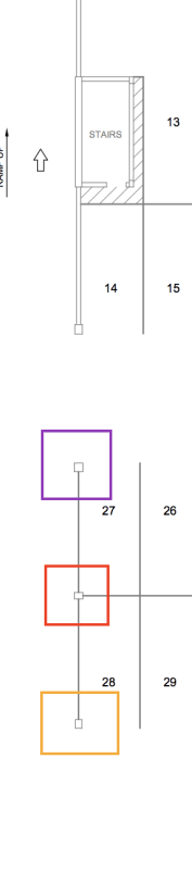

Also, the last column showing in your 2015 streetview is the one on the northwest corner of parking spot 27. That is the same one standing in the tiktok, with the white top and yellow bottom. In the floor plan below, I've put a purple rectangle around it.
The next column, based on the perspective, should be in the red rectangle in the image below. It's not visible, but it doesn't appear to have ever been visible in a photograph. The one after that would be in the orange. It's also not visible.

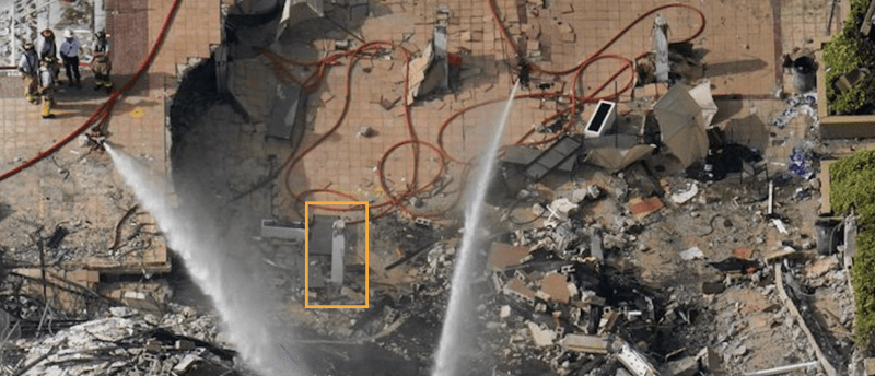

However, the orange column was still standing after the collapse:
(photo: WSJ)
I'm inclined to think that at least some of the red column should still be visible in the tiktok video, while the orange one clearly is not. That makes me think that the red column went down completely. Arguably, there is debris leaning against the orange column in the tiktok video.

Ah yea, that's a better diagram. Still a bit odd that they're missing. Perhaps that's just where the stopped for the day.
And you might need to zoom in a bit on the street view pic I posted, but I do think there's a lighter spot that shows the red column between 27 and 28. It's pretty hard to see, and mostly just visible near the top of the pic. I couldn't find any better pics though, it seems like the garage lights are too dim during the day to see in that far.
It is sort of odd we can't clearly see that orange column #28 in the tiktok video too, if the deck was completely collapsed then. Seems like the slab must still be connected to the building, and that could be blocking the view to it.
Quick question - how do you get historical street view images?
Js5180 - Yea.. I think it is a lot easier to see on the google image itself. When looking at a building on street view, there's a small clock right next to where it says street view, in the grey box in the upper left. You can actually see it in my pic, but that part's expanded there. Sometimes you have to click around a bit though on the street before you'll see that pic as an option though, I think I had to go to 2015 pics at the end of that road before I could get to that exact spot.

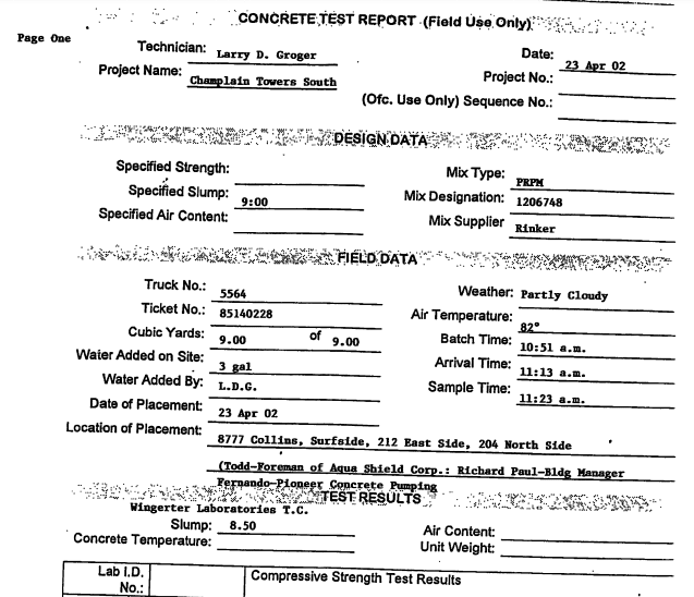

I think that I have read every serious post and either missed or no-one has posted information or asked about destructive tests that were recently made from typical cores taken from the pool deck, roof, balconies. Also there is no comment from anyone if there are construction records, shop drawing approvals, materials testing from the original construction. For liability purposes most firm and municipalities file this information.

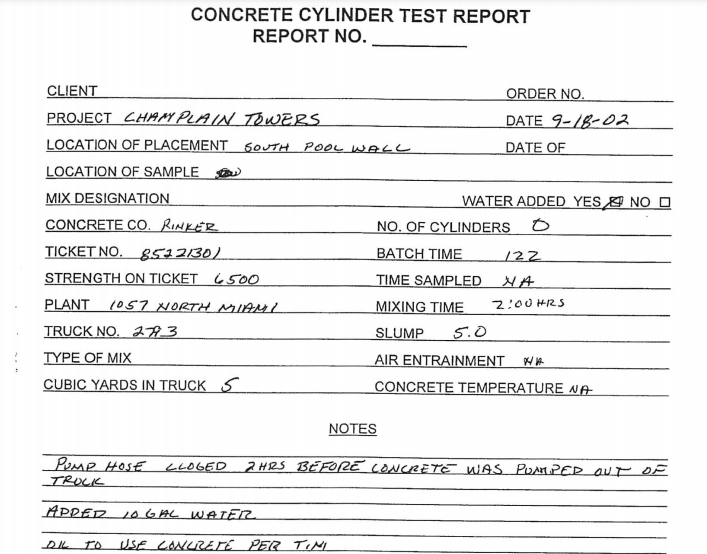

The recent ones don't seem to be online anywhere, but there are some old concrete tests from 2002 buried in this old permit -
Although, these seem to be from concrete they were pouring back in 2002 for repairs on balconies and the south wall by the pool. It does seem to say they tested it beforehand, but the results don't seem to be included. I know nothing about concrete, but with mortar you have to test the mortar first so you can make a close match or it won't adhere correctly. It seems like if they're aiming for a slump of 5 or 9, that's probably what they got back when they tested it?
Page 33:
Page 81:
That's all the info too btw, nothings on the bottom of those pages. There's also a curious note on page 15 of that permit about 204 having an uneven slab.
