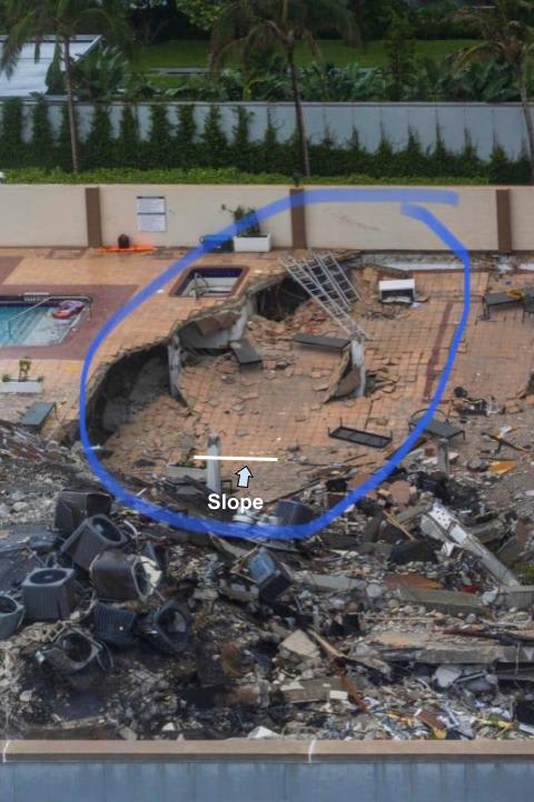

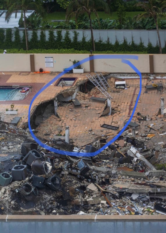

The more I look at the slab step from pool to patio level in the K-M 9.1-11.1 area, the more concerned I get. The construction details show a couple of bottom bars and a couple of top bars making a beam of sorts at these slab transitions. However, the pool level slab is basically hanging from the bottom of the 'beam' which means that it is really just relying on its own steel and concrete in tension for support. To complicate that, heavy planters are installed right on that edge in really the worst possible location.
Considering some of the other alarming things we have seen in the reinforcement steel, it is possible and maybe even likely that the pool slab was poured first and then the top half of the 'beam' and patio slabs were poured on top of the pool deck. This would pretty much eliminate any support along that edge. Also, although there are small beams along the K-M column lines, these are also stepped with the deck. Depending on how the steel was laid and how the slabs were poured, these beams may not provide much support.
My theory is that the pool level slab lost support midway between lines 9.1 and 11.1, probably right at the step-up. This overloaded M11.1 and L11.1 for certain, and probably also K11.1 to start. I am 90% certain that the stills from the garage entrance show that the planter that was on top of M11.1 punch sheared over the column and this caused the column to collapse. I think that the lower yellow part of the column is inside of the planter and the top part is broken and laying on top of the planter. The next bay to the north (M-N) does not have a patio level slab and appears clear of debris.
If, as I suspect, the failure was midspan, you would then have the patio slab hanging off the the 9.1 columns and likely attached with a few hook bars. While the moment load would be large, I don't think it would have been fatal. However, it is not hard to imagine the hook bars taking large chunks out of columns K, L, & M on the 9.1 line. The building might withstand one damaged column, but three in line on the outside line of the building would likely bring it down. Had everything been on the same level, the bars would have been continuous over the columns and this probably would not have been an issue.
There was also progressive failure of the slab from north to south, which from witness accounts probably happened before the 9.1 column line failure. However, none of this really mattered, once the slab failed between 9.1 and 11.1 the building was doomed. Similar column failures did not happen along column line I on the southeast side of the building because the slab was one level and dropped as a unit instead of being cantilevered and damaging the column as hook bars pulled out.

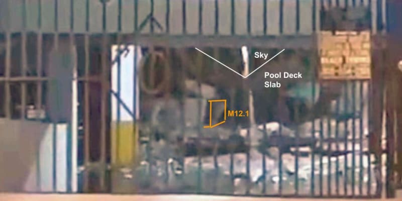

Garage image folks - if the contention that the building never left its footprint to the south is true, then all of the objects in the tiktok video may actually be the same objects visible in broad daylight after the collapse. Perhaps these could be mapped in terms of how they would appear to the tiktok user and we’d get a better perspective.
For example, are any of these objects visible?
Js5180, I think in that USA today garage video it looks like you can see the top of the pool slab. It looks something like this:
It's very hard to make out though, so I'm not sure that's correct. But if that's the case.. we wouldn't be able to see any of those objects. Since we can't clearly see column 28/M12.1 it's hard to say though. I think that white object on the ground might just be one of their planters too, not the missing column.

Ok, JBourne, that vertical bar in the gate, where the diagonal ornamental bars join, right of the “C” - from the camera’s point of view, where would that line fall on the pool deck in my picture?
It should be an exact line, and from that, maybe some of the other details match (or don’t match). But the line can be drawn exactly if you have a few known points, which we do. Every object in the Tiktok video can be placed within a triangle in the pool deck, and for one dimensional objects like the vertical gate bars, you can draw exact zones across the pool deck.

Js5180, I think if the pool deck were still standing, it'd be about here.. it's hard to place within the rubble though since you can't see it. I'm not sure if it's a diagonal cut either, seems like it could be straight and just sloping down in the direction of the V during the video.

Teguci, Nice write up! That white line I drew where the slab looks collapsed in that garage video is also suspiciously close to where you suspect the failure occurred. The rest of the slab nearest to the building seems to be on the floor of the garage, and M12.1 seems like it might be already puncture sheered. It all lines up really well with your thoughts on it too. It's nice to see the deterioration theory clearly written up.. although, very scary too.
I was thinking more like this - forgive the hand drawing.
Basically, tracing rays from the camera, through each bar in the gate, and out to the pool deck. We have exact blueprints and dozens of fixed objects to use. I may be able to work on it later, but this is the idea:
Then you can compare objects in each zone of the pool deck with objects in the tilt ok and try to determine if any of them match up. I’m thinking that white planter box is a candidate.
