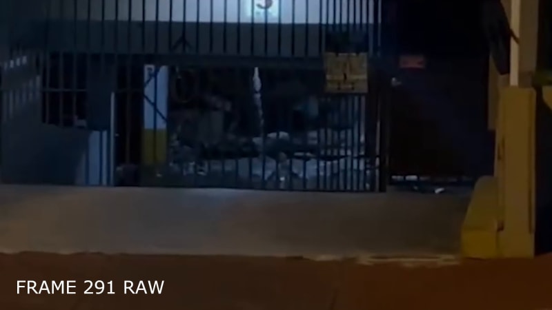

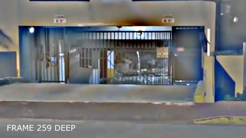

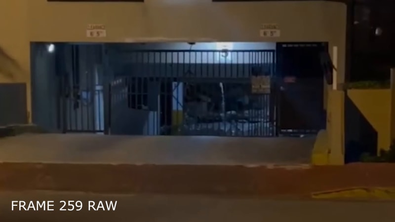

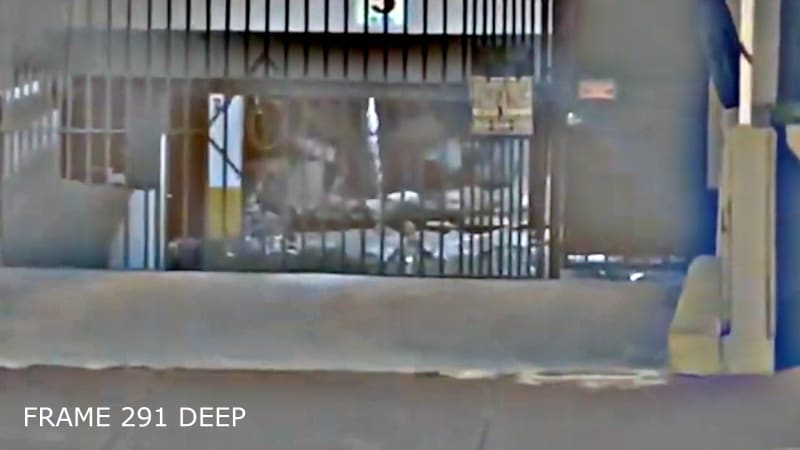

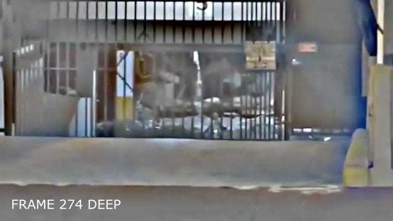

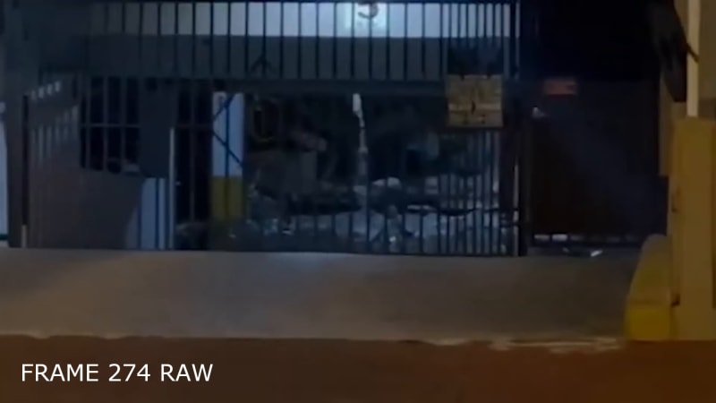

Does anybody know the timestamp in the re-occurring tiktok screenshot that appears to show a round object on the ground just below and to the right of the "C" on the vehicle gate? (aka the 'table'/'fan/'hvac unit'/'truck'/'portal to another dimension'. I have not been able to produce a similar view and I am wondering if it may in fact be a chance compression artifact.
For what is is worth to anybody, these are the images I have been referencing/processing during my reading:
Entryway Frame 259 Raw:
Entryway Frame 259 Deep:
Entryway Frame 274 Raw:
Entryway Frame 274 Deep:
Entryway Frame 291 Raw:
Entryway Frame 291 Deep:
and maybe I'm blind, but I'm not seeing anything that might resemble objects "from the roof". Rolls of tar paper etc...
EDIT: "hi-res" links:
1: Entryway Frame 259 Raw
2: Entryway Frame 259 Deep
3: Entryway Frame 274 Raw
4: Entryway Frame 274 Deep
5: Entryway Frame 291 Raw
6: Entryway Frame 291 Deep
Thanks.
