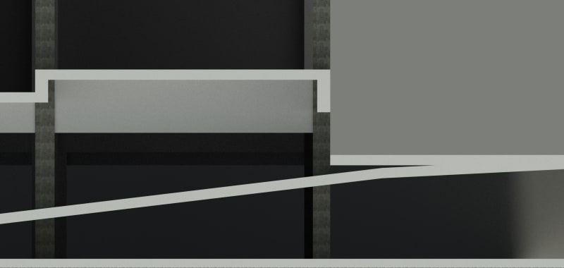

Thermopile (Aerospace) said:
Can anyone explain how this 12th Floor PH parapet is on the bottom of the patio deck pile, where deck did not fail
The first mid section of building basically fell within footprint, and it's an unimpeded fall for the 12th balcony and roof in the stairway exit area:

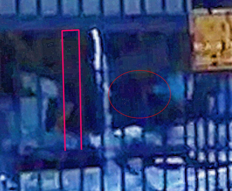

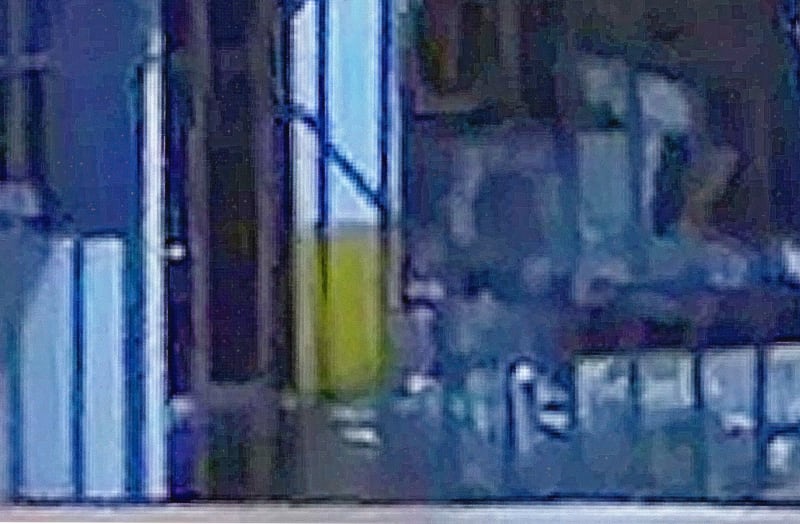

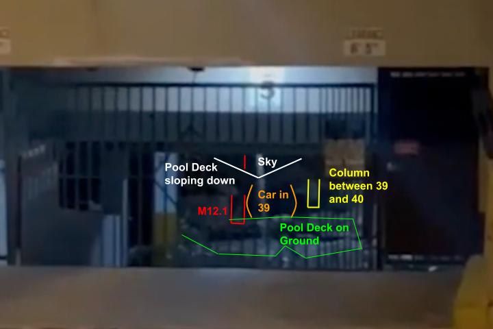

jbourne8 (Computer) said:
there was definitely a maroon car parked in that spot 39 next to the column too
Maroon? There is some pretty strong maroonish trace under what has been referred to as the fallen slab.
zebraso, the maroon car I was referencing is further back in the garage.. in spot 39. It was very flat when they pulled it out, it was late yesterday. It's a comment about this pic though, from further up in this thread.

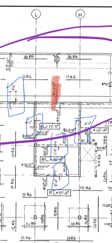

Santos81 said:
It doesn’t really work as drawn with the ramp down in place. Nothing really holding the load from the generator room.
Isn't it showing a beam running along the L & M lines either side of the generator slab? Somewhere in the various documents, they mentioned it being a 250kW generator. Taking a Cat D250GC as an example, that's a dry weight of 5324.2 lb to 6735.1 lb. It's not lightweight, but it's also not going to require a crazy amount of structure.
Why there? My guess is that it was simply a bit of space with limited potential for use, but big enough for a generator and crucially had sufficient exterior wall for cooling air grilles. A standard diesel generator produces about the same waste heat as electricity, so it has up to 250kW of heat to dump via airflow through those grilles.
Yeah it's a long shot again. I just read "maroon" and I knew I saw that maroon in my image and thought it did not belong there back when I first looked at it in the sense it was out of place. I know people will say it's a spurious artifact, but there are not too many all colors or the rainbow stuff like chroma interference moire so it occurs to me that there is something to it. It's just hard to say it out loud (again). I have to note that there is not much depth reference in the image. A lot of what the depth of anything appears to be is based of a loose collection of reference points. I just try to keep and open mind.
Slab Drops with ties from non existent slab into nothing but air between L/1 and M/1.
in spot 39
One more time. I'm a little slow sometimes. There may be a faint trace of maroon in the area that would be spot 39. I don't know what else that color is. It's in the purple range. Not as strong as the purple color is shown up front where there is more light. I'm not saying this information is worth anything. But it might show that camera can detect colors in dim light (or not).
zebraso, all I saw there was a black spot.. that's actually what drew my attention to it, was how dark that spot was. I think the back wall of the garage looking green in most videos is kind of proof of how crummy that camera is really. The entire back of the car looked completely in tact too.. so I doubt it was missing a back bumper or something, if that's the suggestion.

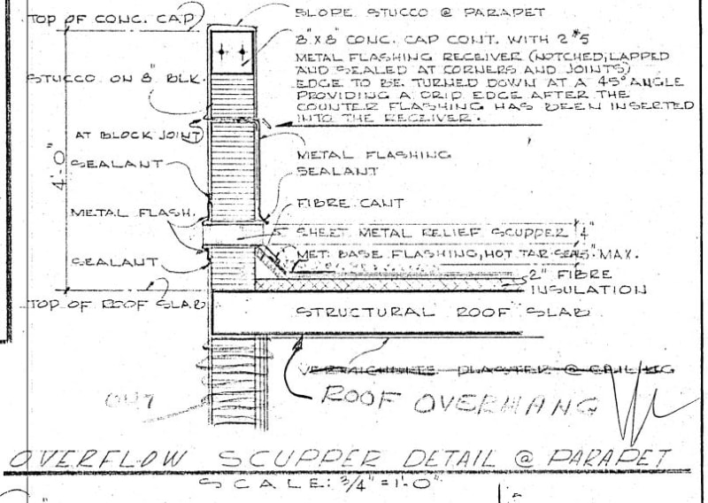

Santos81 said:
The overflow scuppers were not the primary RW drainage outlets for the roof or UPH parapet balcony. Their base elevation was 7” above TOS and incorporate spring loaded doors.
I don't see spring loaded doors. It appears that the scuppers were no more than 5" above the top of the gravel/flood coat.
No. I'm trying to cut down on being obtuse. I really missed the context of how far back this was in reference to. And I agree with where the columns are said to be although it's almost impossible to actually see them. Although looks like something is actually leaning against M12.1 (like a broom that probably is not a broom). I tell myself the columns are there because they have to be. The purple color along the fallen deck in front is a mystery as far as I am concerned. I could just say "artifact". That's the easiest way I guess. Whatever the case, it does not seem to have any significance at this point. The teal colored thing would seem to be well in front the column between 39 and 40 because I don't see anything that near the back wall being that well lit or is it just that the area is not obstructed by debris? I'm assuming there is a dust cloud in there and that is why some areas look opaque. Otherwise the lights should illuminate all the way back?
