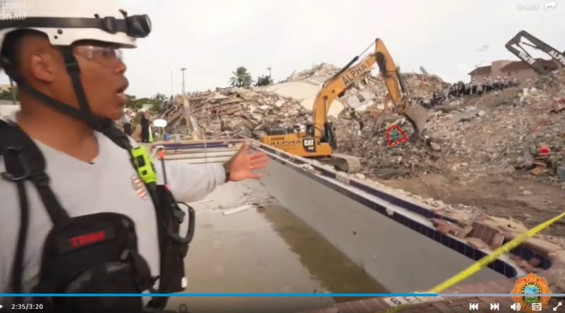

SFCharlie (Computer) said:
A Cat-Racoon Hybrid?
I see. Well the intent was to frame the crop around the teal green colored object. That was first noticed on the second page/part of this ongoing thread and I don't think anyone concluded whether it was teal colored foliage (which btw was the first mention of planters in the basement by association) or - whether there was the idea of it being the green colored tarp covering used for the roof rolls. Neither of those would I expect to be teal in color based on what I think plants look like or the photos of the actual tarps seen on the roof. So unless a cat-racoon hybrid also happens to be teal I think you may be missing the main focus of the image.
And ok I'm being a little coy I admit it. So maybe there is no teal colored object or material at all.

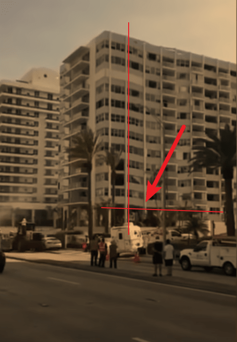

Seriously, do you truly believe that a single 16" column is under that much compression, that its failure would result in a 12 story building failing?
We pretty much all agree that there was much more going on than just a column failing in isolation.
In my opinion and some others' too, the failure of the pool deck slab had a significant horizontal effect on one/some of the columns at the lobby level.
What about that other illegally demolished building (5775 Collins Ave.) where they were ripping out columns with a dozer? I think it is actually quite enlightening. GRANTED: I don't know exactly how many columns they had ripped out but the point stands. Especially when your (CTS's) diaphragm is only dragging into your (CTS's) 8 ft long shearwall with a couple of #4's. Also note that by all accounts i have seen, these guys were taking out columns 1 by 1 - no explosives.
From [URL unfurl="true"]https://www.youtube.com/watch?v=f4Ty0OzSNz8[/url] around 0:30.
1: notice the column adjacent to the collapsed column is still relatively straight
2: not so straight anymore and we are forming hinges at the slab and also buckling the columns at both locations to the left of the collapsed column
3: observe how much the entire left portion of the building has moved from it's initial position. A few feet at least.
Yes, I believe the loss of a single column can indeed initiate a progressive collapse. Read: Alfred P Murrah (well...two columns in that case), etc.

Speaking of the aforementioned lightened/brightened frames, does anyone have any additional impressions after looking at them? I feel like the shapes in the foreground of the debris pile are spectacularly delineated, but I'm not sure if that's a genuine or artificial byproduct of the method of enhancement. To me it looks like a beam (too long to be a column?) The segmentation is definitely interesting. And then the background just above it appears to be red in color, but again, how much of that is artifact?
I wonder how close they have been able to get to this actual area as they're excavating, it's hard to tell from the site walkthrough video. And for that matter, how long it will be until any of that information is actually released...for all we know, they have video from inside the garage itself. I'm really hoping they do have a lot of video from a multitude of angles, as has been suggested.

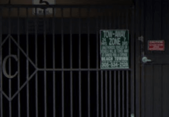

So I color sampled the original Tiktok video, no enhancements, just plain RGB sampling. Across multiple samples, I could not get a lower blue reading than green. I also sampled the rooftop bag in pic you posted above. It's also got quite some blue. Problem is, it's got even more green, but definitely not green as grass. What's more, the rooftop bag is exposed to daylight spectrum, while the garage debris is likely exposed to fluorescent light. Here is a link to the difference in typical spectrums for daylight vs fluorescent, not ironclad proof, but suggestive that garage lighting would accentuate green over blue.

Just to add some fun to the color debate: That yellow sign on the garage gate in the tik tok video? It's not yellow but very dark green with white text. Phone cameras try to make odd lighting look "normal". Enhance that for tiny dim details and you get odd effects back in spades. The true colors of items in these images is not certain at all.
