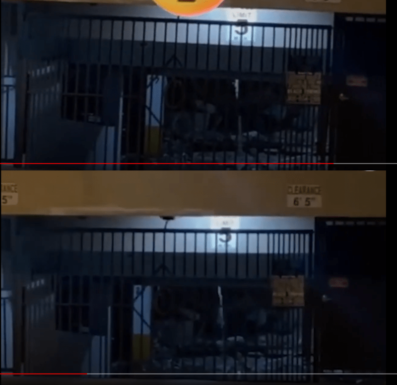

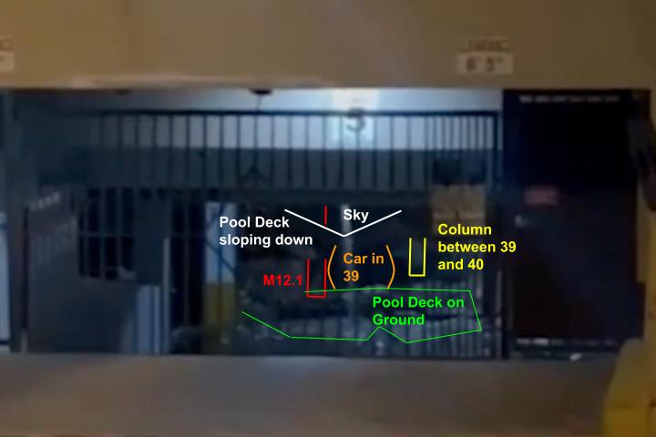

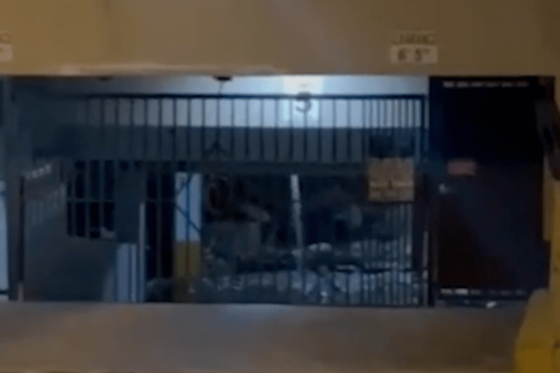

I took that USA today video and stabilized it and cropped it down too.. and tossed the tiktok video onto the end of it so they're all in one clip. I also removed the bits where she scans around and it's too blurry to see into the garage, so just the good bits are left:
Someone in here earlier asked why I thought you could see sky when looking into the garage, and I think that USA today video has been overlooked a bit. You'll want to watch the video to get the full context and see how the shadows change, but in the first few seconds you can see this frame:
I actually didn't notice what was going on here entirely until I was fixing the video.. it's a very time consuming process and I end up looking at the video a lot during it. Anyways.. it seems like the pool deck slab is actually resting on a car parked in 39, and it's clear that you can see the column between 39 and 40 (not sure what the letter is, but it's between L and M and is 13.1).
I'm sorry to say it, but I'm pretty sure you guys have spent two days studying the greenish tint of the back wall of a garage.. it's clearly behind the car and in the very back. This roof theory really has no merit.

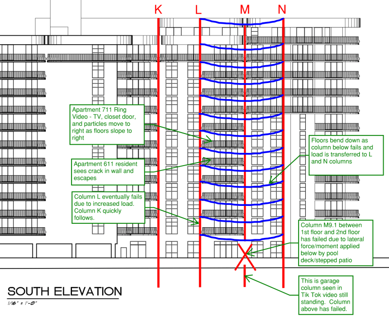

Really great work by 3DSoftwareDev and the analysis of the Ring video. It got me rethinking the initial collapse. I had always assumed the columns along link K and L collapsed first because that is what I saw on the CCTV collapse video. But I don't see how items can be falling to the right in the Ring video unless it's columns along line M that are failing first. I also assumed that M held firmly because column M-9.1 can still be seen in the Tik Tok video. But what if it's column M-9.1 between the 1st and 2nd floor that has failed? To go along with what 3DSoftwareDev mentioned, here's an elevation view of that scenario using the building elevations.
Thought I would put a frame from the TikTok video next to the USA Today video, both from Jbourne8's mashup. I thought they were the same file but they are clearly two different clips taken from two slightly different locations. Look at the #27 on the column and how the gate bars obscure it. Interesting how the object that resembles an AC compressor or patio table in the TT clip cannot be resolved in the UT clip. Of course this could be due to the greater compression in the latter. If there were 2 clips, I wonder: did she record more clips? Were the original files retained on her phone (likely will be higher quality and have less artifacts).
The same issue of compression/reproduction affects the other "primary" source of video evidence, the security camera from the property to the south. EVERYONE is working from a video recording of a screen that is playing back the video. I hope that the original video file is preserved (and that it becomes publicly available at some point), it is entirely possible that it contains sufficient detail to answer many questions, detail that was turned into blurry mush by the "re-recording". The strange "ghosting" of the highlights that can be seen on the white screen at the start, perhaps an artifact of the playback software, the screen, or of the camera performing the secondary recording, makes me think that much more detail is available than we are able to make out from the version we have access to.

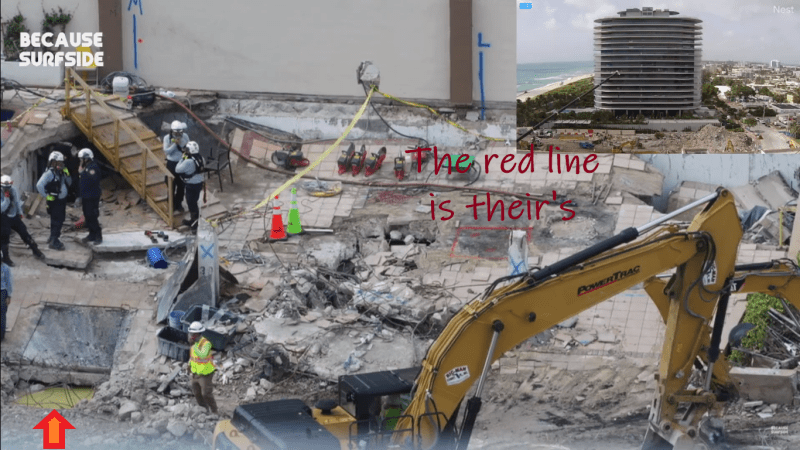

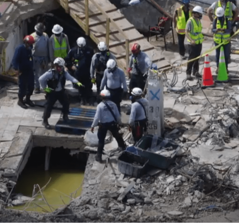

Livestream is a great find @SFCharlie. Unfortunately the ramp area of primary interest is just obscured from view by the adjacent building!
They have cut a nice clean rectangle out of the pool slab by the column marked 39 (EDIT 38?), slab layers are visible, it's definitely resting on crushed cars at some height and there is a good amount of water down there.
