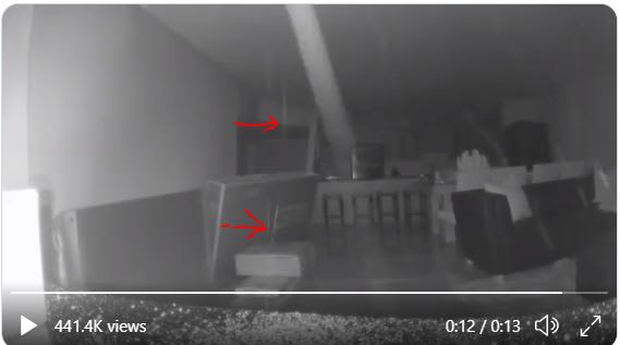

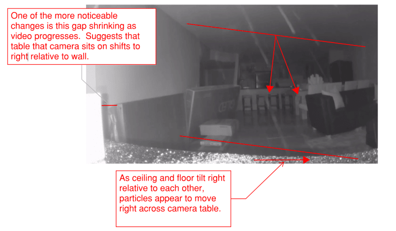

I think the slanted falling debris inside the apartment indicates some sort of air movement or being projected in a certain direction, not rotation of the entire apartment (as others have alluded to) as there are other particles further inside the apartment that continue to fall "straight" down. This is indicated by the red arrows in the image below:
Some additional thoughts on Ring video, of the shifting camera table and particles falling. I'm in the camp of particles falling vertically versus changes due to air movement. Especially if these are concrete particles, more likely to fall straight down because they are heavier.

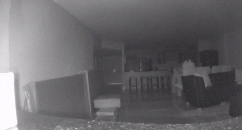

Does anyone know the model number or specs for this camera? Especially the focal length of this camera/lens, we can try to calculate/motion track the room _maybe_.
There might be other fixed landmarks in the video from the ring camera if looked at in reverse contrast or like a negative, since I didn’t even notice the granules from the ceiling in the mid-range until looking at still frames. Seeing a presumed 2d shape in the far wall and comparing it with other presumed 2d shapes could help to build out the 3D presumptions. Presumptively of course. I mean we can presume length of the back wall from the plans.
