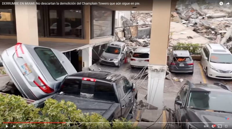

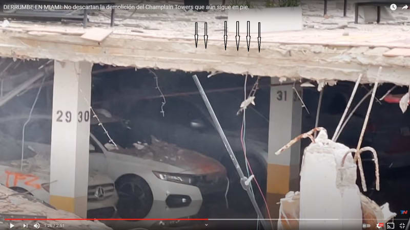

I found this video to have some the best detail (resolution) of some of the reinforcement that I could find.
Look at the concrete pool deck slab edge in the first screen capture...
Video Link:

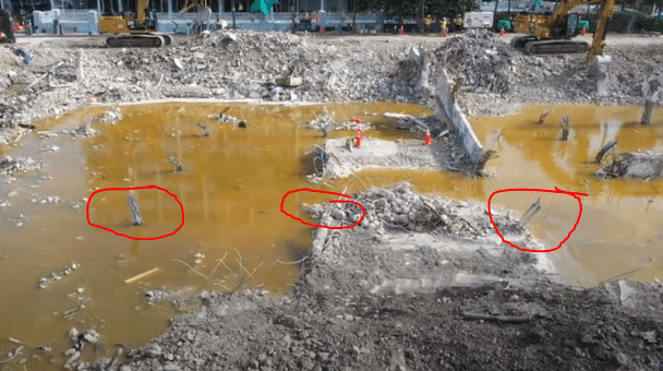

Just observational, but in photos below you can see former column bases K-9.1, L-9.1, and M-9.1 from left to right. This is generally ground zero for the building collapse. M-9.1 is the standing column in the TikTok video. The rebar in the photo is the vertical rebar that anchored the columns to the foundation pile caps. They've probably removed what was left of the actual columns for forensics. Noted that the rebar in K-9.1 and M-9.1 look to be in pretty good shape while L-9.1 appears to have been obliterated.

Looks like a construction joint. They made the key way but no dowels..... I saw some video of the south retaining wall that looked similar.
No dowels at all. It might actually be a slightly gapped expansion joint to accommodate left-right thermal movement. The upper surface separation appears straight enough. Maybe a shear key at best. In any case, there is no bar continuity across it.
