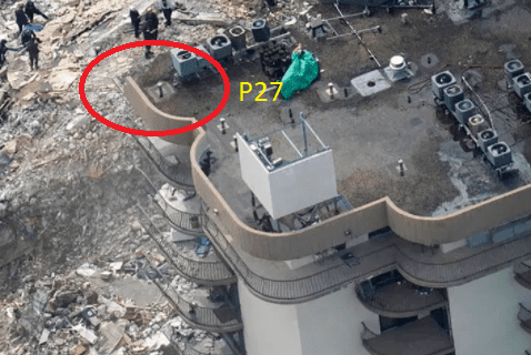

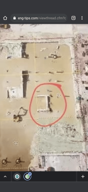

This one in particular was closest to the edge of the still-standing portion and can be seen to be clearly on the overhang from other angles (Can't find a good picture at the moment)
Roof anchors. Again. Notice it’s not any closer to the edge than the humongous communications array (I presume) with its massive wind loading (which is obvious).
That installation (it’s the thing to the lower-right that’s as big as the circle around the anchor you drew) didn’t bring the building down. But somehow a little bit of hammer drilling into a thousands of tons structure somehow vibrates the pool slab free 12 stories below or otherwise snapped a parapet off? That dog just don’t hunt.
People are so fixated on things they can’t see the forest for the trees. Now we are squinting at two different pictures to make them 3D? Woof!
The roof anchors are a non-issue here. They're used for fall-protection tie-offs. If some hammer drilling and Hilti's are compromising the structural integrity of a roof, you have way way bigger problems going on here. They're a moot point... so why even bother discussing it?
If the parapet above the collapsed pool deck did fall, it's mostly made of CMU (or cinder blocks). Once that hits the ground, it's going to shatter like glass. *IF* that did happen, for that to bring down a structural slab points to structural issues (weakened concrete / compromised rebar) on the pool deck as pointed out in the 2018 report. The cantilevered roof overhangs and balconies are part of the roof / floors and tied in to the structure with rebar. If those were to fail, they wouldn't just drop away from the building cleanly unless you cut all the rebar at once and sawed them off. It's a proven construction method as indicated by any Frank Lloyd Wright or brutalist architecture style building. I don't see that being a primary cause either.

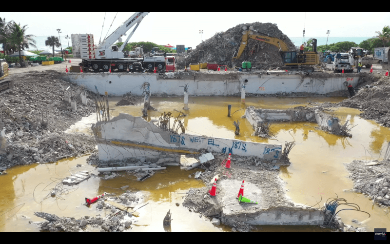

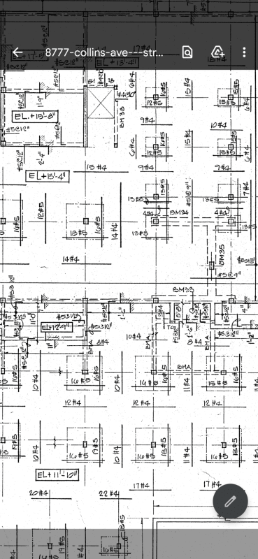

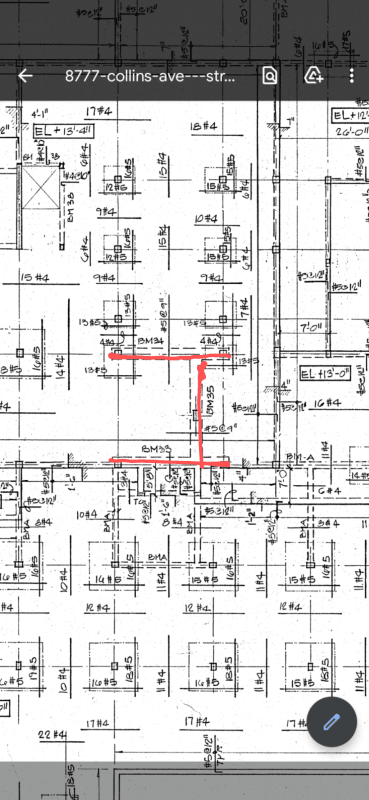

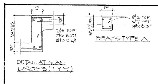

I find it odd that beams 33,34 and 35 appear to be exactly in place. They also appear completely intact. Does this mean the columns below (N8,O8, N9.1 and O9.1) did not fail?
Can anyone please advise me as to where can I see the reinforcing for the beams selected? I see this as a critical area. Also a dimensioned drawing -Plan?
Thanks,

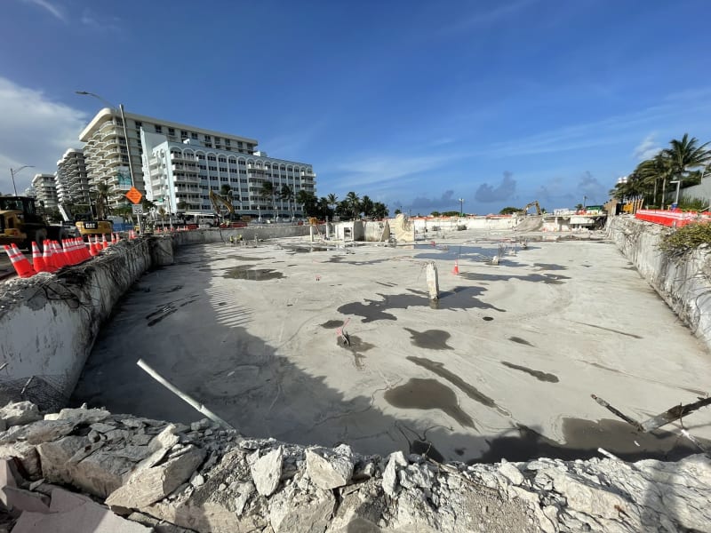

In order... to obtain a 3D image
That's the best sense of what is or isn't in there I have seen. I think it adds slightly more than just depth perception. But now I am permanently cross-eyed. I have the sense that the piece laying cross-wise that is dark may actually be the missing column as though a partial length of it is still white but another part has had the exterior crumble or shatter to expose the core thus it is darker.
Edit: after refining my cross-eyed stare, the dark portion is a little too dark to be concrete..... unless somehow it got tar all over it. I mean it's not like thing beside it is a tar buggy or anything like that.
Edit2: The other things that the double vision overlay does is provide noise reduction and dithering. It dithers the width of the gate bars so they seem thinner and block less (you see around them a bit). Noise reduction occurs by emphasizing what is there and de-emphasizing what it not. The added benefit is you get depth perception.

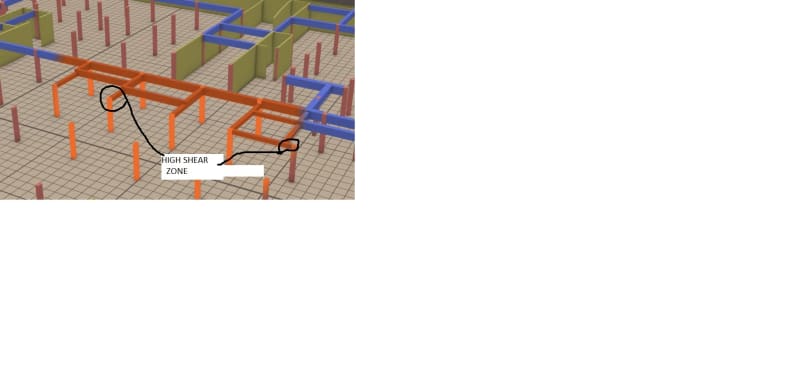

Vance,
That model is not accurate where you have the patio slabs. The beam along column line 9.1 is just the slab step and wouldn't look like that at the patio to living floor step since it is only a 7" step.

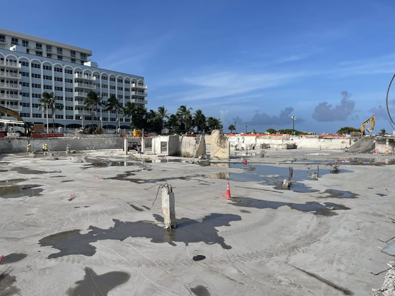

lol. Like with many, many photo analyses on these threads, I have to wonder: how can you possibly see that?
This image is 640x412, and rife with jpeg artifacts. I can only tell that some sort of something was at each column location. The state of the column and how intact it is? No way. Maybe you're looking at a high-res view or something?
From the photos of the garage provided by a prospective buyer, Beam A at column Line M is dropped below the slab and not integral to the slab as detailed above. I believe these beams may not have been constructed as part of the slab and may not have been supported in directed bearing on the columns. I believe they may have been hanging off the horizontal reinforcing. That also explains the intact “frame” mentioned above by Spinspecdrt. 3DSoftwareDev, I think the resolution is clear enough to see that something different is going on with these beams. I see these intact beams as some evidence that the plans and the construction of the transfer beams is not consistent or there would be slab attached to these beams.
rodface said:

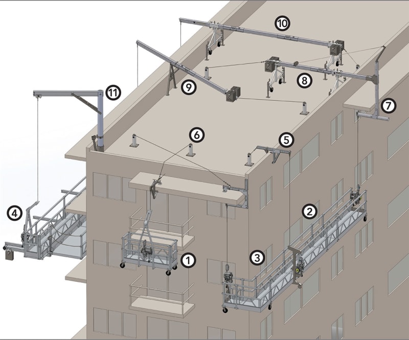

Something that continues to bother me about these roof anchors (as a total layman):
Some anchors are installed atop columns. But others are installed on the overhang.
Why not have anchors only over columns to ensure that the roof overhangs are not compromised in any way? Even as a layman it occurs to me that it is a bad idea to cut/drill/add weight onto a cantilevered structure. Of course if it is on the plans I would assume that the engineer had considered this...
Probably wouldn’t be a bad idea to understand how suspended scaffolding is arranged before questioning the anchor positions.
As a layout example:
And load test example:

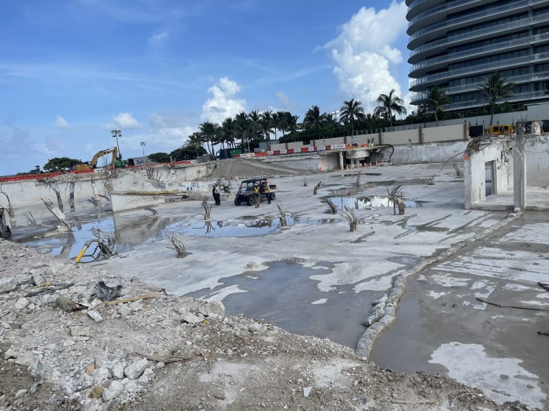

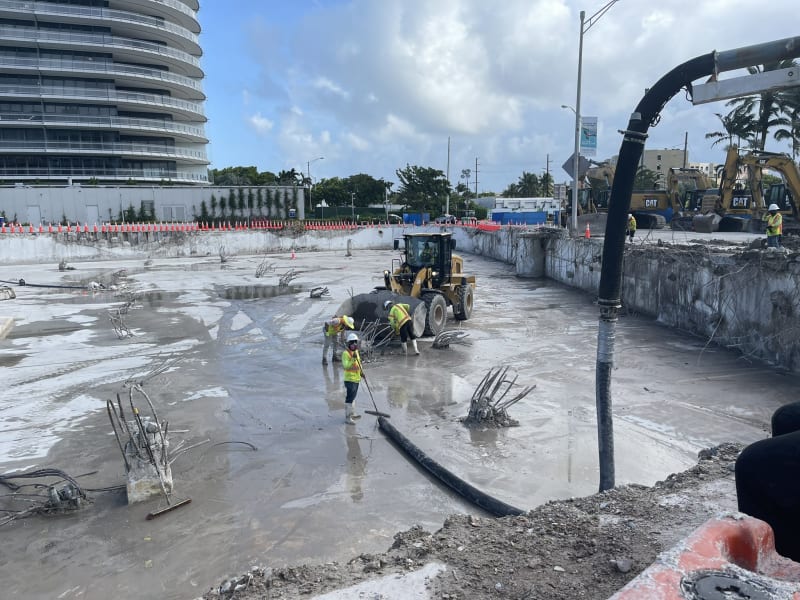

Up until recently I was under the impression that the building stood on 42" and 48" precast 14"x14" columns. I was unaware of the drawing revisions that specify Franki piles. Still haven't seen it, but I am not saying it doesn't exist. The version of drawings I have, dated with 1-17-80 revisions and notes, calls for only the following columns to sit atop PIF (I may be wrong on some of these because of the .1 denotations)
B1.1, D1.1, D2.1, D5, D8.1, D11, And the entire 1.1 columns row.
The remaining columns were to sit upon 42" and 48" precast 14"X14" driven piles. Floating in the sand, where fucking boats used to flow through!
I know it seems stupid. No one would ever actually go ahead with possible building something like that. But then again, no one would ever omit a large portion of steel reinforcement...
I have seen some shit go on here. You guys ever catch a shop welding nelson studs to unprepped steel for embed plates, but blasting it with aluminum filler and hoping the hot dip galv and going in the concrete before the inspector gets there gets it to pass inspection? Not saying everything in Miami is suspect, but Miami we cannot blindly assume the building is built as intended.
Treat the piles as suspect. The additional weight of those pavers, the tile, the windows, the cars, the rain, etc, all really starts to look like scary numbers added on top of the existing building. Subsiding in key locations that are slightly quickened due to heavy loading, could cause portions of the building to sink slightly more, and at an unusual way, compared to the more secure areas. Cause of the collapse? Probably not. But a very valid point, and one that could also affect other buildings.
Another thing we need to remember, is there was a beach restoration project done in surfside. The beach that we see there now was trucked in because it damn near all eroded away. Water may have found a way past the bulkhead. The pile driving from next door definitely didn't help the settlement of loose beach sand either. Even if they were all Franki piles, this building was not set on any solid rock surface. Where is the logic here?
3DSoftwareDev, I can clearly see the beams. No squinting, enhancement or imagination required. It's the only location in the building this arrangement of beams occurs. Obviously from the picture you can't tell the condition of the columns.
My apologies, I read "beams" and thought "columns" because at some point previously in these threads, someone conflated the two and now I'm screwed up. [glasses]
Yes, that beam assembly is certainly more clear than whatever remains of the columns. It was discussed previously; there are some decent close-up shots of it in previous pages I think. Seems to be intentionally kept intact by the on-site crew.
