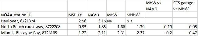

Sadly that station is not present on the NOAA database I found. It may have tides, but not all the reference datums recorded. Haulover also has insufficient data. No matter, we get the idea. At high water and "higher high water", this thing had wet feet, but not all the time. Posted as image to preserve tabulation. All numbers in feet.

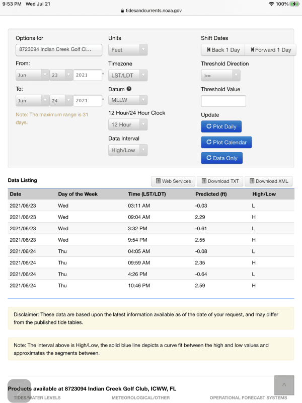

Santos81 said:
Indian Creek Golf Course ICWW Station ID #8723094 is the nearest appropriate location.
Ironically I first used Biscayne Creek but then thought twice and switched to the Atlantic side Miami Beach 8723170. I am still not clear on why we want the other side, but will be glad to change out the images.
There is a continuous bulkhead and dyke N-S along the eastern hardpack boundary from Haulover Inlet to South Pointe Park. In addition every structure along this path has an additional bulkhead placed 120’ west of this. The elevation is higher on the east side of A1A than on the west. Along the East shore of Biscayne Bay, the elevation is lower by several feet, the interior bulkhead is not continuous, private sea walls are inconsistent, and the storm water discharges are located there. Despite efforts to secure these with anti-return valves and pump stations, sea water is still entering many of these due to elevations that are no longer sufficient and frequent equipment failure.
Geography adds an additional problem. In the camera feed, we can see the tidewater entering from the west and moving east; the opposite direction we’d expect based on lunar movement. Biscayne Bay is very irregular when it comes to hydrodynamic flow despite what some mariners claim. CTS was due East of one of the more affected choke points.
