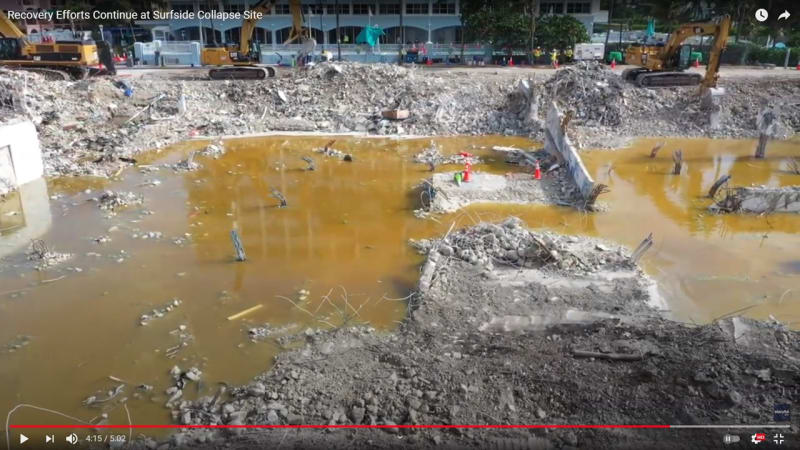

dragon6172 (Mechanical) said:
These two cars can be seen in this picture... they are in the guest parking in marked spots.
That photo has to be from after the second half of the building was demo'd. I think that must be understood by most. But it does seem to point out how it clouds the issue of investigation. It did not fall entirely within its footprint.

As others have told you repeatedly, red paint denotes the presence or potential for human remains. Most likely that a cadaver dog had hit on this area of the pile.
None of your the items identified through your theoretical squinting have visible paint on them.
You have not answered my question. If the red paint denotes the presence or potential for human remains, then why has the recovery crew left this pile in place for two days when they have removed the debris around all other 94+ cases of human remains? Is it possible that red paint denotes something else in addition to human remains? Like perhaps some object of extreme importance?
We haven’t established any kind of timeline for when the red paint appeared or when the pile was removed. Just because you don’t like my answer doesn’t mean I haven’t given you one.
They marked everything of importance with blue paint. If there was something of “extreme importance” wouldn’t that warrant something more than simply switching up the colors? Crime scene tape, cones, a physical barrier of some sort? And then why would they switch to the same color that they used to denote human remains? Why not yellow?
They did have a physical barrier of some sort. See the three red cones on the ramp in the attached photo? They are on the only path that can be easily used to reach the pile of interest. The other path is a ramp by the pool that is used by machinery and is easily controlled. And other photos show a red tape between the red cones.
If that 'barrier' existed to keep equipment from operating near that particular pile, there would be another barrier on the other side directly between the equipment operating on that side and that pile.
The simple answer, which he's repeated, is that we don't (can't) know why that pile is sitting there. We can, however, surmise certain things about how it appears in the photo. Namely, I can guarantee you that if something 'of interest' was found, they would not mark it with the same color they had been previously using to mark human remains. Procedures for crews working in these situations are extremely regimented.
It's also, in my opinion, VERY unlikely that this entire situation is going to be resolved because someone finds one little piece of bent rebar, or whatever. This failure, as far as we know today, was the result of systemic failures across the entire lifespan of the building from the initial design phase through construction, maintenance, and monitoring right up until the collapse.
In any event, I'm not sure what your intent is in continuing to belabor this point, but your posts appear to have a definite conspiratorial bent. I'm not sure why that is, but I think you're focusing on one tree rather than the forest.
Those two cones spaced 20’ apart are the barrier? There are none in this picture which shows clear unimpeded access to the area.
You also didn’t answer my question about why they didn’t use a different color paint if it was something other than human remains.
Maybe there is something important there. But I don’t thinks it’s davits, scaffolding, Sasquatch, ac units, rooftop ventilation fans, tar paper, UAV debris, roof anchors, etc.
Most likely remains were already recovered and counted in 94+. Red paint stays behind. May I note that the location is approx where "teal shirt" appears in the toktok image. No one wants to hear that, I know.

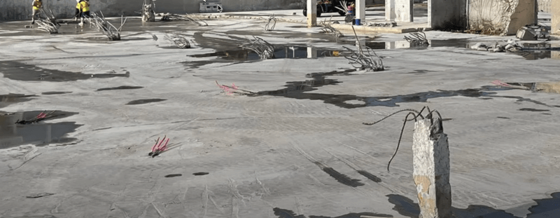

Spartan and Markbob, regarding Red paint... if it does represent areas where remains were found.
Why are these 3-4 column (former columns) painted red? They are/were under what was the still standing part of the building.

It's likely that they left that pile until last because yes, it is where the initial failure debris is likely to be and they wanted to look at it more closely. Even though that stuff had been moved around by the collapse and by the demolition and removal process.
But I'm sorry, I just don't see any of the things in your interpretation in those images.
I would also say that the presence of balcony railings in that rubble pile clearly shows that post-collapse material is mixed in there and so even if there is stuff from the roof, all that shows is that stuff from the roof ended up in the collapse pile, which isn't really a surprise.
Best guess, those column rebar dowels were painted red so people don't trip over them.
