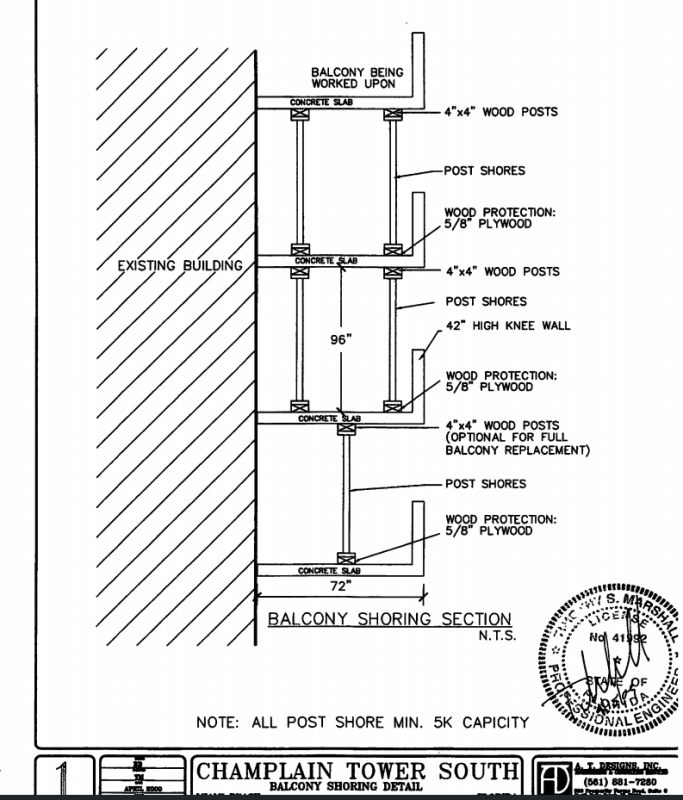

Edit: Shoring down to ground level? Interesting.....
Tighten her until she creaks, then back it off a quarter. It'll hold.
Also, shoring down to ground level? Who thought that was a good idea on that deck...|
I don't see that in the plans, but Im gunna go find that inspection sheet where he wrote there were no shoring plans on site.
Please define ground level? Top of parking deck or bottom of parking garage floor?

Shoring should be specifically designed by shoring Engineer, and not just some generic 3 story shoring like you might do for new construction. These are old tired slabs, so that is not adequate.
I imagine they just thru up a 2x4 stud weather wall with no design considerations to load it would be carrying?
Edit: Generic meaning bracing down only 3 floors

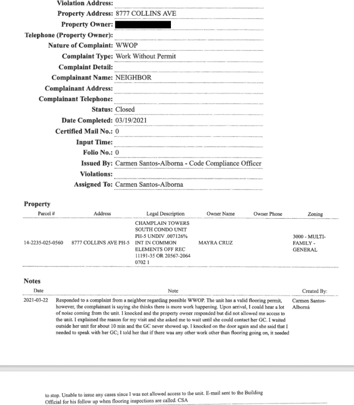

Speaking of inspections, I will be babysitting a partial rough electrical inspection tomorrow.

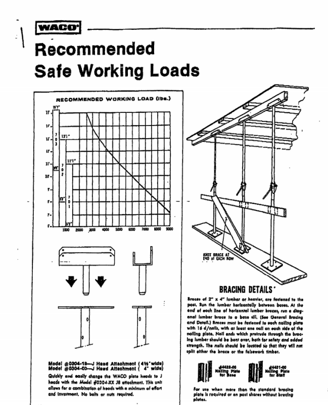

If you shore all of the balconies to the pool deck using 4"x4"x72" wooden logs, which slabs yield first if someone gets a little over zealous and wants to double make sure the balcony isn't gunna crash down on them from above, so they give it a little extra oomph on the handle? Never underestimate the torque a laborer on his 4th RedBull of the day can get out of a 12" handle on an acme screw, especially the little ones with something to prove.
