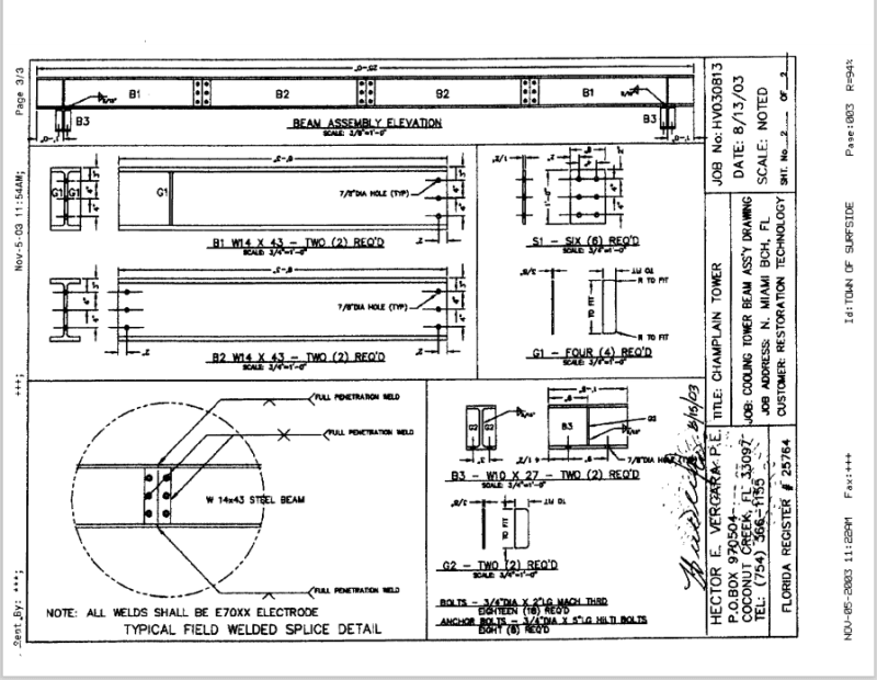

This is an interesting repair Circa 2003.
Do'h. 2 months before Hurricane Andrew came by and ripped our roofs off.
"Removal of 8" - 12" cap on top slab where planters are in front of condo. dowel in 4" into concrete #5 steel at 16" on center and install 3 #5 steel rod container in new cap (solid concrete. 3 areas are involved (TBtranscribed). Patch plates 18', 21', and 27" are length of concrete caps involved. "

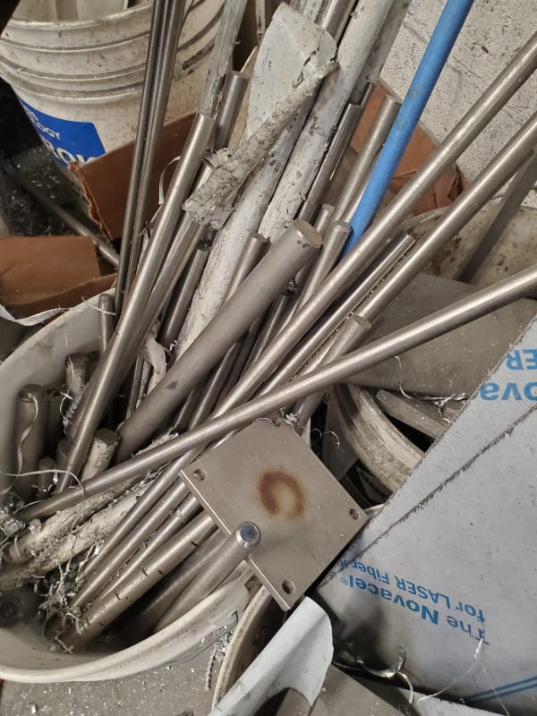

Look closely at the hand drawn sketch, on the permit application, for the "305 (Stainless ?) Steel Rods Continuous", Not three # 5 rebars as best as I can read......
Smooth Rod, and not rebar???

Yes, 5/8" 305 and 308L rods, smooth, get used like that. Here are our extras.

Demented, In my world away from Oceans and Salt Water, we would never won't to give up the deformed bar gripping strength in concrete to use stainless smooth rod? Nor the expense or loss of strength per pound of dead weight...
