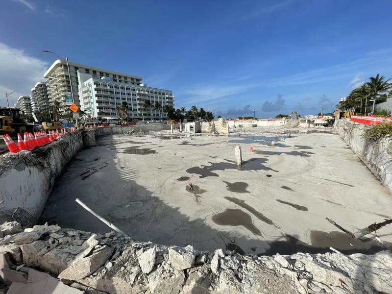

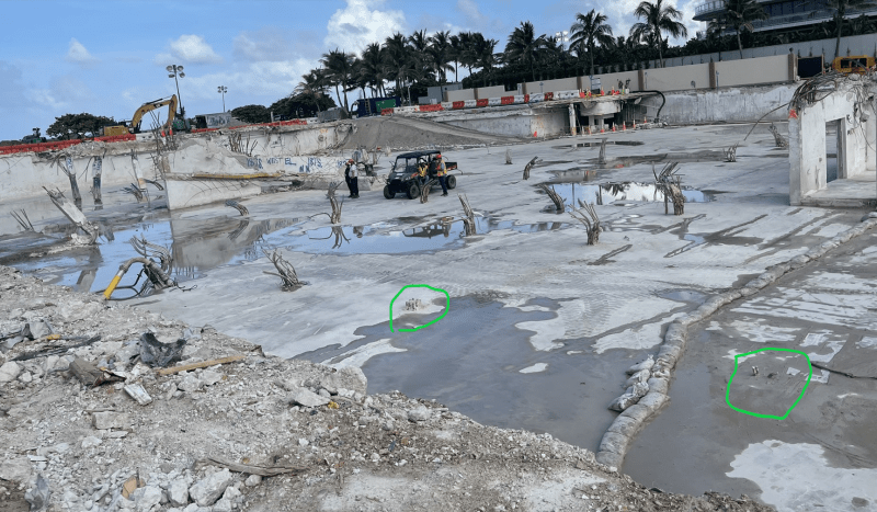

CE3527 "Best guess, those column rebar dowels were painted red so people don't trip over them."
No, I don't think so, there are many just like them all around that basin that are not painted.
Honestly, I think it's because they're tripping hazards. The other remnants are much larger / less likely to be tripped over.
Optical98 said:
Spartan and Markbob, regarding Red paint... if it does represent areas where remains were found.
Why are these 3-4 column (former columns) painted red? They are/were under what was the still standing part of the building.
Separate the operational stages. USR, Forensic, Clean-Up. The marker type and color corresponds to what stage they were placed.

Oh, thought of something... those columns marked in red.... those were the ones used for the demolition 7/4/21.
Strong possibility, they wanted it to fall in that direction.

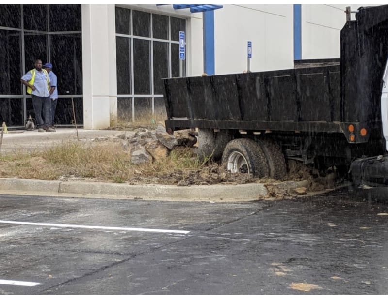

Ok here is a true story that Demented will appreciate perhaps more than anyone else. This happened in a nearby state to 'Because Florida'.
Apparently the Sub's crew decided they could make life much easier by backing over the curb and gutter in order to load their tools on flat-bed. BTW, this was a very large 'multi-state' commercial subcontractor, so not a Long Ranger Outfit..
The PM for this project left for 20 minutes to bring a burger back, and the next picture is what he saw upon arrival....

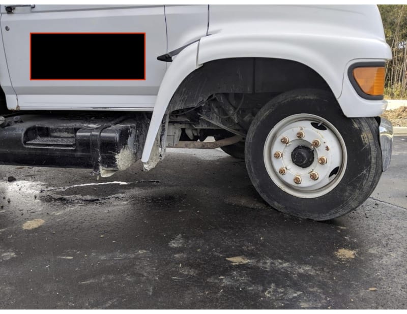

Notice anything odd about the right front wheel??
Well when he inquired as to WTF, the foremen said she/he had decided the D-9 Cat Dozer strapped to the axle of the truck would just pull it right out of that hole....
How many folks here, know why this is a bad tow point??? I think the picture explains it very well. The detached leaf spring went thru radiator, along with lots of expensive damage to this truck....
I have tried to protect the guilty by masking over the Company Name and Trade....
So let me ask, do you think we have a 'Suspect Work Force'? I know this PM very well, and this would have never happen if he had been there. I imagine they thought they would get away with it, while he was gone?
Edit: And this truck is larger than a 14000 dually F-350 Truck.....
Edit 2: I have a picture of BIG ASS Winch Arm wrecker it took to get the Truck out of the hole and to the repair shop! The D-9 was Unsuccessful....

The wheel is all the way against the bumper.. they pulled the front axel?
Oh you said that... I was looking at the pic and thinking it looks out of joint so to speak.
It probably crushed that curb too.
Optical98,
Yes that Sub had to do some concrete repair too after that stunt. Leaf Springs failed when Solid Front Axle was 'Yanked' by D-9.
Yes when pulling would not work, yanking was tried...... Truck had to be lifted out of hole....
