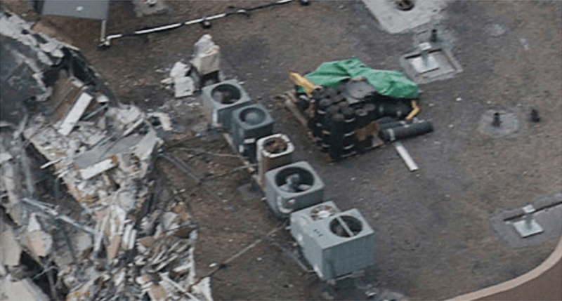

The photo of a PVC pipe with trap shown by Demented in section 08 and discussed further by Thermopile and Optical98 was really interesting because it shows that when they want to zoom in on an object in a video taken from a drone flying overhead, then they can see a 2 inch diameter object clearly enough to distinguish whether it’s a pipe or an electrical cable. Yet, they can’t see another zoomed object that is 36x36 inches square in another video.
This photo also intrigued me because of its high resolution. Not seeing Demented’s reference to the video until later, I tried to find a similar photo with the same high resolution and came up with one taken from a different perspective. And when I zoomed in on the green tarp behind the air conditioning units seen in Demented’s photo, look what I found:
It shows a green tarp covering rolls of tarpaper (aka roofing felt) on a wooden base. The rolls are almost all standing on end and there are 7 rolls in each direction, giving 49 rolls on the wooden base. On top of the rolls there is also a metal object of some sort. Since rolls of tarpaper are always 3 feet wide and one of the rolls is lying on its side, it is easy to verify that the wooden base is 6x6 feet. Depending on the thickness of the tarpaper, one roll can weigh between 35 and 85 pounds. Assuming 50 pounds per roll to be on the low side, this gives about 49x50 lbs = 2450 pounds plus the weight of the wooden base and the metal object, or about 2500 pounds, or over one ton. This corresponds to about 2500/36 ft2 = about 70 lbs/ft2. This is a heavy load on the roof of the 12th floor of the building that was still standing. If the same load was later placed on the penthouse roof with its thinner slab, then it seems like it might overload the penthouse roof and cause it to collapse. I’ll leave it for someone else to determine the maximum load for the penthouse roof and what the margin might be for collapse.
It just occurred to me that the Surfside building inspector was on the roof just the day before the collapse. Do you think he saw this high concentration of tarpaper in one area? Also, we have not seen any rolls of tarpaper on the debris pile anywhere. So, perhaps there was no similar green bag with tarpaper on the penthouse roof.

LOL Markbob, I have freely admitted to "not seeing clearly" many items on photos. I don't mind posting pics for discussion, or outright saying "what is this"?
I don't have a clue how much tar paper weighs, even looking at it on a pallet. I would venture to say if said pallet is as heavy as you say and it perhaps was sitting near a "left on" tar kettle on the eastern roof... that could be a problem. But we need to find these items on the ground at this point.

15lb tar paper is very easy to tear, so I wonder on a commercial roof would you use say 30 lb instead?

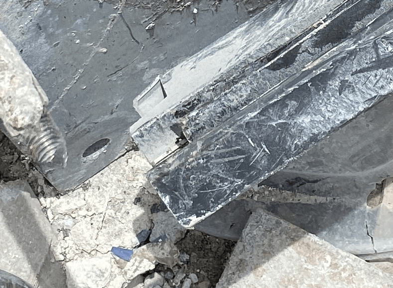

I am not above admitting I am wrong on something.
After all of this digging that led me up to a particular spot on the rough through permitted and unpermitted work, and having seen the TikTok video again not looking for anything other than to see if I could notice if the 20ft section leading to the garage collapsed.
Nothing stops a Trane.
If we have a 3/4" hole for a 5/8" anchor, what is the thickness of the roofing material? Our tar paper thickness is in there.
Edit: Uploaded original because potato upload. Find 5mm and 15mm paper.
MarkBoB2 and Demented........ Amen.....
Edit for Demented: Yes I can see the previous re-roofer, said I have an ingenious idea....... I can save the Association Money, by roofing over the old roof and cut requiring labor and disposable costs... and of course you now have a double roof!!!
I also see that threaded anchor ran out of depth of concrete it appears?
And looks like it collided with STEEL.... Wonder how that could happen??? Let's see 6" slab would mean 1/2" to 5/8" bottom rebar would be 5/8" plus 3/4" above bottom of slab. So top of rebar would be at 4-3/4" down to say 4-5/8" down if I did the math right in my head?
