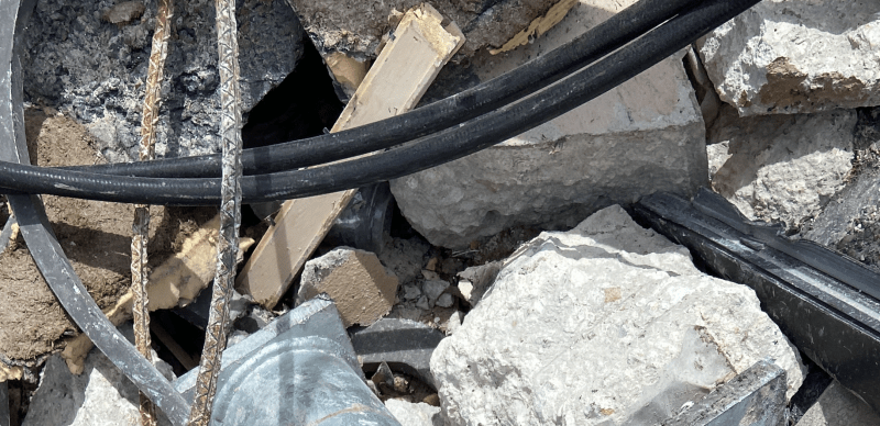

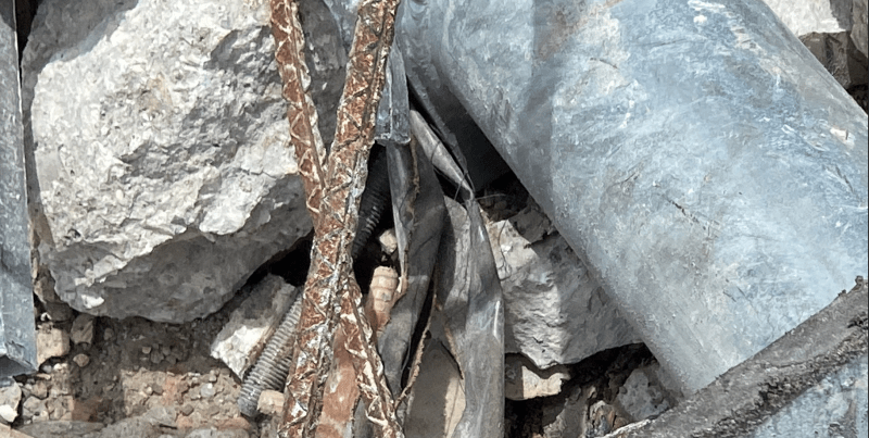

None of those pixels look like tar paper... They look like multiple layers of elastomeric roofing material?

Demented, I think that bottom black layered bit is part of a broken window frame.

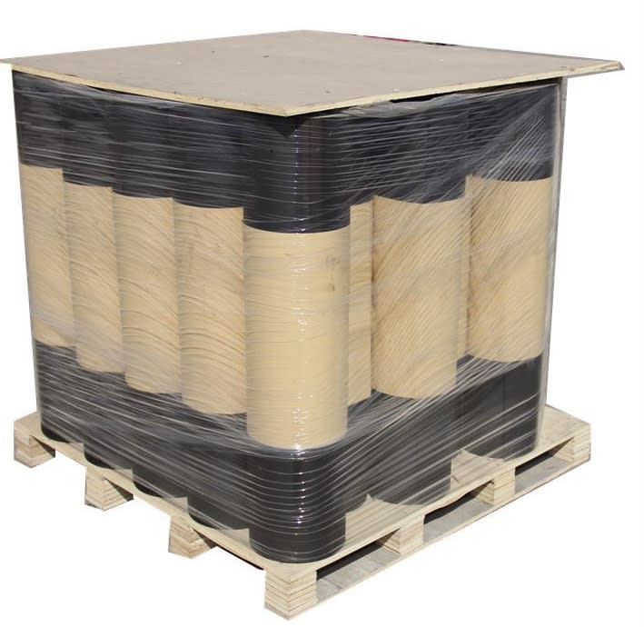

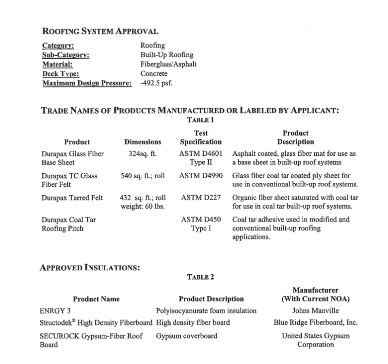

@MarkBoB2, 60lbs per roll.

20 rolls per pallet is typical for the heavier stuff.
As in the picture of the pallet on the roof above, they are 4 wide x 5 deep. I’m not sure how anyone sees 7x7.
20 per x 60# = 1,200 lb / pallet
@Optical98, I don't think it is. Next to it you can see a portion of window/door sliding frame and it is different. Layers of tar appear to be on it which I can't imagine was used along side it. This layering is also evident near the elivator shaft.

Black and white perspective indeed. It's just odd to me that we see it elsewhere in the collapse, but not there. Roof Area 2 was the only reroofing this year. Was this area recently installed with anchors? I ask because in previous threads it was speculated that weight may have been hung off an anchor above this area to load test the anchors. This was a thick roofing section per the plans. I know they weren't supposed to put anchors here, or yet at least, but their judgement in placement could have been better in places. Also, why are there instructions for full depth slab repair included in the roof anchor permit? What roofer is going to be shoring, doing full depth replacement, and epoxy injection? There are some large, rubberized hoses that can be seen near the roof anchor in the photo I posted.
Now, I have engine parts and tools all through my apartment, so I am in no position to discount someone else having what appears to be air or hydraulic lines in their unit. However, why was an air compressor recovered with roofing equipment? Seems they had gas powered sweepers and blowers, electric hammer drills and impacts. What is the air for, other than for epoxy injection?

Spartan5, the standard pallet in the roofing industry is 48x36 in. Looking at my photo above, each side is 2x36 inches. So one may conclude that the wooden base is not a standard pallet. You can easily count the rolls of tarpaper in each direction in the photo I provided. I counted 7 in each direction.
Demented, there was roofing equipment/supplies all over that roof, I think they were covering more than just section 2?
96"x48" is a pretty common pallet size used by distributors of this area. Concrete will still be on 48"x36" pallets to keep the weight down for standard forklifts. A 96x48 pallet would give you 32 rolls +/- 1. ~2000lbs.
