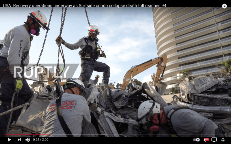

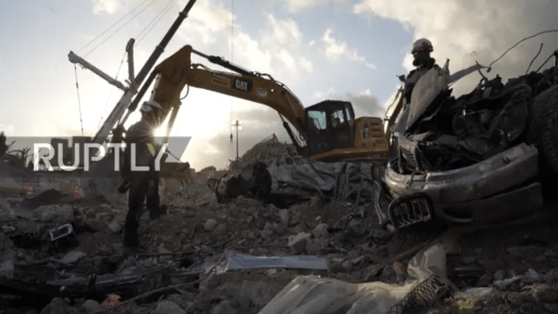

I don't know if you've watched this video or not, but they really put a lot of focus on this white vehicle. Which reminded me of our discussion on the CRV yesterday....
The 2017-2020 MDX? Yeah, I noticed it. Early morning hours, around 6:50AM-7AM that day they lifted it out. That's all I know before I had to leave for work that morning.
They were passing cars along with excavators to that spot to lift out. An assembly line of sorts. I do believe this was parked under the demo'd building, almost on top of a curb, on the top level of collapsed decking.Edit: Looks like I believe wrong.
Edit for below: Yes Thermo, Honda/Acura the same.
All hail our SAE overlords.
I think I need to go back to that world. This south Florida structural stuff scares me. Any engineers/inspectors in the area, spend a week working with a staffing firm looking for construction laborers in the area. Let the people work around you when you don't have the clipboard and badge out. They act a whole lot different around you when they think you're one of them. You'll learn a lot in just a week, and it'll help us keep stuff safe.
Demented can correct me if I am wrong, but the Logo on the Wheels of the potential white SUV is an Acura Logo, so a Honda Product

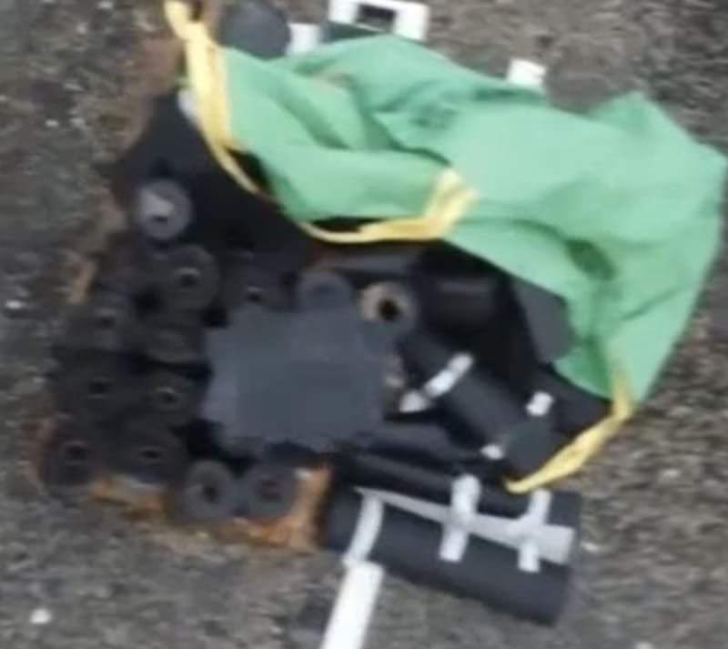

I can count 30 rolls that I can see, with 25 of them on the two left-hand skids. I assumed that the two right-hand skids carried approximately the same number. Some are covered with the bag and some have been used already. I found out that the symmetry was more like 8x6 rolls rather than 7x7 rolls.
Wow.
There are 4 rolls in the front course. You have labeled/counted them 11 times (rolls [1, 2, 7]; [5, 6, 11]; [9, 10, 14], and [13, 30].
There is no right hand skid. There are a few rolls that tipped off the skid in the foreground.
Is anyone else seeing this? One of us is in crazy town.
I move that we add this picture to the spreadsheet and have everyone count the number of rolls of tar paper that can be seen. This will provide a measure of credibility to the various theories/interpretations.

Not a Honda/Acura. Is that a Porsche in the pool?
Edit: Yup. I remember people talking about it. Cars with leaking fuel were put in the pool if I am not mistaken. There was an issue with the recovery igniting fires once they got to the garage level because of fuel leakage. Other than here, I have seen/heard nothing about a car hitting a column, if thats where this is headed.
Are we really going to argue whether there are 20 or 30 rolls of tar paper on a pallet?

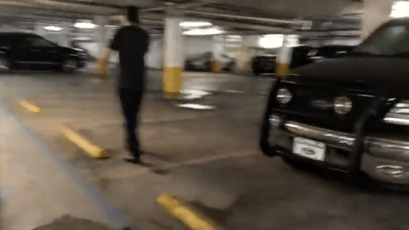

I think I can pinpoint the location of that white MDX, or at least offer a point of reference that helps us find the location of the camera within the site. Assuming many things (it was not moved, parking spots did not change):
at 0:07 of the video you can see the front clip of a 2000s Ford Expedition, with an aftermarket bumper guard
The exact same vehicle is visible in the walkaround of 611 just before they reach the ramp area:
Well that's interesting.

And an additional 10 rolls is 600lbs and very relevant to the idea of it being used to load test a newly installed anchor.
Probably not in this thread. WAGs rule the day.
Demented, not sure where they pulled it from, it doesn't look as crushed as many we've seen tho.
vs tying off between two anchors and using them to load each other. As we determined elsewhere in the thread.
These rolls are most central to the cockamamie idea that rolling tar paper burst through the parapet wall after the roof partially collapsed due to hammer drilling for Hilti bolts for roof anchors… said tar paper rolls then plummeting to the ground with wayward ac units and tar buggies, crashing through the patio deck ultimately causing the collapse of the entire building. Don’t you remember the tar paper rolls being identified in the TikTok video of the garage collapse?
Pretty sure it’s the same people that could see 7x7 rolls on that pallet as would attest that they can see them in the basement as well.
Well maybe the AI software that someone used before could fill that pallet out? Give you a more accurate count?
@Spartan5
Oh I do agree it's silly and stupid. What roofing crew are you going to find that's going to lift a 2,000lb pallet over a wall and drop it? Yeah, good luck with that. You'll find that just as easily as you'll find a day crew in FL that does not have at least 2 come alongs on the truck and 10 on order with Merchant Metals or Wurth. If anyone is going to load test it, it's not the workers, it's going to be 1, 2, or 3 of the SI's doing it on site. You can't even trust the $10/h laborers to read a tape measurer accurately, let alone know what load testing is. Skilled labor is hard to come by these days.
