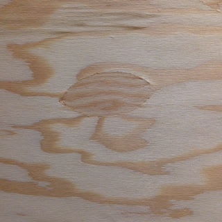

I am just curious if this is, what process would have been done to leave this shape of a mortar patch? They're too uniform for it to be by hand one would think. Would a template be used in this process?
Ooooh look at all those repairs, I bet those beams are like Swiss cheese on the inside.
Actually, it looks like those are simply imprints of the patches that were used to fill the knots in the plywood that were used for the forms.

Thank you for answering my question though. If those were repairs, they held up good. Would have been pretty damning evidence against concrete repairs.

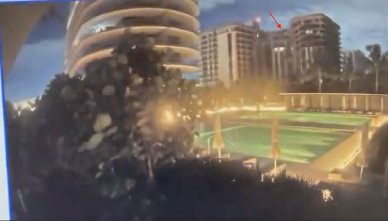

This black area the red arrow is pointing to is troubling to me. It looks like part of the very large PH balcony has fallen and we are looking at black roof in this area and not vertical PH parapet. Hinged slab near sliding door wall.

Would this be indicative of a column repair location? I am not concerned with the cracking as I wouldn't be surprised for this to be related to the removal. I am just curious if this is, what process would have been done to leave this shape of a mortar patch? They're too uniform for it to be by hand one would think. Would a template be used in this process?
Since they appear shallow and aren't broken off, my vote would be for knots in the plywood formwork. These would be limited to a single-ply depth. The roughness of them further advances this theory in that the inner plys of plywood aren't sanded smooth before gluing.
It's an artifact of taking a video of an LCD screen. The missing white up top is compensated for by the missing black right below, indicating the LCD was in the middle of a transition. The detectives must have the original feed and just haven't released to the public.
