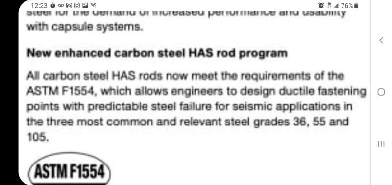

Wait, why did they use 12"x3/4" carbon steel Hit-Z's?

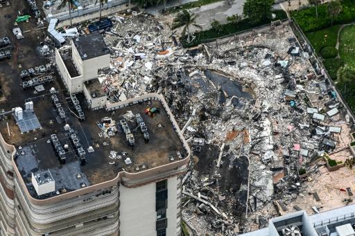

The epoxy injection machine was on the roof, for the anchors, unless they neglected to inject epoxy into the drilles holes. Although I do admit I have seen no evidence of repair work, I have seen evidence that the equipment, materials, plans, and ok for major concrete structural repair were on the roof the day before the collapse. That is a red flag. Even if it didn't cause or play into the collapse at all, the work surrounding them is best negligent and processes need to be in place to punish, not reward those who work in such ways.

I straight up assumed 5/8" all-thread epoxy bolts were what was called out after seeing that is what was used (or possibly sheared off wedge anchors. It's "still" all thread).

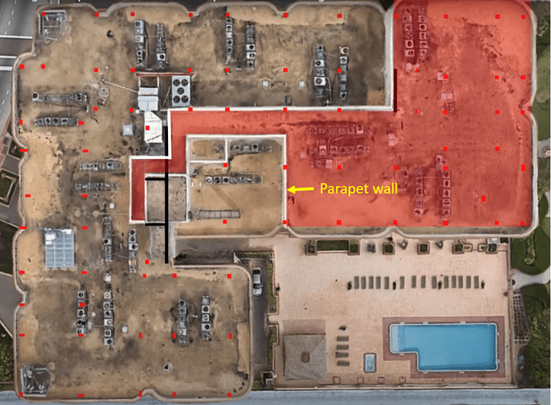

Can anyone tell me how a roofer would get tarpaper, anchors, and tools like sweepers down onto the roof of the middle section of the building below? The photo shows the penthouse roof highlighted in red. Surrounding the middle section of the 12th floor roof one floor below the penthouse roof is a 4 foot high parapet. I have not been able to find a door to this center section in any rooftop photos even though the drawings show a door in the upper left corner. But even if there is a door, roofers would need to get materials from the penthouse roof over this parapet and down to this area one floor below. It seems to me the only way to do this is by using a davit hoist. This means that a davit hoist was on the roof along with sufficient ballast weights to stabilize the hoist while raising one roll of tarpaper or a sweeper. Could this explain why two hexagonal-shaped weights were found on the debris pile close to column 27?

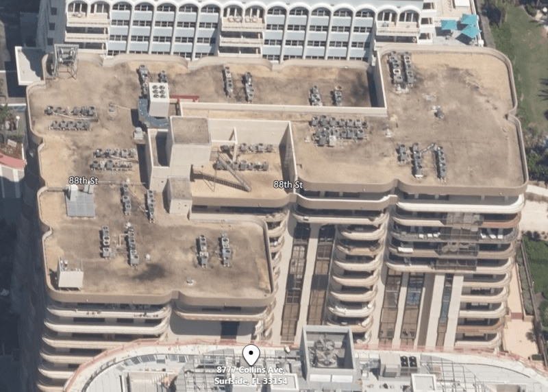

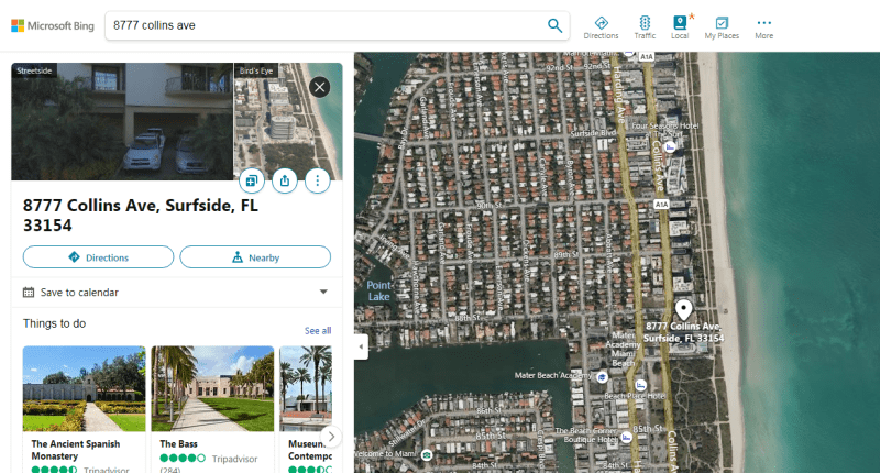

Don't know the answer to your question but I wanted to point out that Bing Maps has true aerial views that provide more detail than Google's mushy 3D:
Don't know if this link will work:
Bing maps 8777 Collins
You can get here by searching for the address in Bing Maps and clicking the "bird's eye view". There is a compass at lower right that allows you to rotate the view around.
It is beneath the elevator machine room, according to the plans, so hidden from most external angles. Given that the machine room access stairs are on that section of roof, it's very unlikely that the door was omitted; far more likely it's just hidden from view by the machine room. The machine room has to be easily accessed by both mechanics and firefighters.

Thank you, rodface, for the link to Bing maps and for the instructions on how to get a "bird's eye" view. I had tried for weeks to find this, but gave up thinking one had to pay somehow.
And thank you, Thermopile, for the photos of a roof hoist. It doesn't make much difference to me what the hoist looks like. I am more interested in knowing whether one existed on the roof at the time, and whether it required hexagonally shaped weights for ballast. The weights found near column 27 were hexagonally-shaped and were on rods like the weights shown in the photo you posted. Thermopile, can you please repost the photo of the roof hoist with weights that you once showed, but then the removed?
By the way, also found near column 27 was an unmounted davit base that looks like an OSHA anchor, but has a hollow tube held up with three triangular flanges welded to the tube and the base. This may mean that the roofers had not yet installed the davit base, or that some other hoist design was used instead, such as the one you identified.
