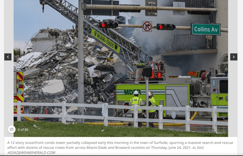

"That fire didn’t begin until the Sunday following..."
There was smoke on day one and evidence of fire as well
None of those images are from day one. The first image was taken on June 27, just after the “deep fire” broke out. The latter two were taken several days after. I don’t believe the media was briefed on the exact source beyond crushed Li-Ion batteries. I was told by several sources who were on site, a Tesla was parked next to the MKIV Supra visible in the MDFD garage video.

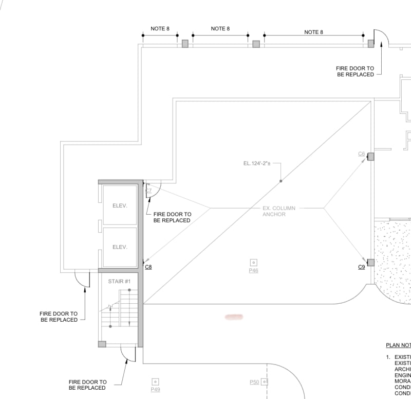

Well lo and behold, there is a permanent ladder down from the penthouse roof to the middle section of the 12th floor roof. This is the only way for a roofer to access this part of the roof. There are no doors to this part of the roof
There was a door.
MarkBoB2 said:
There are no doors to this part of the roof.
That's very likely untrue. The fact you've not found a photo showing the door proves nothing. The door is underneath the elevator machine room overhang, according to the plans, so not visible from most angles. Given the need for easy access to the machine room, it's highly unlikely they would have omitted or removed that door. It's also a fire safety thing, as firefighters must be able to easily access the machines for rescue purposes.
Santosi81 and Murph 9000, I agree with you. I was misled by the overhang of the elevator room.

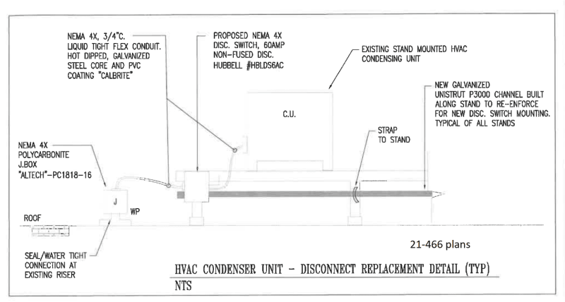

Don't know where exactly they mounted this, or how to those columns/beam, but this may explain the tearout on the side if the column.
Trying to find an explanation for the trunnion shaped tearout we see on these columns. My thinking is the unit was anchored via wire cable and ripped the whole damn assembly off in the collapse. Huge holes for what it'd be, but i can't really see even a 1/4" tapcon not doing decent damage when driven by hammer drill or impact on suspect concrete.
@ Thermopile. What do those anchors and the installation have to do with the collapse anyway? Is the thought they used the wrong anchor and it collapsed?
2021-466-plans.pdf that they released. It's the electrical work plans for the roof that was going on along side the roof repair and anchor installation. Seems just simply disconnecting and reconnecting work around the roofers for safety, but replacing damaged or broken things and fixing wiring issues before reconnecting it. Passed it up as simply one of the most normal looking plans on this building. Page E3.
I still have my doubts about this causing the tearout we see though, but work was likely done drilling in that exact location. Would they have used the same 3/4" anchors? I'd highly doubt that, but I've never dealt with unistrut. Looks like a poor man's v block.

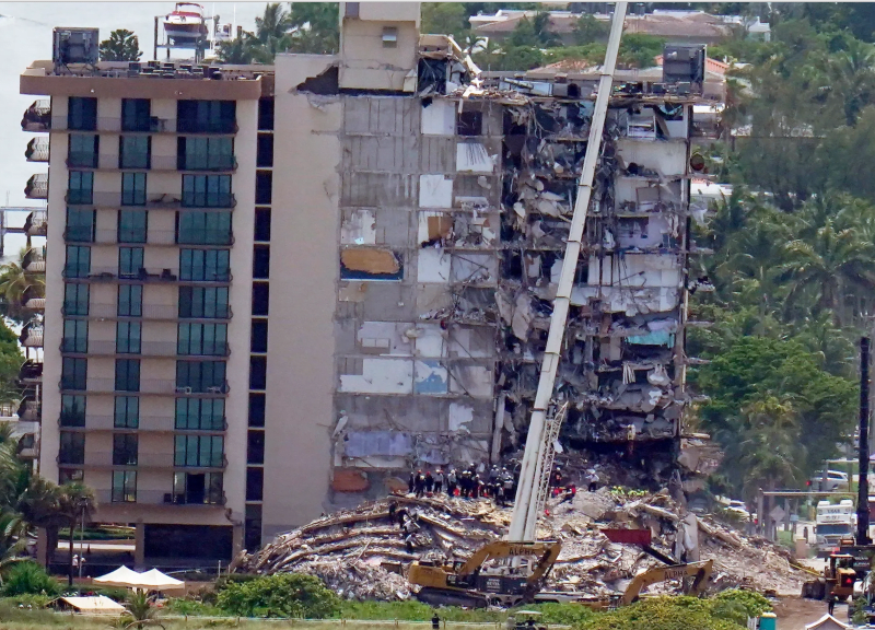

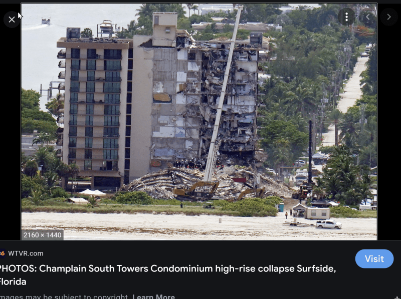

Demented,
I'm just trying to help the Roof Team with their hypothesis...
10 extra rolls of tar paper, a Boat and a Tar Kettle.... go on Spar you do this better than me ;)
j/k y'all
Edit: Photo source WTVR.com
Now you guys are blaming the electricians? Do you really think we would use a 60 amp three phase disconnect for residential AC units? Mount unistrut with 3/4 inch anchors to a concrete column? LOL.
LOL.

@Nukeman, I aint blamin' the sparky's either. I'm pretty damn sure I was in the middle of poking a hole in one of my own theories. Well not really, but just removing a large portion of what could have been a previous but failed structural repair. You can shoot yourself in the foot and still win a marathon technically. Just damn near impossible at that point.
all sitting on one spot. Although that does show how close the bay is at that point. Not so much for East and North towers.... In case anyone has not looked at a map.
