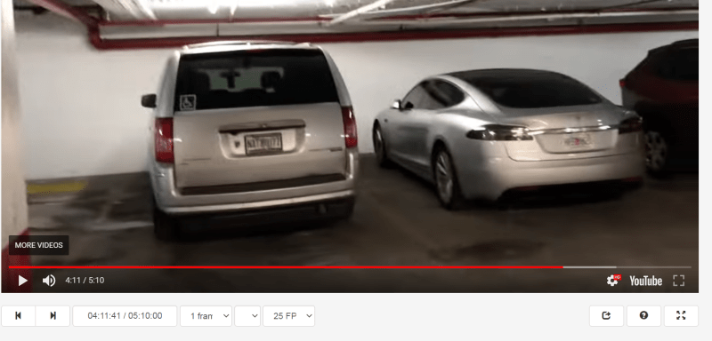

Regarding the "sulfur" or "heavy metals" odors, I thought I read somewhere that a Tesla in the garage had caught fire as a result of the collapse. I'm guessing it would be the batteries that were on fire and perhaps the source of the odors.

Link your source please.
Why would a Tesla smell any different when burning?
The dramatic fire from a Tesla is from the traction battery pack. I don't know the exact chemistry Tesla use, but the electrolyte is going to be a lithium salt dissolved in an organic solvent, with thin aluminium and copper foil electrodes, a metal (some combination of lithium with cobalt, manganese, and nickel) oxide paste on the cathode, and graphite on the anode. That's the typical contents of a lithium-ion cell, and despite Musk's flashy press events, I'm pretty sure they are mostly just standard Panasonic cells for now (produced by Tesla, with only minor customisation). It's going to be generating interesting gasses.

What are you the Source for? I asked for a source on there being a Tesla in the garage.

Please add your source of that a Tesla was in the garage.
I didn't claim there was one there. You asked why a Tesla fire might smell different, I gave you a rough summary of the chemistry found in the giant battery pack, which could possibly generate some odd smells.

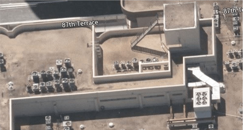

Well lo and behold, there is a permanent ladder down from the penthouse roof to the middle section of the 12th floor roof. This is the only way for a roofer to access this part of the roof. There are no doors to this part of the roof. This means that a davit hoist (aka, roof hoist) was necessary to get materials down to this section of the 12th floor roof. Thank you again, rodface, for the Bing imagery.

Cheers. I can't figure out the routes that one would take to get to various parts of the roof. Are those large stairs accessed from *inside* the building, or are they an access from the *outside*? Haven't looked at the new plan set in a while, perhaps it makes it clear.

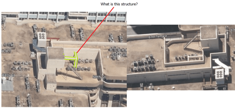

Also, apologies if this was covered before, but what is the purpose of the open concrete (?) structure on that area of roof? Highlighted green below. It almost looks like an afterthought. Is it somehow bracing that part of the enclosed passageway?
