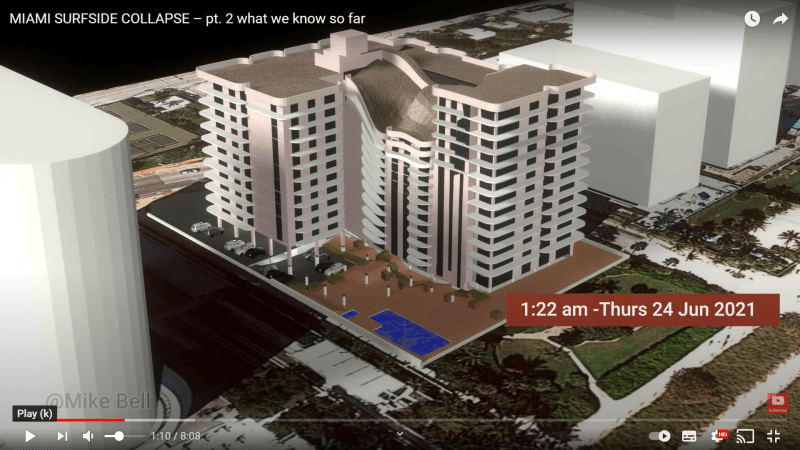

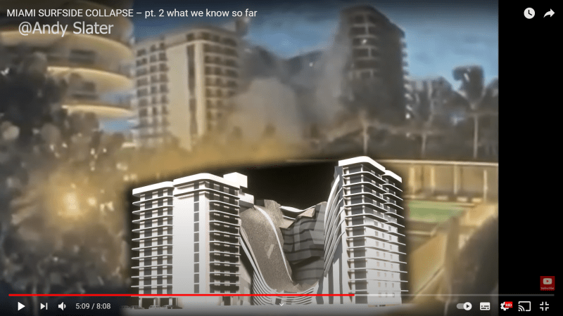

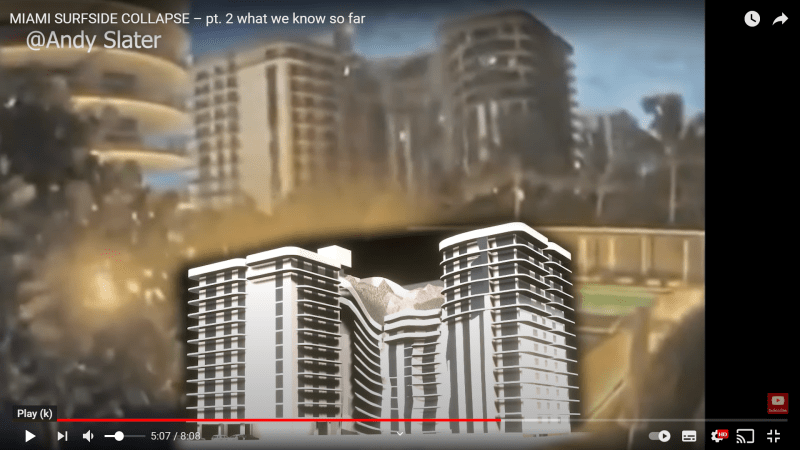

MaudSTL said:
South African Architect Mike Bell has published a new simulation with narration.
For those who won't open up YouTube to watch the video. Btw, you should; it is short, but packed with good visuals. I think this simulation of the collapse agrees well with the security cam video, without the need for a collapse starting at the roof area.
