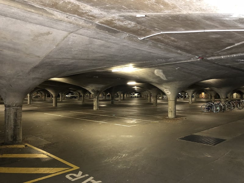

So, here is a unique parking garage. It's South Lawn in Melbourne. And each column is shaped like this to support a tree above it. The tree's are perfectly positioned above each column and there is a lawn above the garage. It's very unique and I felt that it was a good example given other examples. It's constructed 10 years before CTS. It's old but still in good condition.
AutisticBez - that looks like the building a structural engineer designed after reading an article on shear punch failure of column slab connections.
