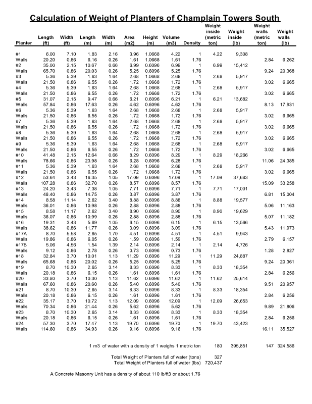

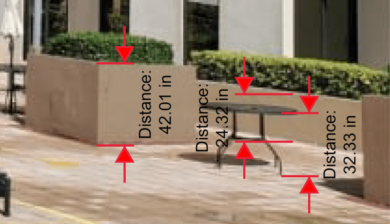

I tried to recalculate the weight of the planters full of water as well as the walls. This time I tried to estimate the height of the planters a little better. I came up with an estimate of 42 in for the big square ones and 24 in for the lower and longer ones. I also missed some. In this calculation I am including ALL the planters, whereas before I had only included the weight of the planters in the collapsed section (although I missed some).

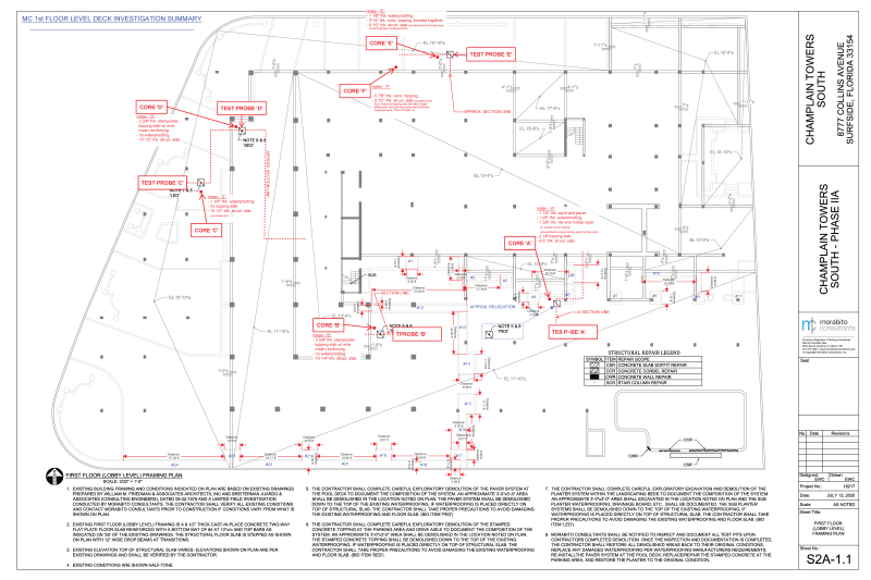

As before, I used the measurement feature in Acrobat. One can scale the pdf to the drawing. Unfortunately, the scaling does not seem to get saved with the file. It appears to be a per session feature. I used a drawing that had been submitted as part of the minutes of the Board of Directors of the CTS condo association on Oct 14, 2020. It is an 83 page document that was posted here, but I did not save the url. My apologies. The drawing I used was on page 43.
I extracted it and was able to remove the photos that had obscured what appear to be the drawings of the planters as of that date. The drawing was done by Morabito Consultants, bears a date of July 13, 2020, is titled First Floor (Lobby Level) Framing Plan and is identified as Sheet S2A-1.1. I have identified the planters with as #1, #2, etc. in blue. I scaled the drawing based on the 6 foot dimension for planter no. 1 (I hope this was a planter!), based on a dimension marked on some other blueprint. Building Integrity mentioned that he could not find a drawing of the planters, so I thought I would try to contribute this drawing to the mystery.
The dimensions of the planters are in red with the dimension itself in black. The scaling I used in the Acrobat session to make the dimension notations was 1 in to 13.73 ft. The original size of the drawing is 36 in by 24 in. I am (hopefully) attaching the cleaned up and annotated copy herewith with full resolution. I am also going to try to embed a lower resolution version.
I am also attaching and embedding (with luck) a pdf of my calculations so that somebody can check them. The planters appear to be much heavier than I previously thought. Based on Morabito's blueprint, the walls of the planters appear to be about 10 inches thick. That may or may not be accurate. I assumed the walls were constructed with CMUs. Maybe they weren't or maybe they were thinner, but this is a start anyway.
The total calculated weight of the planters completely empty is about 147 metric tons or almost 325,000 lbs. It was reported that it had been raining heavily. If the planters were full of water, then the weight would have increased by another 180 metric tons or close to 400,000 lbs for a total weight full of water calculated at close to 330 metric tons or over 700,000 lbs! Did I make a mistake somewhere? It's late and that may be. Hopefully somebody can point it out to me.
I can only submit one file at a time, so here is the full resolutions pdf of the drawing.
I assumed that the height of the table was 32 in. I ignored errors caused by perspective.
The 4x8 planters as they were called were modified to 1.143m high around the same time the weep holes were plugged.

@IEGeezer - I need to look more closely at your plan and calcs, but I'm assuming you're going with a maximum possible water weight for the planters by volume? They appeared to be fairly filled-out with dirt and vegetation, and most likely pretty saturated with water. I'm curious whether planters full of dirt, dense shrubs, and water would actually weigh more than the volume of water alone?
I remember the discussion on the core samples and slab composition, but without going through the 10 previous threads, I don't recall if there was an idea of just how much water the slab components may have been holding?
It's going to be interesting to see what the verdict is down the line as far as just how overstressed the pool deck ended up. Original weight of materials plus additional layer of sand and pavers, planters full of vegetation, undernourished slab, lack of/failed waterproofing / trapped water, the occasional likely overweight vehicular intrusion, improper repairs (still wondering where that mystery partial slab replacement was)...am I missing anything?

Regarding the planters… I’m a bit surprised by some of the musings.
Water alone is about 60 lb/ft3
Dry soil about 100-115 lb/ft3
Saturated soil 115-130 lb/ft3
I think they often use lightweight closed cell geofoams in the bottoms of planters to elevate the vegetation without adding weight.
I agree. It is not like water will add another 64.4 lb/ft3. A soil saturated with water just has air pockets filled with water and this depends on the void ratio of the soil. Good clarification there.

This is what I was getting at, and articulated very poorly, my apologies. Taking @IEGeezer's calculations for water volume, and comparing that weight to potential planter configurations (very heavy if the whole thing is full of dirt and plants, not so much if there's an internal platform to optimize space and weight, and how those would compare to his numbers).
Thanks for the numbers @Spartan5, I never did much in the way of "fun" landscape design, most of the projects I worked on in site civil were institutional and as such the landscaping components were mostly related to erosion control. I should really go back and look at the related details from the original plans. The Morabito details seemed to imply the new planters would be full-depth soil but I didn't really look very hard so I'm probably mistaken.
That would be about 45 inches tall. Where did you get that the big planters were 4 ft by 8 ft. In this picture, they look roughly square as they do in the Morabito Consultants drawing I referenced.

To make it easier to compare to my calculations:
60 lb/ft3 is about 0.96 kg/L
64.4 lb/ft3 is about 1.03 kg/L
100 lb/ft3 is about 1.60 kg/L
115 lb/ft3 is about 1.84 kg/L and
130 lb/ft3 is about 2.08 kg/L
