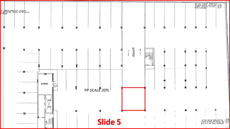

A graphic tool for analyzing the debris pile with red paint on objects located at the bottom of the resident parking garage ramp.
With glossy photographs with circles and arrows and a paragraph on the back.
(Oh No, Not another powerpointy du-da)
from the 1979 plans, the location of approximate square of columns.
Overheads_of_debris_pile_at_end_of_ramp__zoom_with_slide_in_lower_RH_corner_-_5_ofq53b.jpg

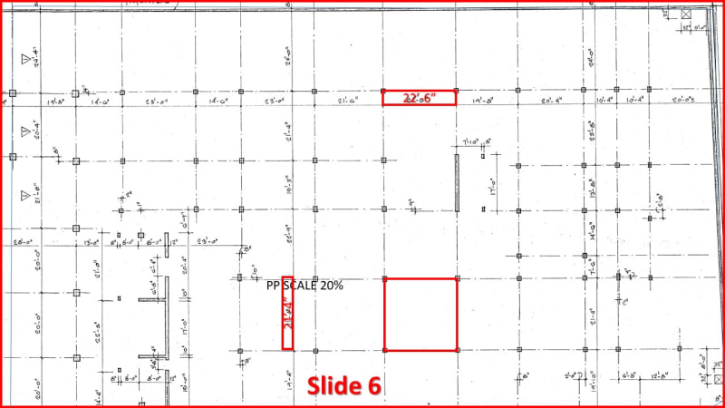

1979 dimensions of approximate square of columns.
Overheads_of_debris_pile_at_end_of_ramp__zoom_with_slide_in_lower_RH_corner_-6_rps6x3.jpg

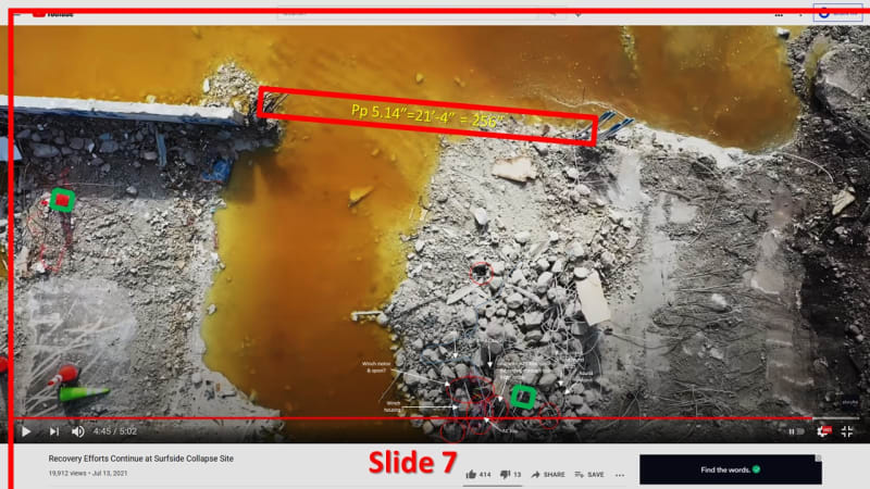

Rectangle showing the 1979 dimensions on the outtake from the video.
Overheads_of_debris_pile_at_end_of_ramp__zoom_with_slide_in_lower_RH_corner_-_7_rvvkdf.jpg

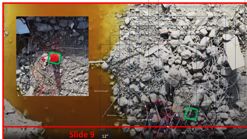

zoomed in on the pile overlain with a one foot grid in blue.
Overheads_of_debris_pile_at_end_of_ramp__zoom_with_slide_in_lower_RH_corner_-_9_lqk0hk.jpg
Not to put too fine a point on it, the objects in the pile are small.
Overheads_of_debris_pile_at_end_of_ramp__zoom_with_slide_in_lower_RH_corner_-_10_gdo9rk.jpg
SFCharlie, Thank you for all your work above. I agree with the scale you show. But your green square doesn't agree with any of the objects that I have identified. The downward-pointing arrow to the left of your green square is what I have believed to be an AC condenser. And the arrow below it pointing to the 11:00 o'clock position I believed to be the top of the AC. Both of these objects are tilted, so it is difficult to get a good idea of their dimensions. But I agree that they are smaller than I expected. I measured that the diagonal of the top was about 20 inches. And I measured that the diagonal of the condenser was about 22 inches, with a hole about 10 inches in diameter. This probably means that this object is not an AC. Do you have any ideas of what it may be?
Your very welcome. I just do it for the fun of it...
The green square is the size of the base of one of the traffic cones. I largest traffic cone I found on google was 36" high and 14" square at the base.
edit: I agree, they are probably not part of an air conditioner. If I were you, I would use power point to draw lines or arcs to show the edges on the objects. I use the rotate shape to align the pp shape with the image. Also, after selecting a shape, I use "shape format" to "edit shape">"edit points" to get everything to line up. Sometimes this helps my mind recognize stuff.
SFCharlie, I agree with your cone dimensions. This was how I estimated the dimensions above, by comparing them to the cone dimensions.

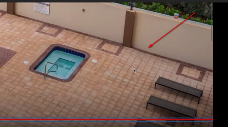

MechinNC said:
If that patio slab was so degraded that punch through could happen, would you not expect to see deformation on the upper slab surface
A YT channel named Construction Engineering & Failure Analysis ( talks about this. You can actually see what looks like deformation in the pool deck in some of the photos. Or maybe it was designed that way for drainage.
Maybe that deserves a second look.
The tile installation would not have been so abrubt while the weight of the installation could have set that off in the days/months after.
When Demented was looking thru all the maintenance and repairs, one was the tear out of the pool gutter system and installing a new gutter system which appeared to be higher in elevation than the original one. I think when the raised the perimeter of the pool and hot tub, they added probably more sand to raise the patio tiles to match the elevation of the pool and tapered the deck from new pool curb height into the rest of the patio deck. I know in some pictures I have seen, way back in this long thread, it looked clearly like the area around the pool and hot tub was higher elevation, and tapered back into the rest of the paver level on patio deck side of the pool.
I don't think what you are seeing is structural deformations below.
Perhaps Demented has the info handy to confirm my memory?
