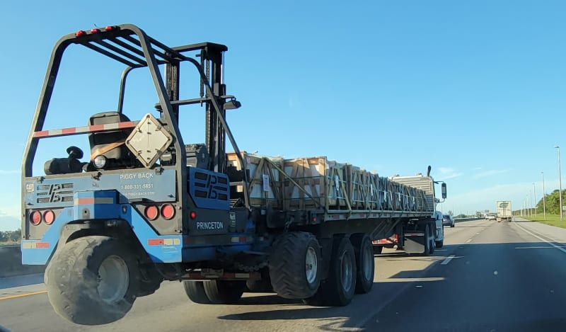

Also, here's how a forklift would get onto the pool deck:
Method 1: Long bed truck with forklift hanging off back parks on Collins Ave in front of the building. Driver with forklift drives all pallets of bricks over the above-ground parking deck east toward the pool fence, then they open both gates and it drives on the pool deck, and distributes the pallets all over. Probably done in 30 minutes, these guys are in and out fast. I have never seen them stay at any of my sites longer than 15 minutes.
Method #2: Boom truck pulls up on 77th alongside the pool and lifts pallets over the wall and sets them down by the jacuzzi. Then forklift or pallet jacks are used to move the pallets into their positions around the pool deck.
Method #3 (Less Likely): Long bed truck parks on NW 88 St on the northside of building and forklift is used to drive the pallets south along the east border of the property until they encounter the gate, and they have to remove the 2 gate panels on either side of the gate to fit the forklift through.
. I spotted this typical long bed delivery truck the other day, on its way to drop off pallets of tile at the customer. Note they only use forklifts. This is what I receive at all my sites, dropping off tile, paver bricks, or wood flooring and 16ft baseboards.
