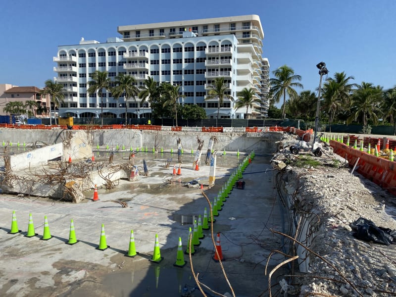

Speaking of triggers and collapse sequence, the NYT infographic implies a lot stronger collapse sequence than the Witness Timeline supports. So I think it’s a good idea to take the NYT’s lede and numbering with a big grain of salt.
For example, the first surviving witnesses who saw that the deck collapse as it happened actually saw it from the lobby. From their perspective in the lobby, the parking deck had collapsed, which corresponds to No. 5 on the NYT infographic. Just because the NYT leads with the palm trees and planters on the pool deck (Nos. 1 through 4) doesn’t necessarily mean that’s where the deck collapse actually initiated.
In other words, at this time, based on witness statements, we don’t know the sequence in which the deck collapsed.
I'm pretty sure the numbering the NYT used was just intended to link the captions to their respective locations on the building image and were not intended to be used as a sequence of events.
Stay safe and make sure to hit that subscribe button Folks. You don't want to miss out on all the cool deals that pay my bills.
What is likely to give the readers a false impression is this lede (and the four items that follow it:)
It’s just not an accurate claim in relation to the Witness Timeline.
You did an excellent job on the timeline, however, the pool deck is the first thing to fall that was confirmed by eyewitness accounts as a collapse. The earlier sounds could be dismissed as construction noises or the building creaking and failing. I fully understand your point but there is still room for errors either way as far as what actually fell first.
Edit to add: The numbers seem to be random as they are listing the "...11 Serious Flaws Discovered...". If they were trying to keep the flaws in order of the sequence they occurred, Design flaws should be listed before building flaws, followed by maintenance issues like tree roots and water damage.
Thanks for posting the 2 files @SFcharlie. I figure the pool deck collapsed in phases, first what Sara Nir saw at the above-ground parking deck, her only vantage point, then maybe it cascaded toward the building from there, or maybe it all fell at once before the building did. I am miffed that NYT obviously used stuff from my July videos without giving me credit. For example, I clearly showed in my videos the difference in removed palm trees from May to December 2017 and showed how I stepped through all the annual sat photos to determine that, and I showed a very similar drawing of the drain slope on the pool deck.
Although, they left out what else I showed, how the 2" of sand under the pavers holds a lot of water at 8.3 pounds per gallon, not figured by the architect or engineer, who could not forsee a 1996 addition of planters and 20-foot palm trees. Furthermore, I showed how forklifts would bring in pallets of pavers and likely set them down, causing more stress to the pool deck, and possible latent fractures. Remember their article was published the first week of September after many of us were already discussing these items.
Thank you. Yes, that is my point. Eyewitnesses Sarah Nir and Shamoka Furman saw the parking deck collapse from the lobby. They did not realize that the pool deck had collapsed because they did not see it from the lobby. After they ran out of the lobby door, Gabe Nir and Nicolas Vazquez realized that the parking deck had collapsed. Neither of them realized at that time that the pool deck had collapsed, as they were too busy trying to escape from the building as it rumbled and shifted. Only after the collapse, when she accessed the pool deck to help Ileana Monteagudo (611) and others escape from the garage level, did Shamoka Furman realize the pool deck had collapsed. >>>>>Edit: This is why Shamoka’s 911 calls all report that the garage had collapse.
We don’t know where the deck collapsed first. We only know from the witness statements that the parking deck collapse was witnessed from the lobby, and that the pool deck collapse was not witnessed until after it had already collapsed, by the late Cassie Stratton in 410. >>>>>Edit: The later 911 call that reports the pool deck collapse is from the surviving part of the building, where the caller could not have seen the garage deck. So that too was well after the fact and implies no deck collapse sequence.
This is why I object to the NYT lede. There is no eyewitness account of the pool deck in the process of collapsing. There is no eyewitness account to help establish a deck collapse sequence.

From the witness statement perspective, there are clues about where the building began to collapse, but no mention of a specific triggering event. As Chani Nir (111) stated, “banging” sounds were occurring when she got home at 11 PM. We don’t know when they actually started, and we don’t know if these sounds were also heard in the lobby or elsewhere, higher in the building.
As Sarah Nir (111) and Shamoka Furman (lobby) stated, at 1:10 AM there was a loud “smash” that was heard in both 111 and the lobby. If something fell in the garage rather than in a floor above, for example, it was not mentioned by Nicolas Vazquez, who arrived in the garage with his wife Gimena Accardi around that time.
So we have no eyewitness accounts of a triggering event per se. Prior to the building collapse at 1:22 AM, we only know from witness statements that:
[ol 1]
[li]The late Elena Blasser (1211) reported unusual loud cracking sounds occurred at 3-4:00 AM[/li]
[li]The building was already shifting its load at 11 PM[/li]
[li]Something fell at 1:10 AM that could be heard on the first floor[/li]
[li]The parking deck collapsed at ~1:15 AM[/li]
[li]From Adriana Sarmiento’s 1:18 AM video, there was debris and possibly Column M11.1 was damaged or collapsed in the garage[/li]
[li]From reports of the late Cassie Stratton’s (410) call just before 1:22 AM, that the pool deck had collapsed[/li]
[/ol]
