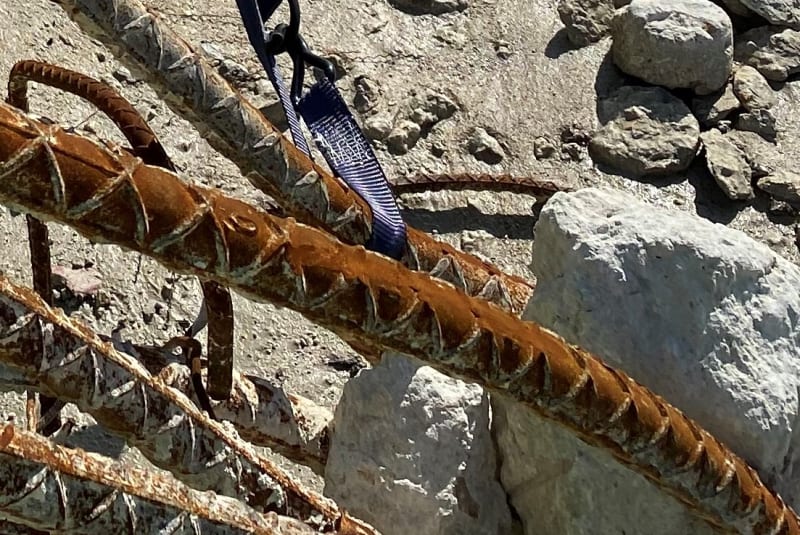

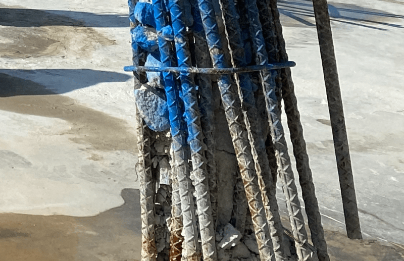

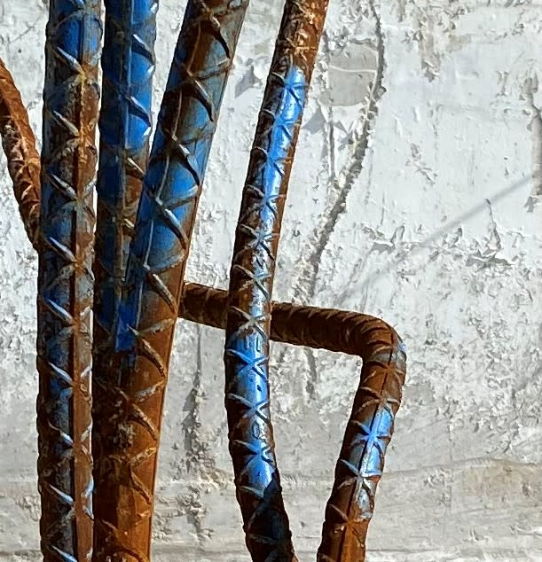

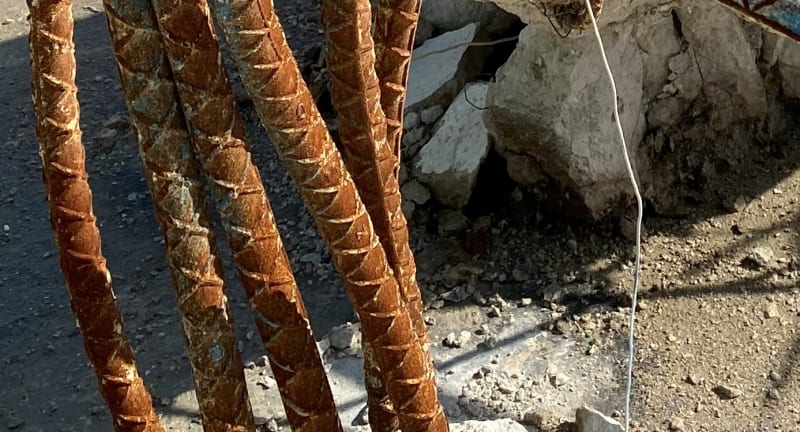

Did anyone ever find grade marks on photos of the column steel?
I can’t find any indication of 60 grade steel as specified in the drawings.
Sorry if I missed it.
That's a mighty fine question you have there. Mighty fine indeed. Thanks for steering us back on track.
Mr. Kilsheimer's pics are probably the best we have.
See here:
I don't know enough about the markings to be certain but there may be a few issues here.
Image 307, looks like o 11 n or n 11 o and no other marks that are legible.
Image 292 confirms 307.
Image 280 is... Ohh... Hmmmm...Looks like someone used a grinder to delete some of the information here. You can check out the Grinder website if you're into that.
Stay safe and make sure to hit that subscribe button Folks. You don't want to miss out on all the cool deals that pay my bills.
New billet #11 grade 40 or 50 mild steel, most likely grade 40.
That's O - 11 - N.
This would indicate Type N, Size #11, manufactured by Marion Steel in Marion, OH. Note that Marion steel is part of Nucor now, but was not in 1981.
Type N is an obsolete standard. Previous versions of ASTM A 615 captured two types of billet steel for use in the manufacturing of concrete reinforcement. Type S was a set of more stringent supplementary requirements, type N was the 'minimum'. At some point, Type S was rolled into the main spec, and the supplementary requirements were struck from the standard. Type N went away as a designation. I don't know exactly when this happened but I believe it was some time in the 80s.
1984.
My concern is that the time of instruction Champlain Towers South both 40 grade and 60 grade steel was available and commonly used.
Threshold inspection did not exist yet and the contractor sometimes bought 40 grade steel because it was cheaper.
Not saying it happened here , I would just like to see a grade mark indicating 60 grade steel on a column bar so that potential problem could be eliminated.

The pictures from Kilsheimer are not the best, but still good enough to kinda make out N 11 0 on a few more bars. There's more grinding marks I've seen but nothing clear enough to say it's numbers ground off. There does appear to be a lot of single grade lines extending 5 spaces beyond the blurry letters/numbers. Even that ground off section above.
So, grade 400?
Also looking down the N columns for example, I'm still seeing the #11 bars. Shouldn't these be #7's?
Please correct me if I'm wrong.
The only way to totally eliminate that possibility is to examine every single piece of rebar. What we have seen doesn't look good.
