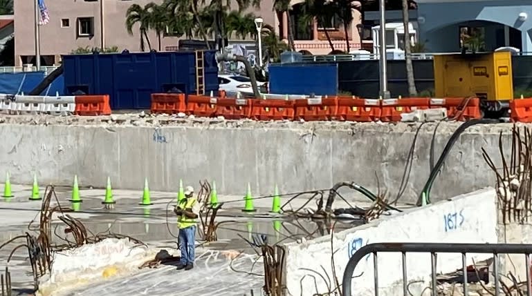

Here's a picture for you.
All of the water that they have been pumping out of the big hole needs to be treated before it can leave the site. That big yellow box in the upper right corner of the picture is a hydraulic pump. Two small hoses go from there to drive the big sump pump behind the dude that is standing there. The black pump discharge hose goes to the blue dumpster looking thing on the left. It filters out debris and skims all the oil, diesel, and other petroleum products and discharges the cleaned up water out of its hose on the left. At that point it may be clean enough to dump into the nearest sewer so the water treatment plant can deal with it or to a tanker truck to be hauled off for further treatment.
Nukeman948
Thank you for the picture and details on the filtering process, that was informative!

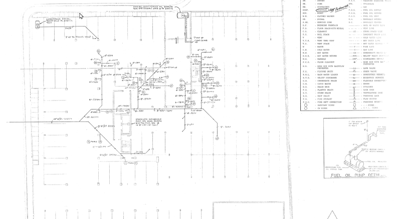

Supposedly it was a 1000 gallon tank, that's a lot of diesel fuel... but from the plans it should be under the foundation, under the ramp area - or somewhere with a manhole cover?
^^ This may be for the North Tower, the bottom right corner is too faded to tell. But I know I saw a similar layout for the South Tower.
All of these drawings are horrible.
Yes, the North tower shows it below the sidewalk at the ramp to the garage with a manhole access. Should be plenty of room here. Google earth shows that is a lie. No manhole.
None of the drawings even hint at an elevation. Under the slab makes maintenance or replacement very difficult if not impossible.
Morabito shows the South tower Diesel tank outside of the building just a bit West of the ramp. It might just sit on top of the slab here but that would be dumb. It is on the landscaping drawings so I doubt it is below the parking level slab, therefore it must be just below the parking level ceiling (or maybe on the floor?). This would be above a couple of parking spots but just eyeballing the drawings to get some "rough" dimensions I get about 6'x13' or maybe 5'x12'. To get 1000 gallons that would require a tank 29 inches or 38 inches deep. There is just not enough headroom for a tank above these parking spaces and park cars here too. So by deduction, the only answer left is... no idea. They just lost two parking spaces and the tank got squished in any likely location.
Anyway, the 500 gallon transformer tank is shown on the parking level in the unused corner (maybe?) but it could have been pumped out before the implosion if they thought that was needed.

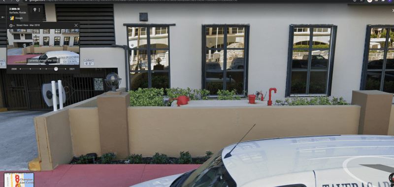

Installed in 1993, there was an above ground 1000gal diesel storage tank installed on a concrete slab, hidden away behind hedges. Original tank and fill port were left and not removed if I am not mistaken.
Edit: Thar she blows.
Demented
Good find! What a terrible location, right by the garage entrance. You can see the black pipe going up the wall and into the generator/pump room too.
There was a time early on that I hadn't realized there were actually parking spaces directly beneath the perimeter of the building...it could be safe to assume that this tank ended up in the garage and yeah most likely "smushed" and carted away with the debris.

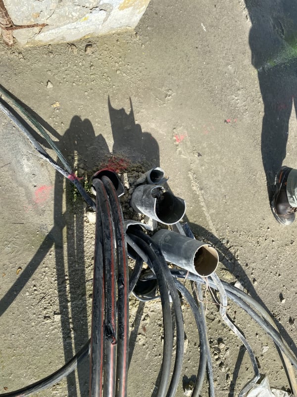

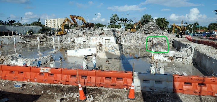

Y'all know I've been curious about the rooms directly above the ramp area...(and all combustible items not car related). My apologies for more crappy pics, hopefully you can make out what I'm pointing to. There was fire/burning there at the area directly beneath the generator room, this area is above the cars and the scorch marks are not climbing the wall, which would indicate they came from above or directly there.

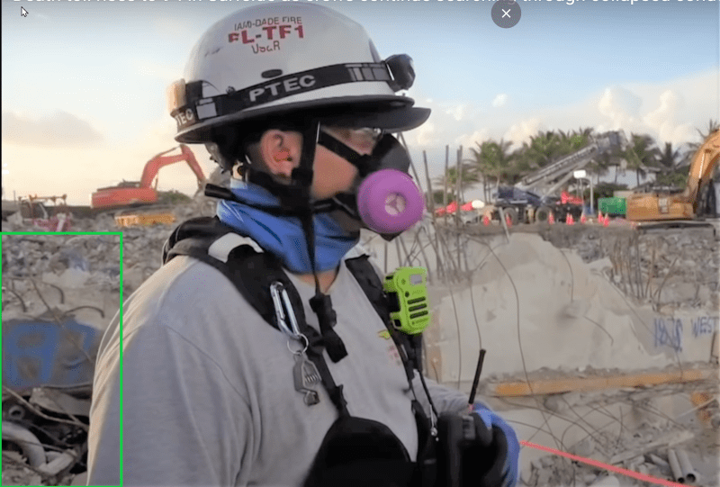

Could this snip be the other side of that wall, it is marked in blue and so it was taken to the NIST area. Also curious what that orange line is in front of him.
The drawings show a 25 gallon day tank for the generator so there was some fuel in there.
The electrical riser diagram shows the 60hp, 170 amp fire pump had a transfer switch to use either generator power or use a feed straight from the transformer. There was a circuit breaker set at 1000 amps next to the transfer switch but the wires that come from the transformer were only rated for 225 amps. The reasoning is that you want the fire pump to be able to run no matter how bad the fire gets. In this case the transformer was not within the initial collapse so it could have continued to feed power to that room. If damaged wires were shorted with only the impedance of the circuit to limit current until the wires melted or the primary fuses blew, you could get a little bit of scorching in there and maybe ignite a squished day tank.
Now the markings on the concrete you circled look like they could be electrical flash marks on the left side, but on the right side they look more like stains from a day tank that has been leaking fuel for years.
The wires w/red stripes are 26kv that fed the transformer, and one of the other sets of wires likely fed the transfer switch. One set to feed a house panel in that room too. I'm surprised these are PVC conduits and not encased in concrete. (on closer look there may have been some type of fire proofing over them)
It's in one of the Morabito documents somewhere, but a picture of the rusted day tank does exist.

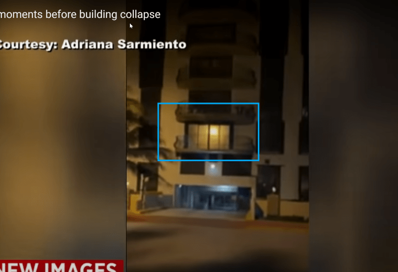

I was looking at this video again, the lights are on in that unit on the 2nd floor, that's Unit 202 right?
Unit 202 was supposedly empty. Actually 201, 202 and 203 were empty.
MaudSTL, do you have any further info on those units?

Optical98 - Is the gate open in that picture?
MaudSTL
Thank you, that does verify those units were supposed to be empty, however there are lights on in Unit 202 right before the collapse. I'm going to have to assume the MDPD is aware of this.

No, the gate is not open, that pic is the beginning of a tiktok video that was being made 7 minutes before the collapse.
Optical98 said:
...those units were supposed to be empty, however there are lights on in Unit 202 right before the collapse. I'm going to have to assume the MDPD is aware of this.
There could be a couple very innocent reasons for that light being on:
1. A real estate agent was showing that unit in the daytime and didn't realize a light got left on.
2. The client that was looking at the unit was named Tom Bodett.
C. A young, handsome Youtube videographer, with a gravely voice, desperate for a story to make himself rich and famous, decided to supplement his meager income by selling used Diesel fuel on the black market. With the help of an underpaid security guard, he broke into the condo above the generator room and began drilling through the floor, 22 hours before the collapse, directly above the day tank. Realizing he couldn't siphon up hill he decided to drill back down so he could siphon directly to his getaway car parked carelessly by column 37. Unfortunately, with a whirring drilling sound, he drilled into the top of the transfer switch hitting the unfused wires and causing him to jump back and hit his head on the shear wall with enough force to shake the building, knocking the tar kettle off the roof which then crashed through the pool deck. Using Youtube's algorithms to understand his mistake he tried to back the drill out but this caused a huge electrical explosion that reflected off the shear wall and focused its energy on the opposite side of the building starting the main collapse. The only way this evil doer could have escaped is to dress up as an elderly lady and be escorted out by Shamoka herself. I just hope that those mean "Youtube Pirates" give me all the credit I deserve for this "Exclusive" story.

Night work did happen often at CTS, There were 0 requests or notices for night work that night.
That rabbit hole is empty.
Unit 202 had just been purchased April 2020. I see no record of it being put back on the market
It's a really nice unit, however the kitchen needed a huge update.
Demented,
We both know there was often WWOP done there. Rabbit Hole open.
Nukeman,
Could be many explanations... but it should be looked into regardless as the site is a CRIME SCENE?
Update: The family lives in NJ, they own 202 and use it as a vacation home. They had actually vacationed in Surfside in April, there are pics on their IG of their little boy standing on that balcony and saying how lucky they were.
