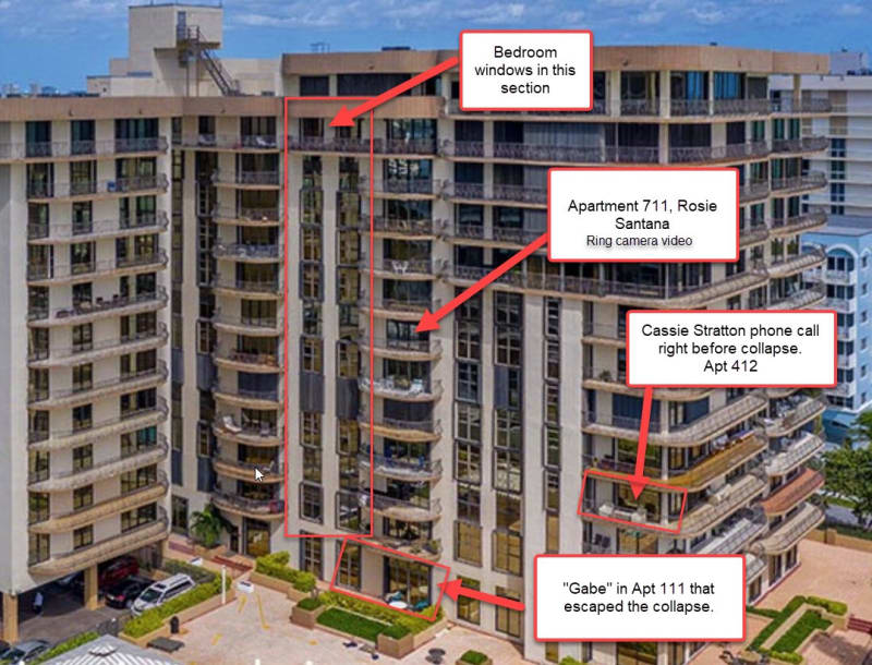

In this well-done article, as well as their earlier well-done expose of floor-by-floor victims, the Miami Herald attributed Gassie Stratton as having lived in Apartment 410. Note that an earlier posting from many threads ago had shown her living in Apartment 412, which is apparently in error. This is realy much of a mute point at this point in time, but in case there was other information noted in the database or elsewhere based on this information, just pointing out that it is incorrect. (Obviously in the early stages, much of the available information was preliminary and sometimes incorrect, so no blame to the original poster.)

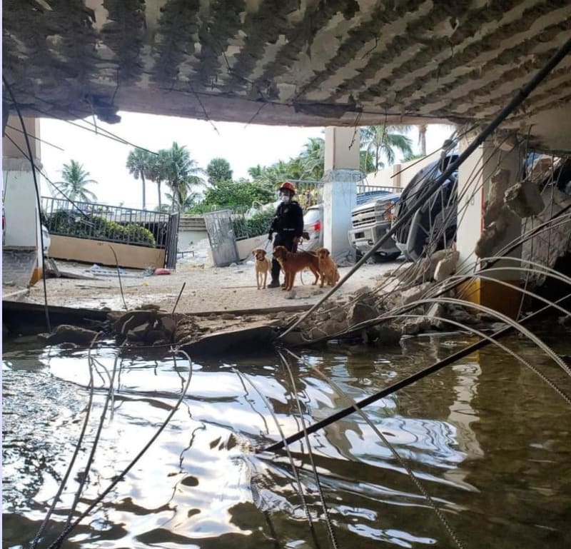

There was a photo posted in thread 2 of the area under the lobby. It definitely would have caused some shaking. I imagine this would have made a or tearing, grinding or skidding sound. Maybe 'whirling' is a translation issue or some pipes breaking. In her past statement she said it was a 'metallic boom.'
sgw1009 said:
…in case there was other information noted in the database or elsewhere…
Since it was originally published on July 27, 2021, Cassie Stratton has been shown in the CTS Collapse Witness Statement Timeline as being in 410.

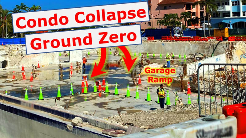

I just uploaded "Miami Condo Collapse EXCLUSIVE On-Site Photos Close Up Columns":
There are over 100 photos shot on the condo collapse site a few days ago, showing closeups of the pumps in the foundation pumping out water, and closeups of certain columns, the H-beam, and the vestibule in the garage.

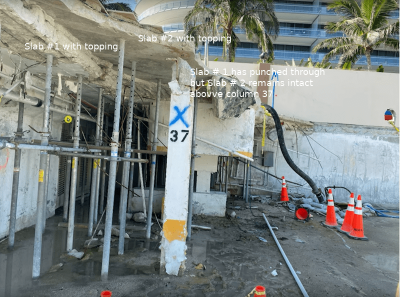

From 7:43 of Jeff's video, I see a problem. The original slab and topping were buried under a second slab, topping, and pavers.
All bets are off. The evidence is clear.
