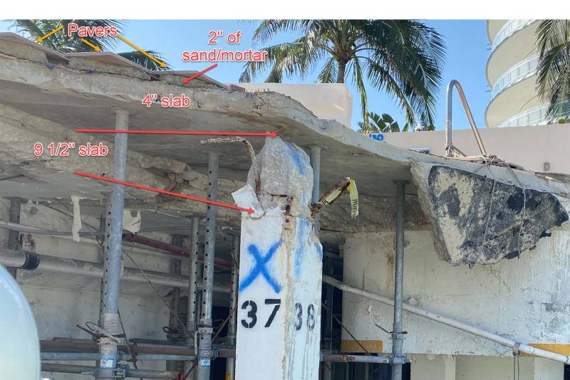

The original slab and topping were buried under a second slab, topping, and pavers.
I noticed that too but the pool and Jacuzzi are different on the prints I have and there may be differences in the slabs here. Your slab #1 may be the structural slab and #2 may be the topping slab with waterproofing, sand and tiles on top. You are right that only part of the slabs punched through column 37.

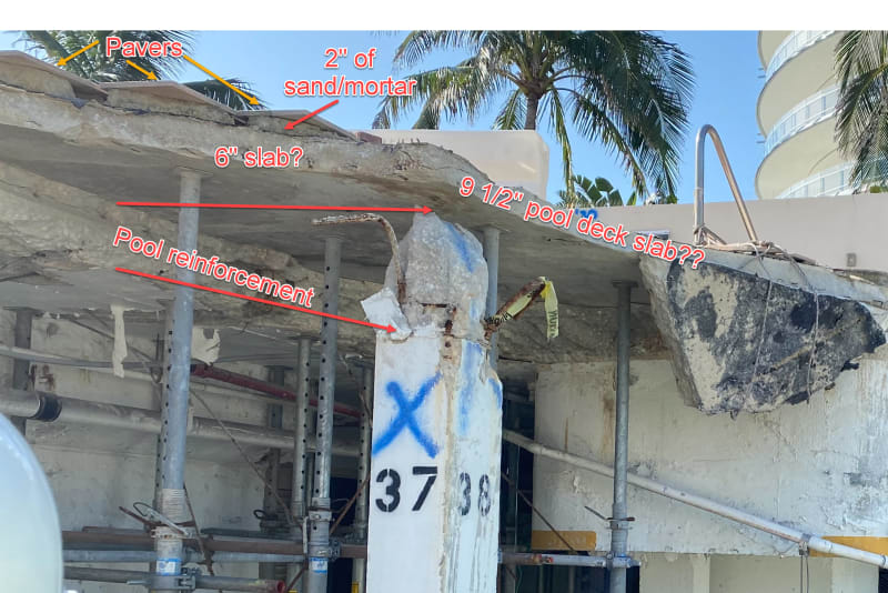

Guys here is a closer zoom-in I made, so it looks like we have our 9 1/2" slab, but then looks like we have about 4" of additional slab on top, and then about 2" of sand/mortar bed, then 1 1/4" thick pavers. Should be concerned about his 4" slab? This is the first time we have seen this as it is not in the plans.
No, I think I was looking at the thick reinforcement concrete for the pool corbel in that previous picture. This newer mockup here shows the pool deck. But the pool deck only looks to be 6", not 9 1/2". I forget which page on the floorplan shows pool slab thickness, but I thought it is supposed to be more than 6".
Perhaps the garage video has some insight on this? If the upper slab is the deck slab as we've been led to believe, and the lower slab is pool zone reinforcement, there would have to be a step in the underside.
It seems odd that the column slab reinforcement did not tie into the upper deck slab, if that's what it is.
I've just thrown this out there without any research but it seems odd. Maybe there is an explaination.
Thanks all.
Yes, it looks to me like they did not pour all the concrete at once. Instead, it appears there is a cold joint where that thicker reinforcement part of the concrete on the left of the photo lines up underneath to the pool deck, which we still don't have a confirmation on the thickness, but you can see a definite line between the two which says to me they did this in 2 separate time spaced pours. Not sure if that is a problem or not. there may also be another set of "as-built" plans by the contractor to tell the framing plan for this extra thick concrete that we don't see in any of the drawings.

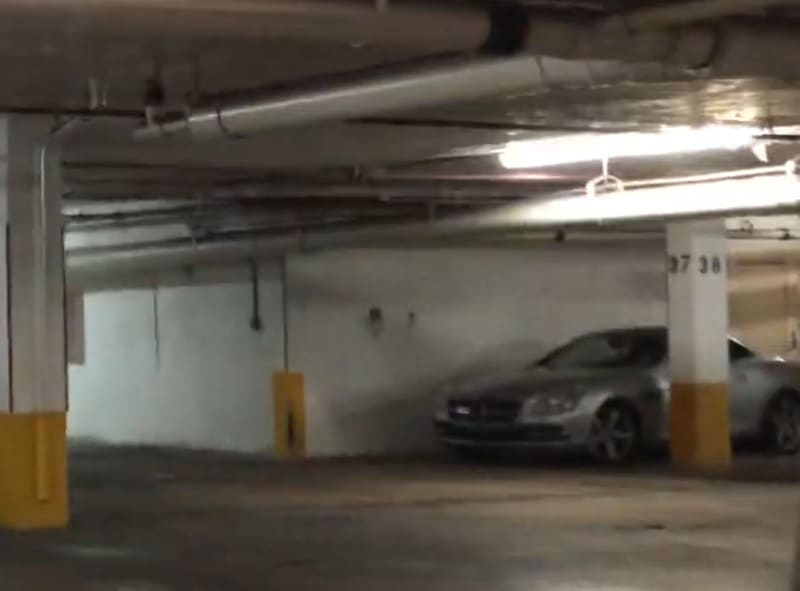

I made a screenshot of the garage video of space #37. A nice car parked there. Can't tell anything through all the pipes
The columns in the garage are 12"x12". That can be used as a reference to help determine the other dimensions.
Morabito only shows the 9.5 inch slab and pavers with no topping here: (page 24 of preliminary-review-plans-for-40-year-re-certification). So it seems they failed to do enough research on the existing structure. Of course we don't have any details of how this area was originally built or designed either and the topping may have been thinned in places to provide slope for drainage for the pool.
This could explain why they wanted confirmation of slab thickness at the pavilion location and why they failed to understand the importance of drop panels in more locations than their preliminary plans show.
They may have some serious liability unless they can claim all this was outside their work scope or more revisions were coming.

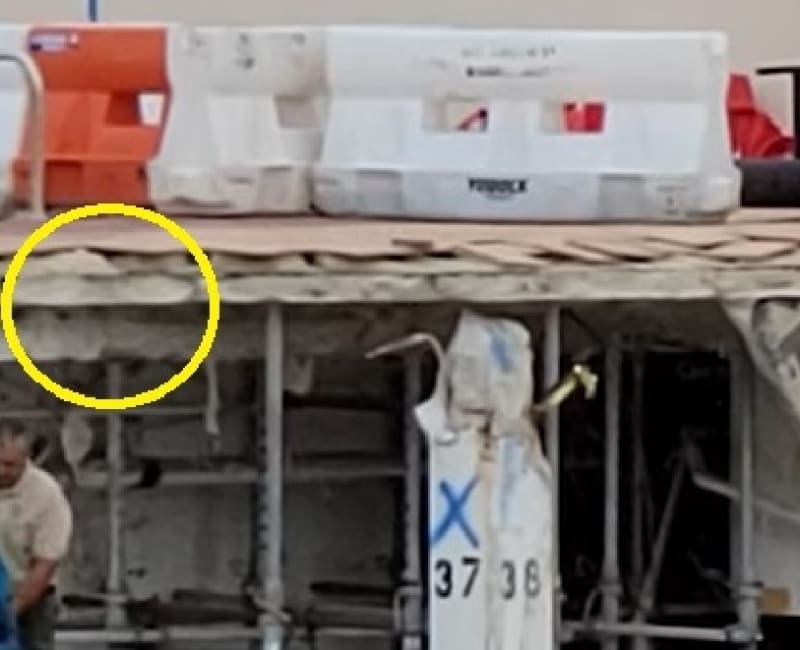

From 9:30 in Jeff's video above, if the column is 12 inches square, then the top slab appears to be about 6 inches thick, with the sand layer above it about 2 inches thick. This is also using Jeff's earlier post ("Guys here is a closer zoom-in I made...") to judge that the top slab is about 6 inches thick. Towards the left of the shot, the two slabs are shown close together, and the lower slab also appears to be about 6 inches thick, with the layer above it also about 2 inches thick. This would make the total thickness about 16 inches thick, not counting the tiles.
Edit: Perhaps the line part way up the bottom layer is not a new layer, but just where the rebar was. So perhaps the bottom layer is all one layer, about 8 or so inches thick.

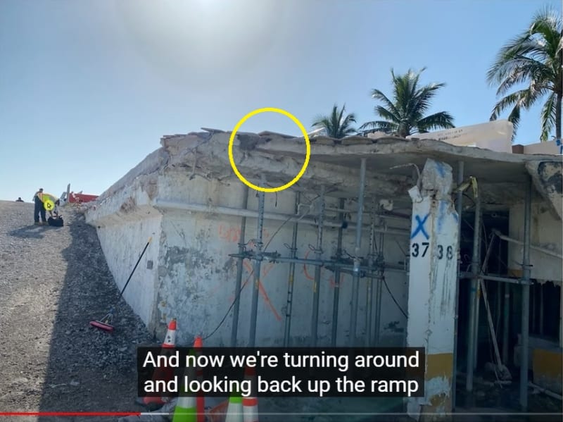

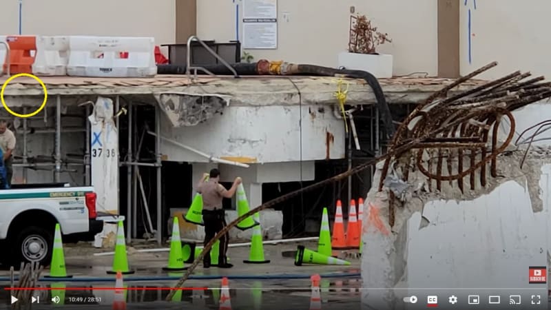

Here is another long shot cross section of the pool deck near spot 37. It gives a little better view of the comparative thicknesses of the deck layers. This is from Jeff's video at 10:49.

Here is a closeup of the image I posted earlier. It is zoomed in to the corner that shows a good view from afar of the layers of slab. And a reference for comparison, the Yodack traffic barriers right above that area are 32" tall and 6 feet long.
