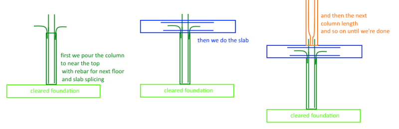

I'm still interested in the unusual shape of the punching shear breaks and if I get around to it I will make a longer post with some (non professional, suck it Florida engineering board) opinions. Related to that, I think someone posted a document early saying how the pouring of the columns and the slab above worked. I'm interested as to whether the column was built first and the slab then poured around it (so there's a vertical joint around the column) or if column + slab above was all done at once.
The board takes this very seriously, but they are strangely quiet... same for California, it seems.
Normal practice is to pour the Column first, stopping the pour an inch or so below the deck form. The column will shrink a little as the slab is prepared over the next few days.
If you pour the slab and column at the same time, you risk a crack at the top of the column when column shrinking occurs and downward movement of the slab is restrained by the shores.
Shear calculations consider the column support size and shape as well as the deck thickness and the cold joint does not play into it.

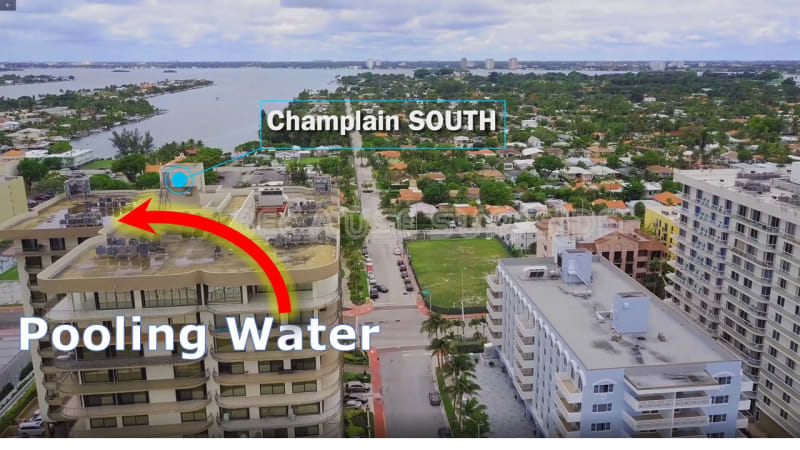

I uploaded my latest video last night which talks about how much water we've noticed pooling on the roof of both Champlain Towers South and North buildings a year ago shown on drone flyovers on dry days.
The slab is then a complete, unbroken surface, right? There is no column of concrete going 'through' the slab (though there is rebar doing that if there will be another column above the slab - not true on the pool deck in this case)? That's my understanding from previous posts as well.

The one thing I've always wondered about when they're pouring concrete for the columns if they stop at the end of their pour and I don't know how long they wait maybe a day or two? What do they do about cold joints forming? Are they required to use any kind of primer in between or bonding agent or anything like that? That's what I've always worried about is how do you continue that column all the way up as one homogeneous material?
Red corona
Your understanding is correct.
Jeff
No primer or bonding agent.Does act monolithic due to steel passing through joint.
There are cold joints for sure; typically the term 'construction joint' is used, as they are planned. 'Cold joint' implies a joint between pours that should be monolithic and only exists because someone screwed up.
All construction joints will have steel passing across them and will usually be chipped or roughened for mechanical engagement between poured sections.
