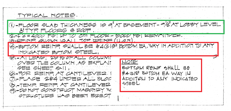

Their model "Slab self-weight of 150 pounds per cubic foot (pcf). (Assumes 9.5” slab everywhere, as detailed in 1980 structural drawings.)"
Wasn't it determined that was only up to the 8th floor, the slab thickness?
Does their model even go that high? I didn't get the best of read on it, but to me it read as though they've only modeled specific locations to run simulations on, or only up to the lobby level. Seems to me they've gotten impatient and just decided to go with one set of drawings and ignore as builts. I don't know, doing knowingly wrong simulations doesn't sit right with me.
Per 1980 plans, Basement is 9", Lobby is 9.5", 2nd to roof 8".
Edit:
2nd not boxed in red is taken from an adjacent page of the same 1980 revision plans.
