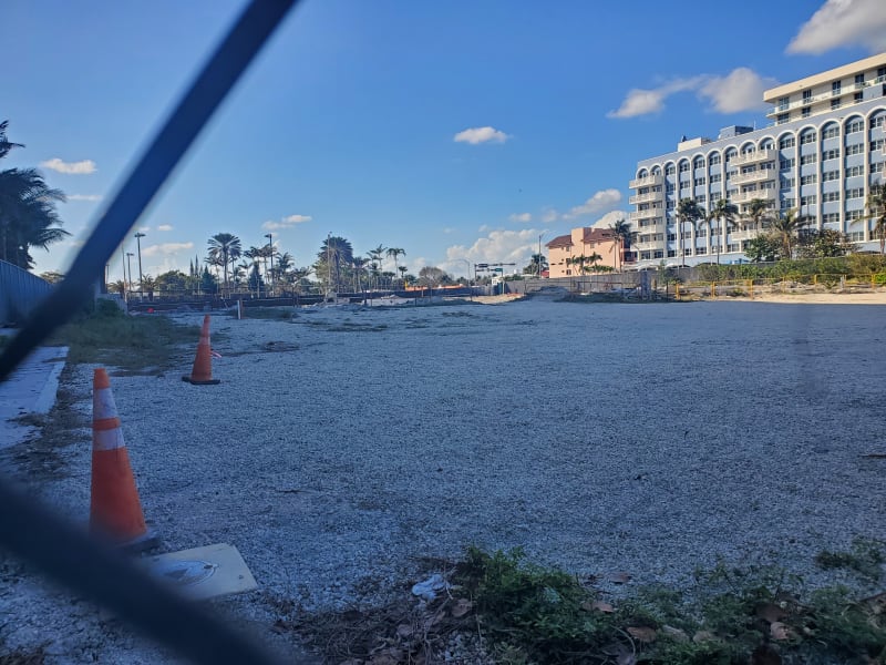

I happened to be in Miami this past week. We walked on the beach path and swam in the Atlantic. This is the Champlain Towers site, 28 Jan 2024.
