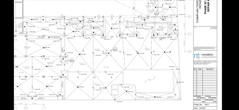

I see on sheet 96 of 336 (the mixed up plan sets) shows three area drains (referred to as “DD”, Deck Drains?) are indicated in the sloped area surrounding the pool. And the pool is a simple rectangle, no stairs shown. But on later sheets the drains don’t show. The 2018 report indicates that the lack of slope (and drains?) was instrumental in the damage to the deck. However, the 89 sheet set of proposed drawings, Phase IIC, done buy, in part, the same firm that bears name of the engineer that did the 2918 report does not seem to rectify the “flatness” of the area around the pool.
Where are Phase IA, XX, XXX etc plans? Where are the Phase IIA Plans.

Stevewag, sheet S2C-1.1 shows the overlay to correct deck drainage.

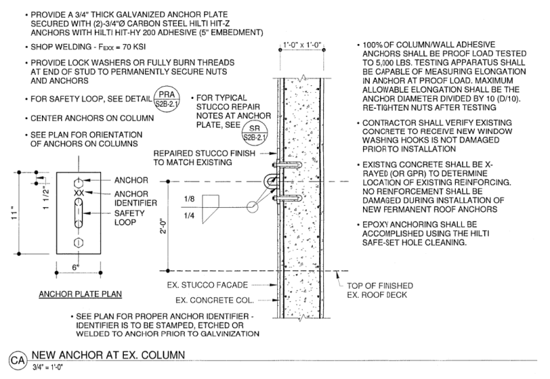

The inspector was on the roof inspecting the replacement of roof anchors.
"Jim McGuinness, who made the comment during a Town of Surfside emergency meeting, said he was on the roof to inspect work of replacing roof anchors, which are where window cleaners attach their equipment."
Modern roof anchors are tied to the structure of the building due to the 5,000# OSHA requirement. As far as I understand, there is not a way possible to meet this requirement without tying back to the building structure. The 2018 report noted to install anchors prior to commencing work, this report was flawed, the structure needed to be strong enough to add the anchors prior to adding them. Now, looking at the roof anchor permit drawings, they seem to indicate jackhammering directly into the tops of these overloaded & distressed columns from the roof (see comments above.) This was apparently happening within 14 hours of collapse. Do we know which columns were worked on? If the building was cracking for days why didn't the inspector know.
Finally, the firm that did the structural review of the building also did the structural drawings for this work, I personally think this is a conflict of interest. For example on every project I am a part of I instruct the owner to use a separate surveyor and civil, the surveyor catches a civil error every time (seriously.) They all have the young guys drawing and the older guys are hustling work barely checking. It's simple and important stuff. While we are much more precise than the hand-drawn days, CAD isn't perfect, it's only as perfect as the operator. I can recall the many times I have caught a consultant missing the thickness of a double-sided plywood shearwall. I'm thankful the framers are using Revit now and building a model themselves.
The roof anchor drawings you reference show this detail for the "column anchors':
Two x 7/8" dia percussion drill holes @ 5" deep is not very destructive. Probably drilled with a 30lb electric percussion drill. Also, it is the ROOF LEVEL - highly unlikely the upper level columns were "overloaded and distressed".
I may have an different opinion if they were drilling a lot of holes in BASEMENT columns if there was significant visible distress, but they were not.
Other than indicating the condition of the structure, or giving you an opportunity to do remedial work, I think the roof anchors are a bit of a 'red herring'... I cannot imagine that the addition of some 5K anchors would have any overall impact on the integrity of the structure. If that sort of load is going to cause problems, then you have a more serious problem at hand. If this had any impact on the collapse, then it was just a matter of time.
