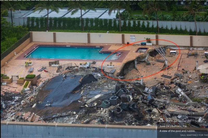

What's interesting about that photo is at it shows the deck dropped straight down instead of pulling away like has been discussed in some of the potential sequences. If it dropped straight down it probably means that it's not a contributing factor to the actual collapse rather it's just a result of the collapse.
The phonecall would indicate otherwise.
It dropped minutes before the building went down, it was a contributing factor
Even a perfect vertical drop is likely to do a little damage to the column as the joint detaches. It's not difficult to see a mostly vertical drop giving the columns a little kick or pull at some point between detaching and landing on the slab below. The doubled vertical span has much less safe capacity, and probably has a bit of fracturing at the mid point. There's a fairly big chunk of energy moving around as that slab fails and falls, regardless of the precise way it falls. The column can't just let go of the slab, there's forces and release of both tension and compression as it happens.
If the structural system as a whole was a bit too close to limits, a little extra damage could be all that's needed for the next step in the progressive failure.
Combined with multiple witnesses reporting the pool deck failing first, it's likely more on the contributing than result side of the collapse.

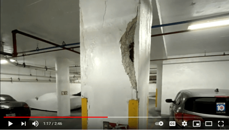

Just incredible that people were walking by this on their way to their bedroom without any concern or alarm...
I'd be checking on the ground beneath it to see if there is any debris. That alone would certainly get my attention.

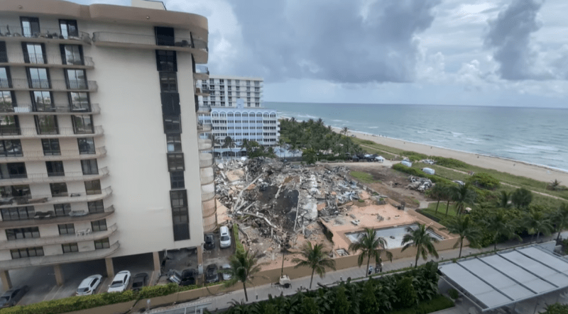

Is this part of the structure that is still standing? or another separate building nearby?
